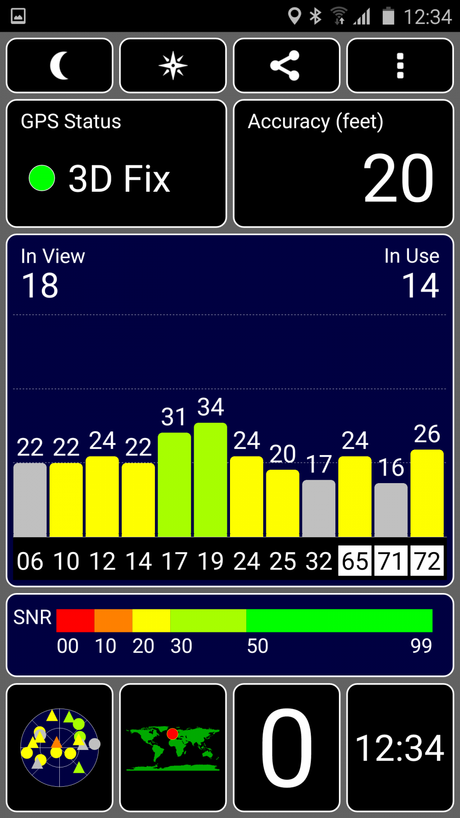

I have noticed slight signal reduction  if device  was mounted directly on windscreen. But at my location did not have any problem with caching GPS signal on my old tomtom or Samsung phone. It took few seconds after enabling devices. I also still had  2 bars 4G on my phone. Normally have 3 bars  at this location.
When phone was in my hand or box i did not noticed any signal signal reduction comparing to signal without covering a aluminium foil.
I have no idea how accurate is comparing aluminium foil to heated windscreen  but hope that in my superb the signal will be not worst like in tested insignia.

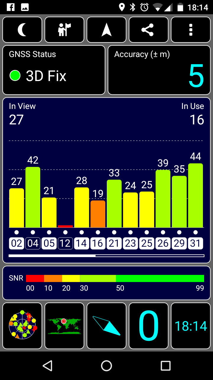

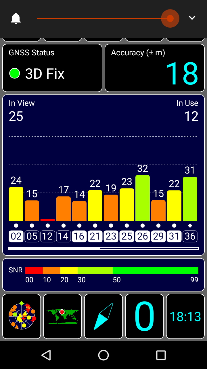

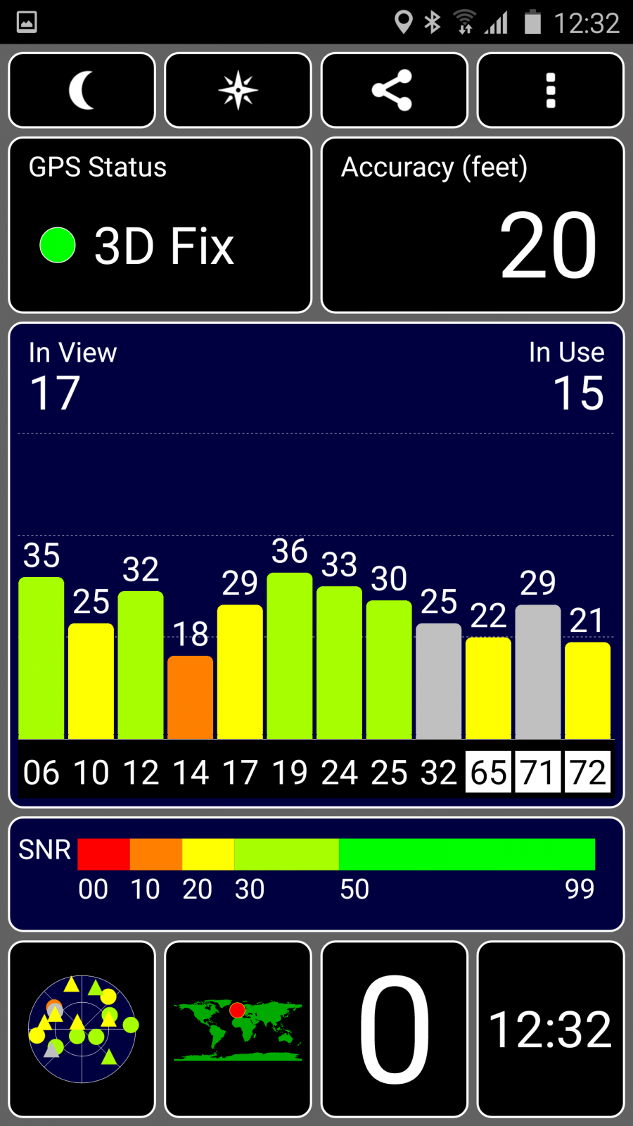

The first image is outside the car and the second is inside. So there is some drop in signal but still says it is locked. To be fair the inbuilt sat back looks fine so do not see much need for GPS on phone.
there is my conclusion:
only one type of windscreen got that signal suppresing "feature" -
heated + camera which is paid option
all others, including heated without camera, don't have any problems with receive GPS signal

in black dotted area reception is perfect also under heated+camera version of windscreen

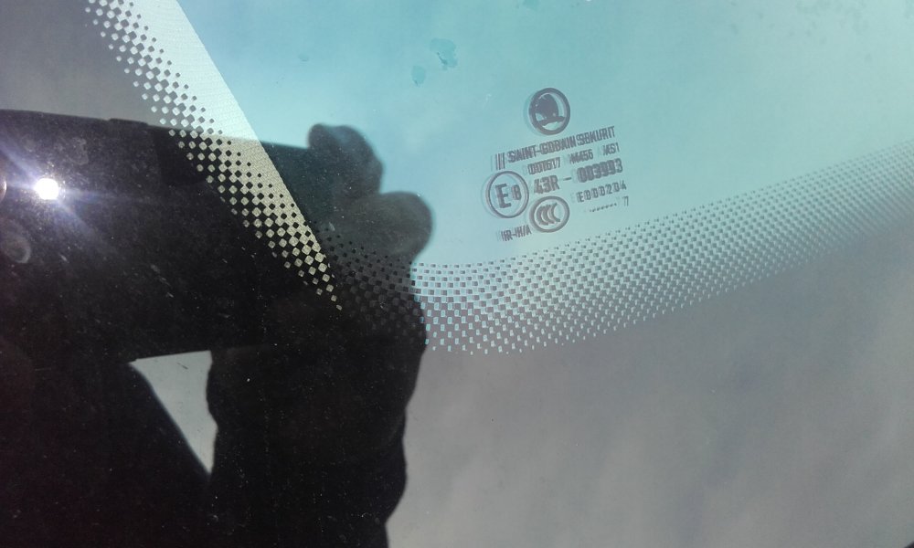

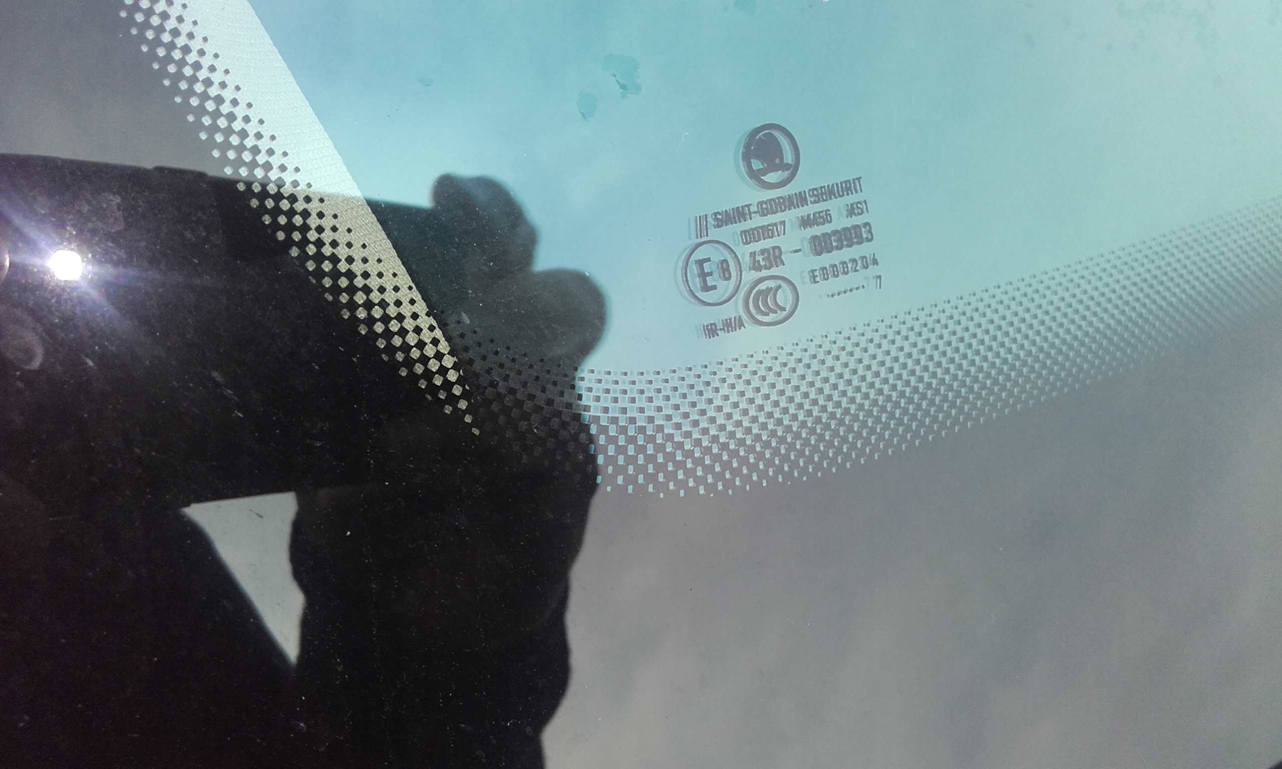

Screen is heated (film not wires)
I do not have the sign recognition camera
The dashcam is mounted on the dotted area (which means it does fall off occasionally) but has good reception.
Will see if there is a visible number on the screen itself.
Makers details right hand side of screen as you look out
Skoda logo
//SAINT-GOBAIN SEKURIT
E8 (in a big circle) followed by DOT617 M456 AS1
43R-003993
IR/NA CCC(in a big oval) followed by E000204
...... 7
Can't upload picture on this computer.
Can from phone.
Edited by IJWS15

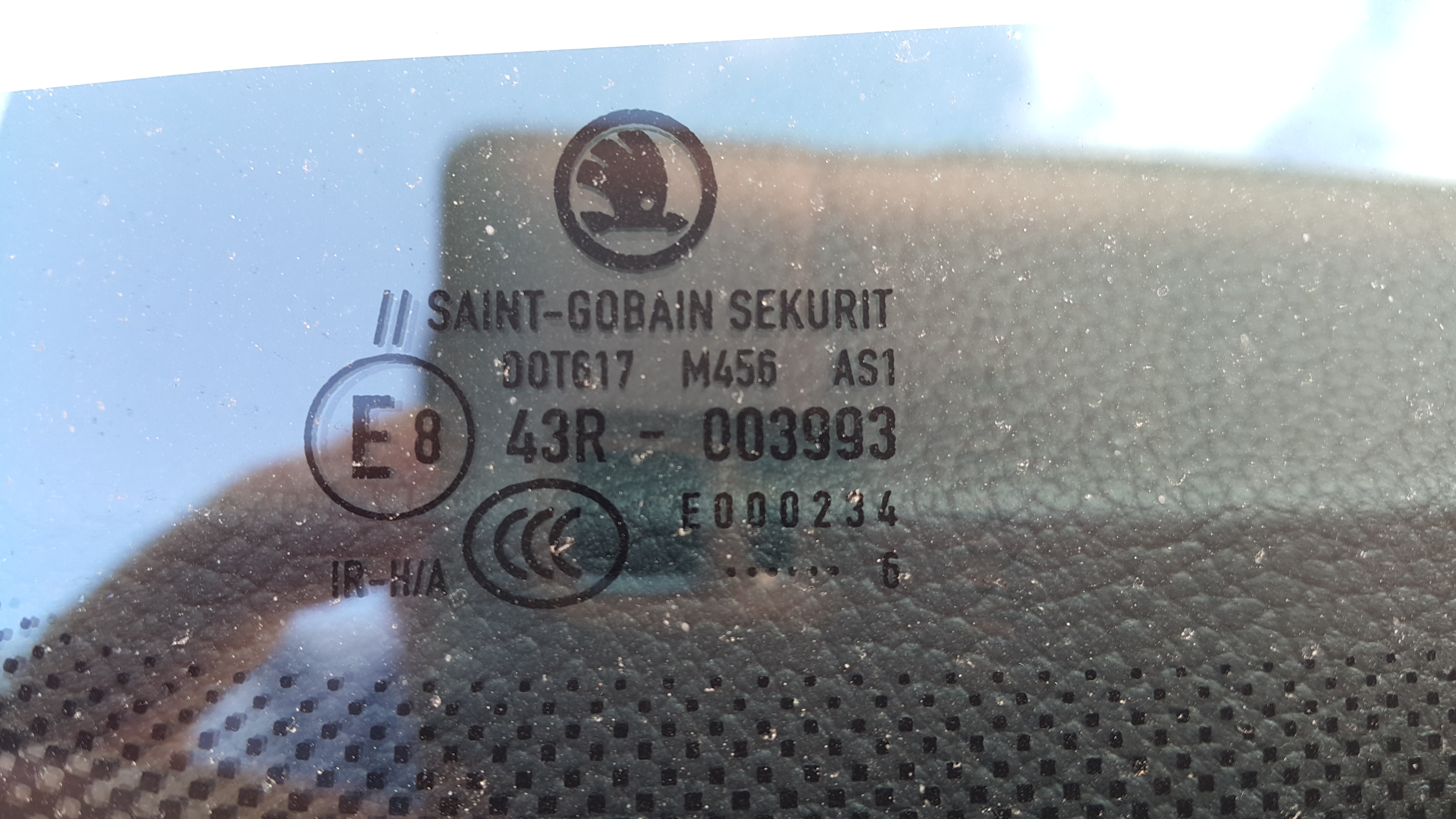

my problematic windscreen - heated(film not wires) + assistant's camera window + heat reflective coat:
Skoda logo
43R-003993
IR/NA CCC(in a big oval) followed by E000234
...... 6
Skoda logo
43R-003993
...... 7
Can from phone.
What doesn't make sense is the date would read as June 17 but the car was delivered in April 17 (07 can't be right)
Has not had the screen changed - unless something happened at Service that skoda have not told me about.
Skoda logo
43R-003993
...... 6
Looking at mine again it is probably a "3" and the dots and number appear to be the date of manufacture so we have the same screen, unless there are other numbers somewhere on it.
