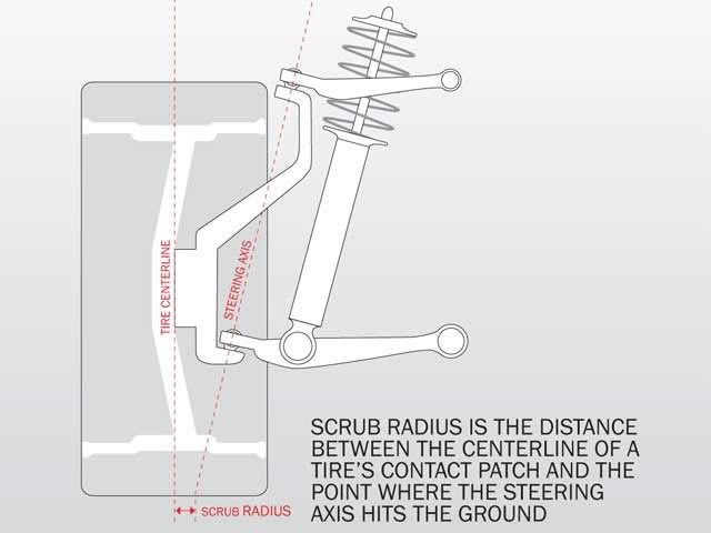

There is also something called scrub radius in the geometry. This will be affected by the offset of the wheels. I don't know how much technical info to write, it may be too "nerdy".
But, as always small changes may be good, big deviations can be over the top. If you mess around on your own with odd offsets you may end up with zero scrub radius, called "center point steering". Then you may experience little road feel or feedback and directional stability. Not to mention what behaviour to expect if you press to the limits, in emergency situations, high speed driving over humps when cornering, etc.

But, as always small changes may be good, big deviations can be over the top. If you mess around on your own with odd offsets you may end up with zero scrub radius, called "center point steering". Then you may experience little road feel or feedback and directional INstability. Not to mention what behaviour to expect if you press to the limits, in emergency situations, high speed driving over humps when cornering, etc.
I agree that all of the above is worth considering when straying from the factory settings.  I'm still considering what to do at the moment but I'll have a read up on scrub radius as I've never encountered the phrase before.
