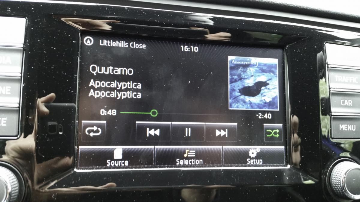

The tracks I have are a mixture of formats, mainly: .wav .mp3 and .wma. Prior to sorting the album art all tracks displayed in the correct way:
[Title]
[Artist]
[Album]
Like so:

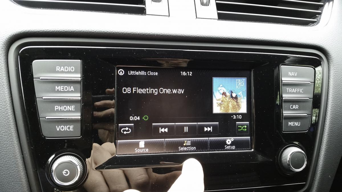

Since doing the art, all .wav files are just displaying the filename:
I have tried going back and retagging the album info, doing each track individually, entering the info manually... nothing has working and i'm stuck. Like I say prior to messing around with them they were fine
All other formats are displaying the track info correctly (as per the first pic), it's just the wav files that are affected..
