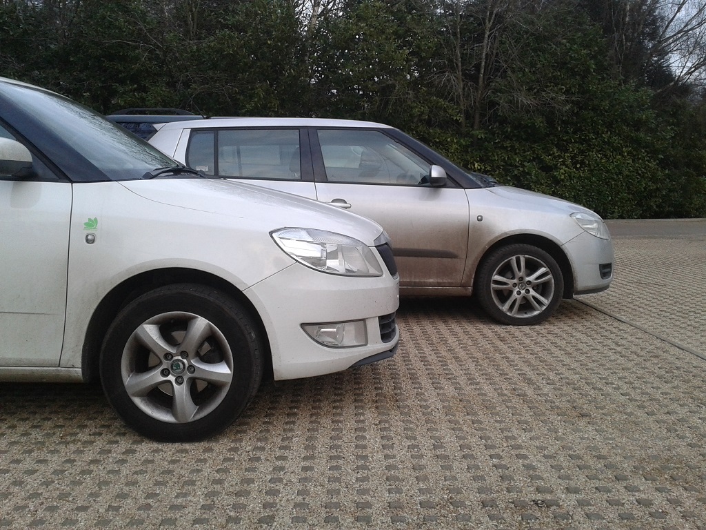

The headlights are different - I think the wings are the same. See my pic - the silver Fabia is a pre-fl, mine is the white '12 plate facelift mode. Shows the side profile of the wing, and the corner of the headlights.

Thanks for that.
