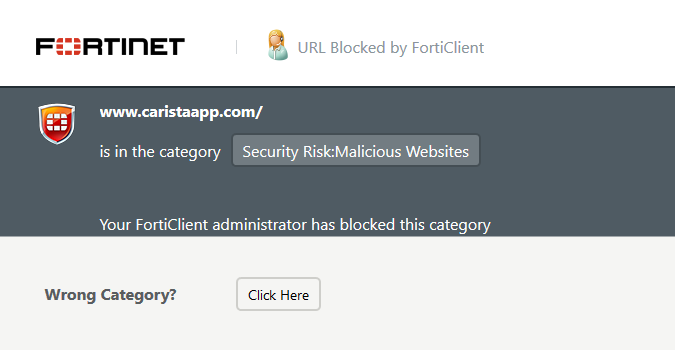

Its blocked for me as a "Malicious Website"

I used Carista on iOS via a Bluetooth OBD2 dongle and it worked ok, on a 20-3 fabia. I used the paid version and changed a few settings. It's not a 'malicious' site to my knowledge, I had no problems. Pop over to the Fabia ll forum, plenty of info there
