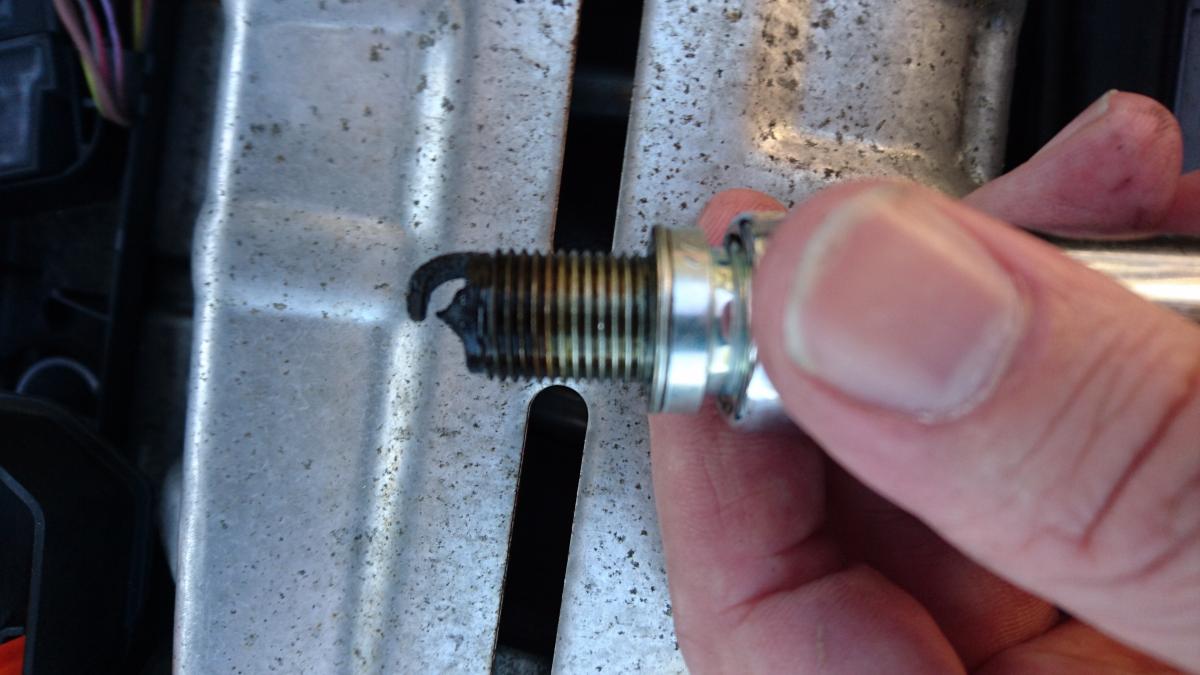

Went to the cinema, car running fine. Came out of the cinema, car runs really rough and chugs. Gets home, pulls plugs out the following day... I think it's game over!
Game over for that plug.
How long have they been in?
Fit 4 new DENSO Spark Plugs, and 'Continue Game'.
Plug has been in about 2 months at the most. It's absolutely caked in wet oil, looks like i have big problems! Had a compression test done this morning and cylinder 2 (looking from the front of the car into the engine bay) is way down from the rest. It's smoking that much, it'd be a great James Bond car! Looks like a rebuild is on the cards :(

I've had a compression test done this morning and cylinder 2 is waaaay down compared to the rest. I've been told it's likely that the piston has cracked. :(
I'm surprised how quickly it happened. Was fine when I parked it up and a couple of hours later, it's dying a death!
More likely the rings gone, then possible the valves are burnt out, actually it can be anything so yes a strip down will tell,
and a camera in the spark plug hole would be quick and give an idea for much less expence.
Maybe still need the head off, but worth a scope in the cylinder.
Yup I had a plug like that after about 6 weeks, mind it did have a dodgy coil on that cylinder so I'm not sure if that helped, but the fact mine was also using oil, and SUK were not interested meant I got shot!, lost a load of cash, but learnt a lesson and touchwood happy with the new car
