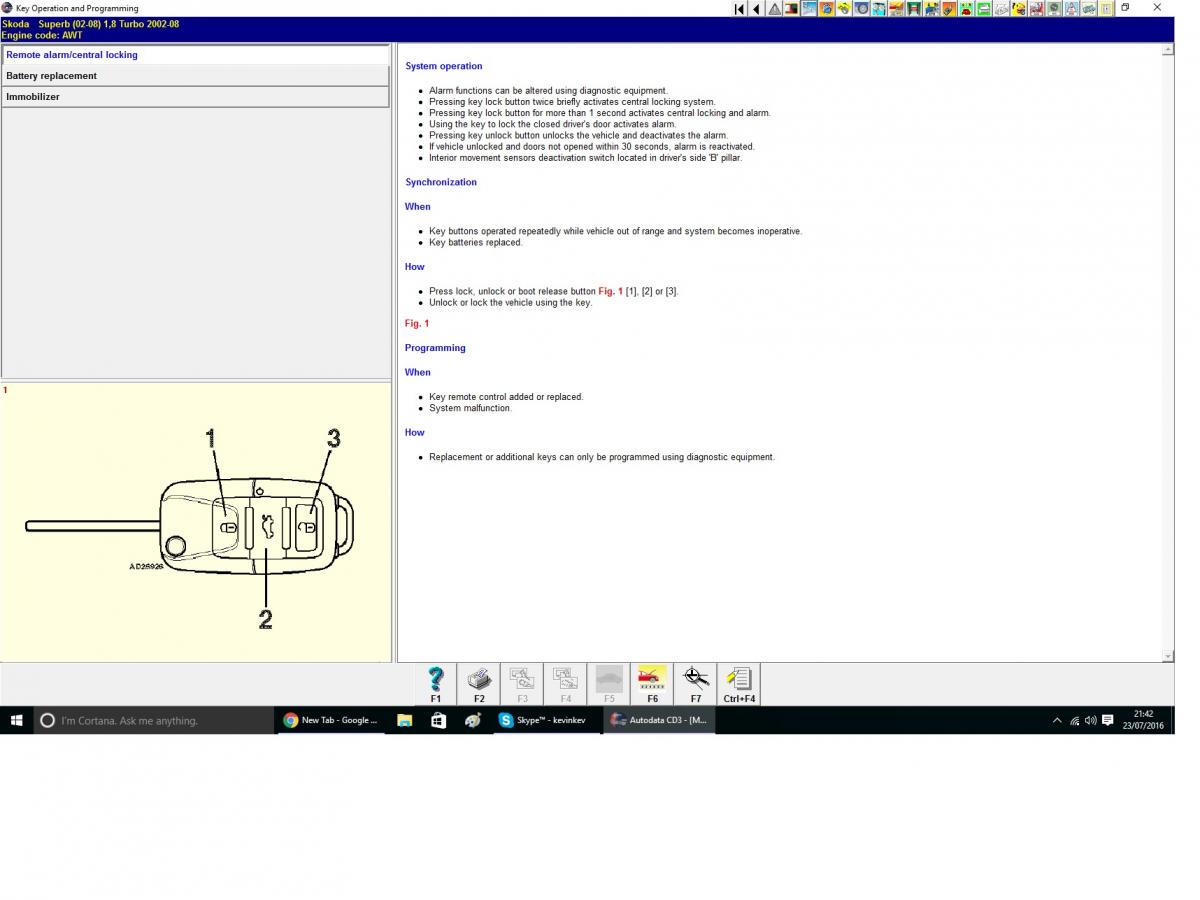

Program with VCDS.
or try this:
or try this:
Which is going to be tricky when he doesn't have a door lock to put a key in.
Not even in the boot ?
Hi guys, thank you for the replies. I have found and door lock under the cover just by the handle. So I have tried to put working key into ignition and the other key into the door. And then tried to lock and unlock. Doesn't work.
Needs looking at with VCDS then.
