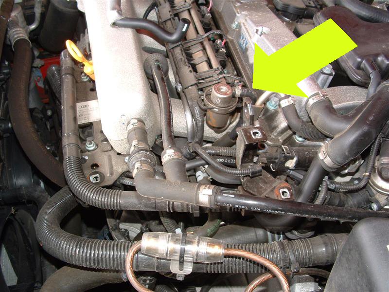

Hi guys after installing a boost gauge and getting fed up with boost pressure issues ive decided to take it out and replace the fuel pressure regulator pipe I cut to insert the T-piece, does anyone know or have a link to the actual pipe I need or some pipe I could use instead, thanks. (found this picture on another post which labels the pipe I need)
Nothing special needed here, but not thin walled silicone tubing. This pipe goes from the regulator to the dump valve if I recall correctly.
For mine is used some 4mm ID fuel line hose from Halfords which does the job just fine.
actualy it goes  straight to the intake manifold from the fpr
 i just replaced mine just a normal fuel line hose that is 4mm inside that can take some heat i belive mine is good for about 90 degrees celsius
best regards
Yes you're right, when I looked again, DV line goes to manifold as does FPR. Both inlets sit next to each other at the end of the manifold.
