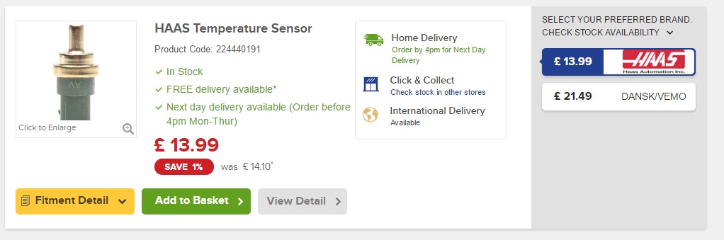

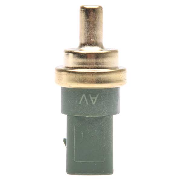

Is this the part I need ?
yes,
just make sure to mach code with your engine,
i believe there are two kind of this sensors (with 3 pin and 4 pin)
