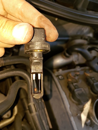

and then i saw the air temperature sensor on the intake manifold right next to the throttlebody and remembered that i read somewhere about someone cleaning that one to
so i decided to give it a go and when i had taken it out from the intake manifold  i saw that it had a thin but hard layer of  burned oil on the metal strings so i sprayed it with break cleaner spray and tried to scrape the oil off wit my nails
but that didnt work so good so i took a scissor i had in the car and scraped all the brown burnt oil off so that it got its metal color back again
after cleaning it the car runs perfect no hesitations no stutters  no misfiring no jumpy idling its like a a diffrent car now
if i started on low rpms before cleaning it the car felt like it was power less and almost died
now i can  pull off at idle
here is a pic on the air temperature sensor after i cleaned it
