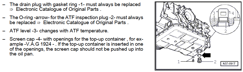

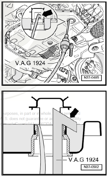

If you're going to work on these cars at this level, do yourself a big favour and spend 7euros or so on an hour's access to Skoda ERWIN.  In that time you can download all the factory service and repair manuals for your car.
https://erwin.skoda-auto.cz/
You'll get useful things like this... :)
There is lots of very useful info, such as all the tightening torques, etc...
