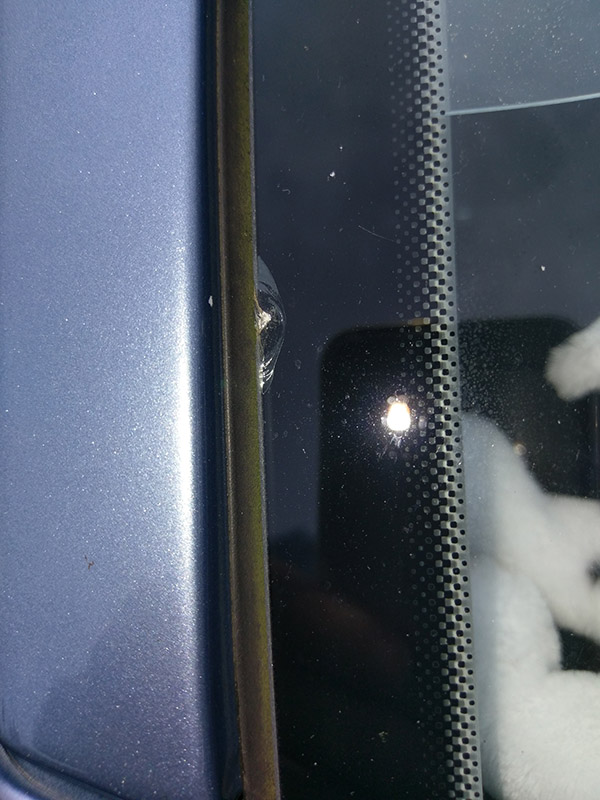

Is this windscreen chip serious?
Can anyone comment on whether this is likely to lead to more problems with the windscreen? It's on the outside of the windscreen seal by the passenger door pillar, maybe 1.5 cm long.

Looks fine to me, well outside of the swept area so not MOT issues either.
If it turns into a crack then that is the time to replace it, until then leave it would be my advice.

Not a problem unless it turns into a crack, which looking at that is unlikely. It's nowhere near the MOT fail area and not even in an area you can see from in the car so no problems that way. As for the post above there is no way that is repairable either as it's right on the edge and to repair them they have to get that sucky thing on and obviously you can't so it would be a new screen. Just leave it.

It'd be a new screen if it did spread anyway. So might aswel see what happens then i guess!
