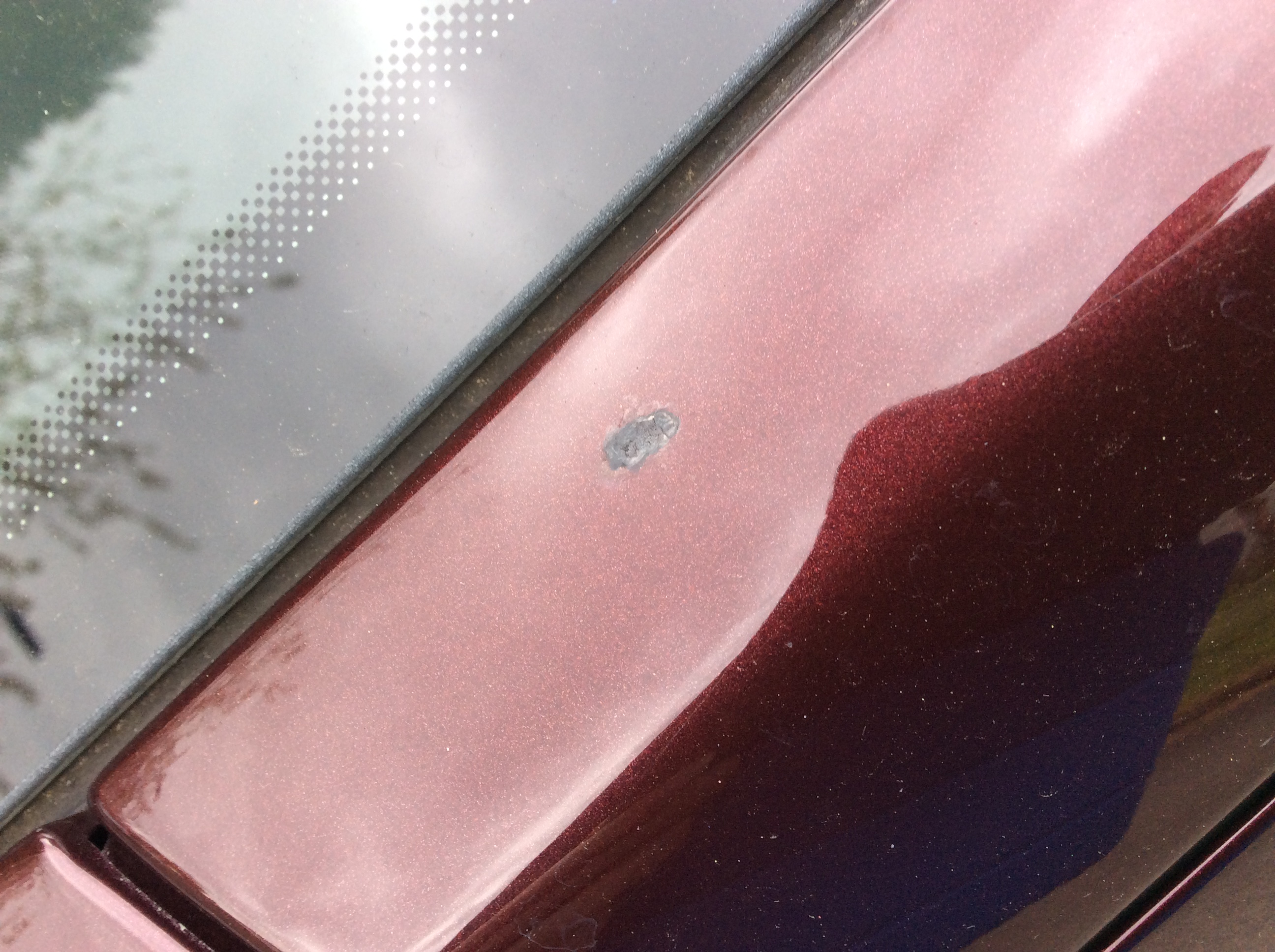

I've got a small road chip on the pillar between the windscreen and the driver door. Chip is about 3mm to 4mm in diameter and I'd say no more than 2mm deep. But there is rust in the chip.
How should I treat it? Main concern is to stop the rust spreading.

Attached is a picture of the worst offender post application of Kurust.
Google fibreglass rust brush. I would not use a chemical on such a small spot as it's likely to creep under the remaining paint.

I did actually use one of those, and whilst it took away a lot of the rust, it couldn't get it all.
I applied a very thin layer of the Kurust, so hopefully it hasn't been too bad for the paint.
grey primer, 800 grade paper over primer. more primer if required to get flat, 800 grade again extending onto existing paint. 1500 grade paper out over the existing top coat (clear coat). paint colour coat. apply clear coat (lacquer). Always follow drying times specified. Leave for a few weeks for clear coat to harden. Polish to blend into existing clear coat.
