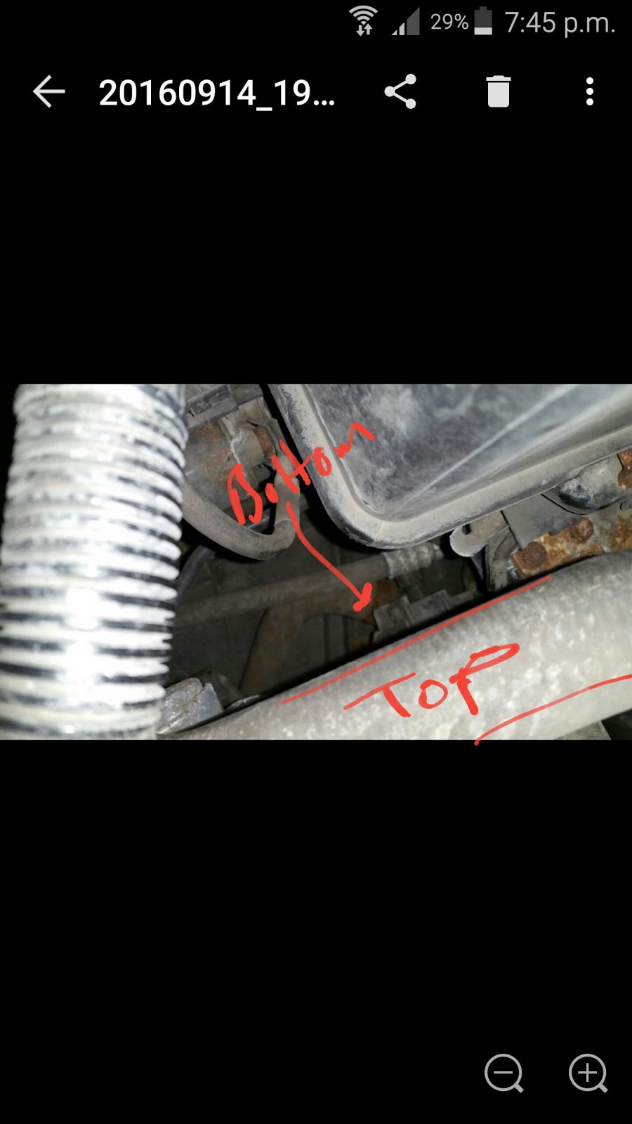

Just had a feel of what I think is the bottom rad hose and it felt cold top one was still warm for running earlier on.
I take these 2 are the rad hoses
Above
I'm thinking it's time for a thermostat replacement tbh
It does look like that is the case if your not getting flow through the radiator. A good place to start anyway   :D
