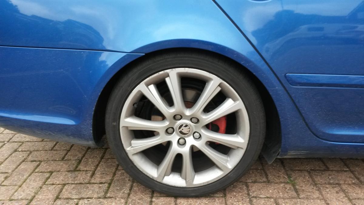

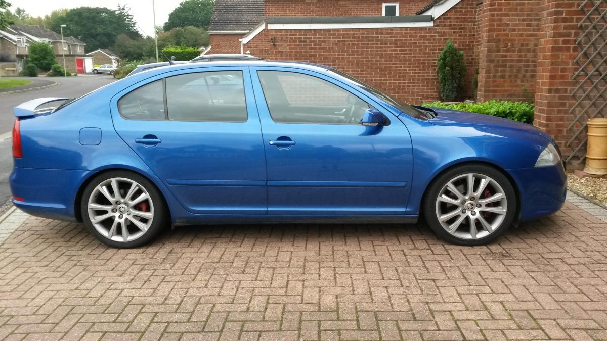

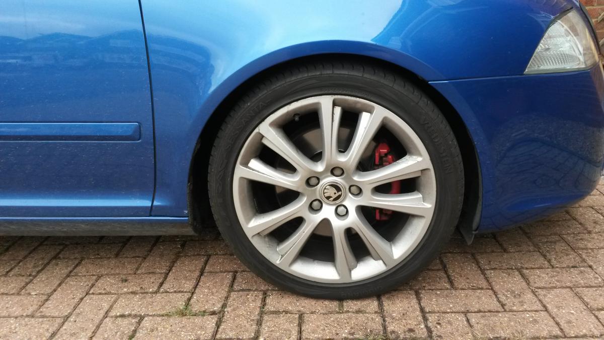

Pics of the vogtland -50mm springs, so far i have only done 30 miles so they may settle a little bit more.
Edited by willy0329
Great stuff. Can't wait for the pics.
pics now added
Thanks for pics willy.
I think you have convinced me. That looks perfect.

May be just the pics but the rear does look ever so slightly lower than the front, would you say that's the case or just the pics?    See they also do a 35mm rear/50mm front kit which might be better given I often carry a load like I say.

It sounds like you would be better off with the 35/50 kit if carrying extra weight. ,my car dose look level in real time it's probably just the pic and the shape of the arches looking lower on the back it has tools and oil etc in the boot and two kids seats and a full tank of diesel in that pic .
