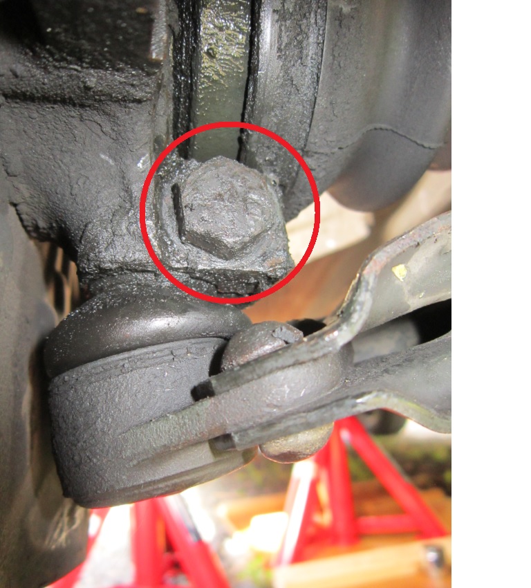

So my felicia past the MOT so i'm happy for that :D  But it also says that the Front suspension balljoint should be changed for the next test. So i wanted to try to do it my self and its so that i can't remove the balljoint clamp bolt. ( see picture ). After trying to unscrew it i find out that the torque of this clamp bolt is 65 Nm.
My question is how can i unscrew it ?

Obviously with the proper tools and a bit of force. By proper tools I mean solid 16 and 17 socket and/or ring wrenches. By force I mean muscle to overcome the rust. Hammering the head of the bolt before unscrewing may help. Also using penetrating oil like WD40 or similar. In extreme cases when the nut is seized you'll need to apply heat to the nut from a blow torch. After unscrewing the nut and removing the bolt you may need a crowbar to detach the pivot of the ball joint.
PS
65 Nm is not the end of days. It's the rust that seizes fasteners or the previous mechanic used an impact gun. For comparison wheel studs are torqued at 110 Nm and front wheel axle nuts at 210 Nm.

Well then i will try it, thanks for the answer Ricardo.

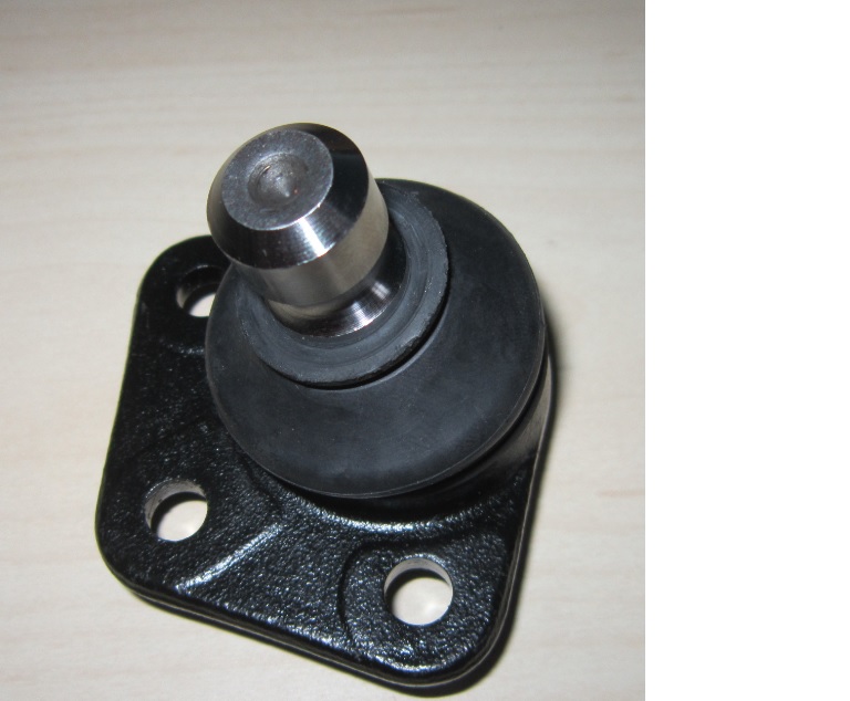

It's easiest and safest to use a ball joint splitter such as http://www.halfords.com/workshop-tools/tools/hand-tools/laser-ball-joint-separator-cup (for illustration only; no recommendation of Halfords stores or of Laser tools is made or even implied).
I don't how you want to take the balljoint out with that tool... this is a balljoint : ( see picture )
Exactly. Ken is confusing the lower ball joint with the track rod end. The tool he mistakenly advised you to use (based on first hit on Google) can be used only on track rod ends.

So i finish the work, and it was hard. The bigger challenge was to liberate the balljoint from the lower suspension arm, because it was fitted with rivets. So i cuted the head off and perforated. To do this, i needed more space between the rivets and the ground, so i take off the lower arm.
