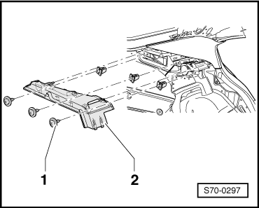

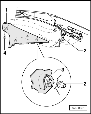

Take the middle trim off that runs between that part and the same part at the other side just pulls off and there should be a screw i think its torx the you can gently pull the trim off from that location
Mine has the similar problem, both sides. The shape and edge of the C-pillar trim is not that accurate enough.

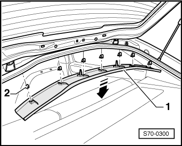

The correct way is to remove supports of the luggage compartment first, then remove the ceiling strip, as showed below.
I seem to recall there is also a tiny screw hidden behind the door seal.
