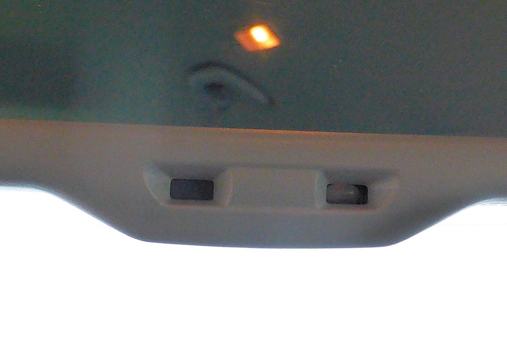

They stopped putting the LED lights on the mirror when they changed it for the crazy small thing that's now fitted.
I don't think they have ever fitted LED lights actually on/in the mirror.
This is what he means, on the left is the light to say auto dip is switched on/working and on right the sensor that operates it.
