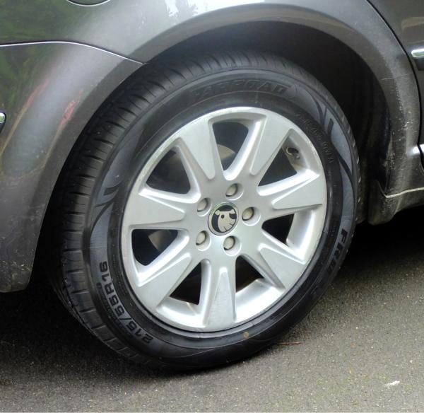

Just as an update, I looked around at the price of new steel wheels and tyres, but wasn't too keen on spending the £600 or so that it was going to cost as I had no real idea if I was going to like the outcome, so had a look at the local Gumtree ads and found a set of 16" alloy wheels fitted with almost new tyres from a Passat ( the owner had just bought some "bling" wheels and low profile tyres)  that were on offer for  a bargain £90.
So I checked all the numbers, went and had a look and the wheels were 7J x 16, ET45 fitted with 215/55/R16 tyres. The number of bolts, pcd and bore diameter were identical to those on the Superb. I know that the ET45 meant that the wheels would sit 8 mm more in to the car than the standard wheels would, but, after checking the tyres and wheels over very carefully, thought I'd give it a go and find out. At the worst case, I could just re-advertise them.
The wheels needed a bit of re-furbing as they had come with that strange "chrome" finish that seemed to have been glued to the spokes, so I used a scotchbrite wheel on my drill to easily take the glue etc off the spokes, then just used some "Rub'n Buff" silver finish to very quickly tidy them up.
That stuff is quite amazing ... it costs about £5 for a small tube, but goes a long, long way. It's a carnauba wax heavily impregnated with silver particles and is very good to rub onto cast aluminium to make it look clean and almost new. Lasts a long time and can be re-applied whenever you feel like it. The wheel centres were sourced on E-Bay for £8 and while of good appearance, I felt they need a little more to hold them in place, so just applied a bead of clear Bostick, which is like a rubber solution glue that stays quite soft, but grips well. They should come out fairly easily when the wheels need to be balanced in future.
One of the tyres was a Yokohama, but the others were .... shock, horror .... Chinese, Far Road make to be precise.
I was dubious to say the least, but looked them up ... state of the art factory, 20 million tyres a year output, 97W rating on the tyres and they were there in front of me, all new, all fitted and balanced, so I thought I'd try them, albeit with a fair amount of apprehension.
After a few weeks and a few hundred miles in wet and dry conditions, I've come to the conclusion that the Chineses are producing tyres that should really worry the mainstream manufactureres. They grip well and are smooth and quiet.
But the main conclusion is that the Mk 1 Superb must have been designed to run on 16" wheels with higher profile tyres, because the ride quality, steering and overall feel of the car is just so, so  much better than on the 225/45/R17 tyres that were fitted when I got it.
I really am amazed at the transformation.
