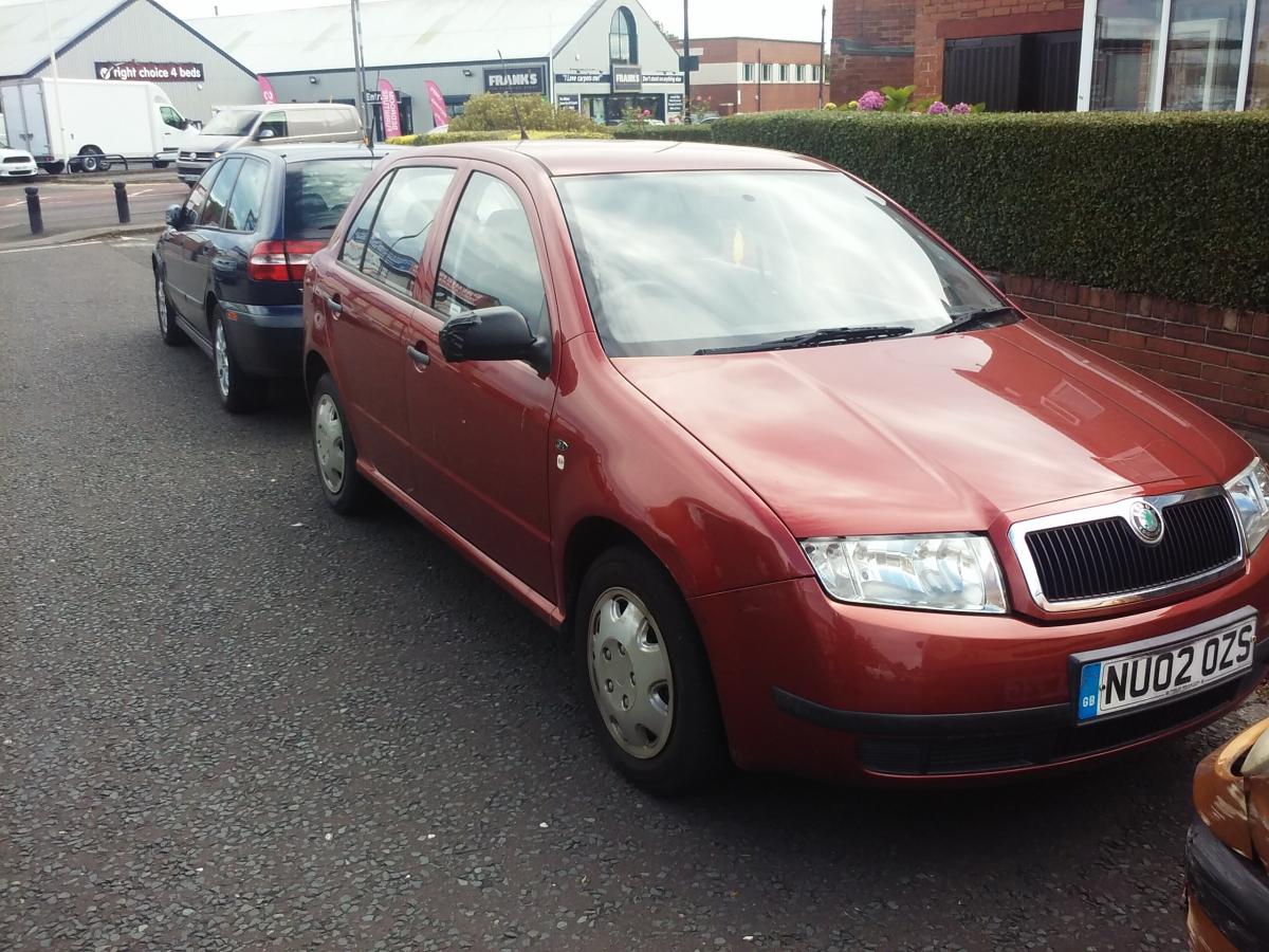

This is how she looks since polishing with blood sweet and tears, ive also managed to get the interior looking better. Trust me she did not look like this when i got her. She had moss growing out the mirrors and sills.
Nice job on tidying it up :)
