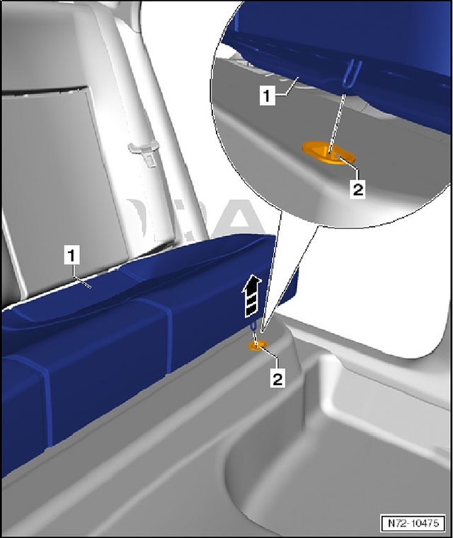

Being lazy here and I know I should have tried but is it straightforward?
I'm talking about the part of the seat you sit on NOT the bit you lean against.
Thanks everso...
- Remove caps for ISOFIX child seat mounts.
- Remove the lug.
- Grip on both sides with both hands under the seat bench in the area of the mounting grommet and pull up forcefully and with a sudden motion.
Edited by Petunet
Nice one, thank you.
The act of removing the rear seat usually destroys the plastic gizmos at the front of the seat as they are one-way only. They are relatively cheap and easy to replace.
Oh, yes.
On the page 413 of the service manual it says:
"Before assembling the seat bench replace the mounting grommets as these parts are not designed for reuse."
Anybody know the part number?
Part number is 5G0-886-373
Excellent, appreciate your help. :)
