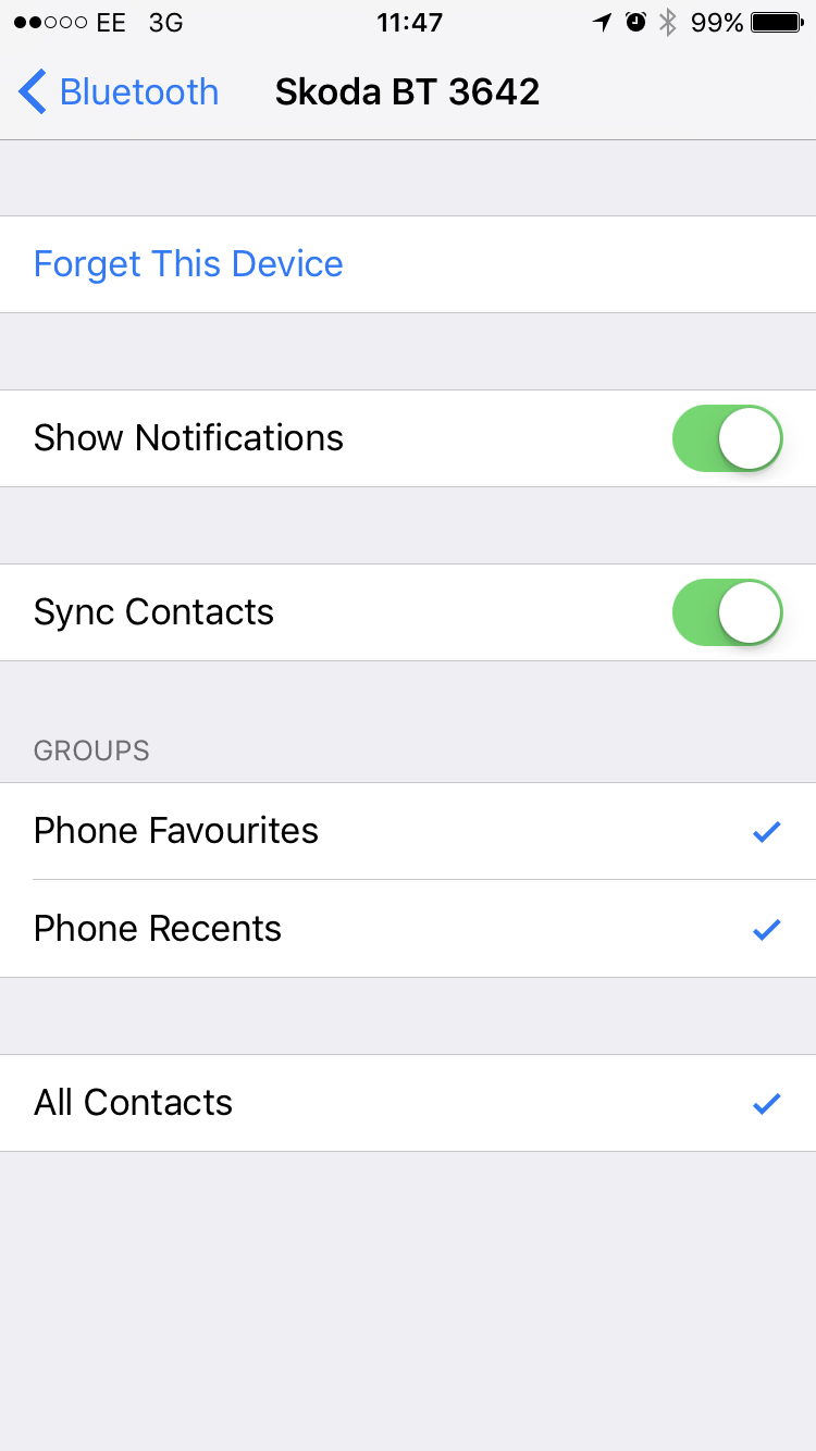

I'm sure you managed to solve the problem but for those who may have the same question I'll leave this reply. Within your iPhone Bluetooth menu you need to open the profile for the connection to the car by pressing the 'i' alongside of it and make sure to activate Show Notifications.
on my iphone 6 there is no Show Notifications option.
Nor is there on my iPhone 7+.

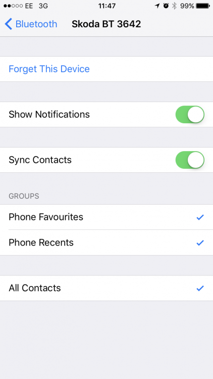

That's odd as I get this screen on my iPhone 7 when paired with a MIB2 Amundsen.
Edited by sneeks
I am not connected to car at the moment, maybe this option is only there when connected? Will have to try again later.
You don`t have to be connected to the car. I`m just looking at my phone and the screen looks the same as Sneeks.
That's a bit strange then, I wonder if it is to do with the version of Amundsen in the car. Perhaps when it made the initial connection it establishes the features available & only shows that option if applicable. Mine is a June 2014 car. How do you tell if it is MIB1 or 2?
I was trying to check which unit you have with no luck but I think yours is MIB1 as the MIB2-s came after 2015. Mine is March 2016 with the MIB2
Also strange that Sneeks car is a 2010 FL vRS and his phone has this feature but SWboy doesn`t and his car is a 2015 octy :speechless:
Exactly what Sneeks posted. In the paired devices section you need to tick the show notifications button. It wasn't ticked when I changed phones but once it was, the text message box came back. All good now!
Thanks
Oh and you need to have the Amundsen updated to the latest maps. I didn't have it before the update so it must include it along with the maps.
