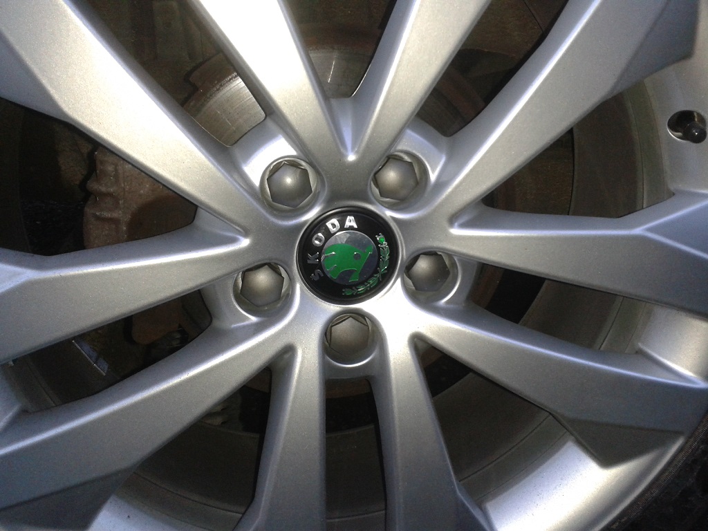

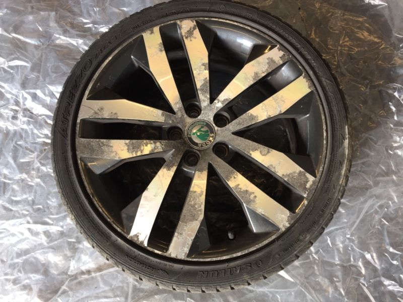

Also, my caps look different to the VRS pics I've found on here. I'll attach a photo.

Those in your picture look to be different caps  from those that came with Gigaro wheels,
the early ones that often got replaced under warranty before 3 years were up.
EDIT,
forget that, they look the same when i look again at them on Dark Chrome Gigaro.
There is never much coating around the centre hole be that Dark Chrome, Black, White or Silver.
(hence why so many Dark Chrome Gigaro are corroded around the centre hole and the plastic caps, and even over the other areas of the wheels.
Picture from Google images.
Edited by Offski

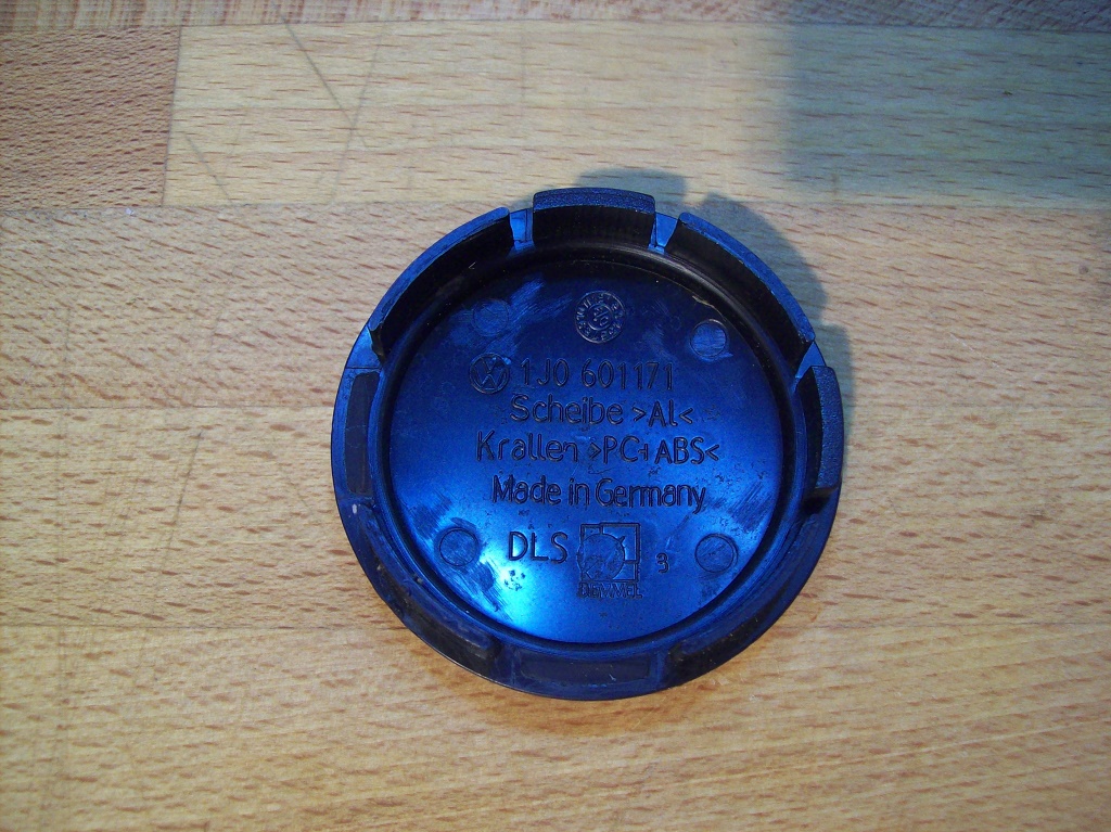

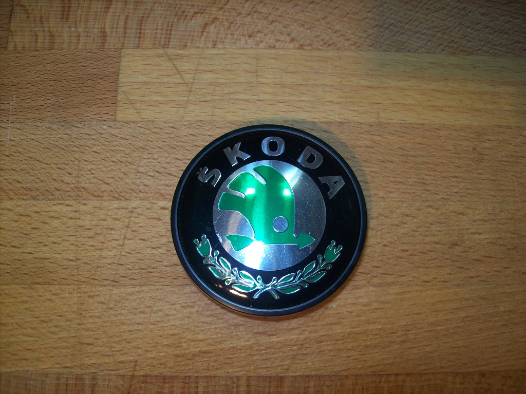

So the supplied caps are part number 1j0601171 - a google image search shows almost all results as VW caps

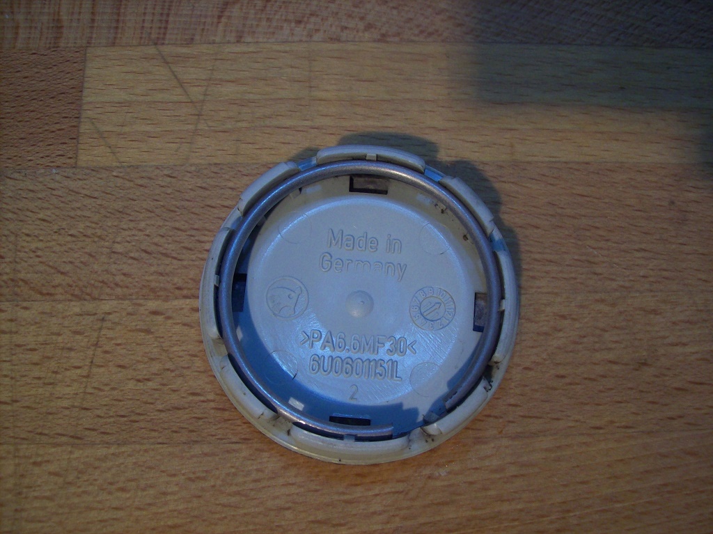

I also have an old set of Skoda caps, from 15" Antares wheels, these are part number 6u0601151l. Much better made with a metal spring on the back. Will post pics once I have a chance.
6U0601151LMHB are the correct ones i think.
Edited by Offski

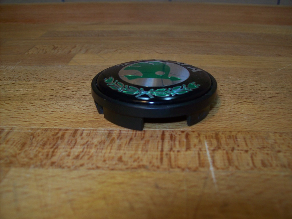

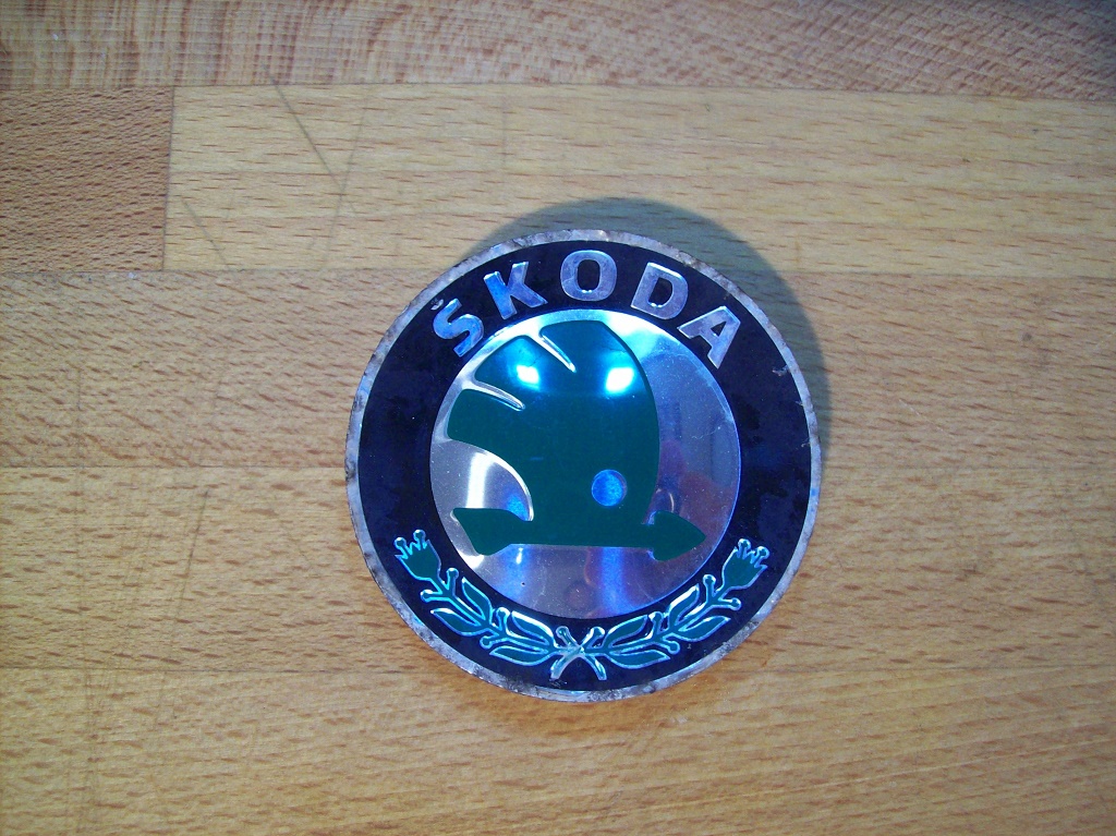

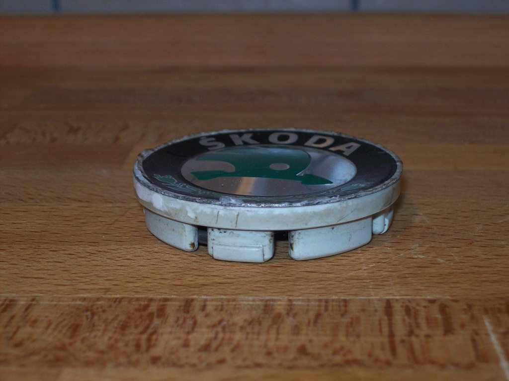

I've added some photos so others can see the difference.
The grey 6U0601151L seem to be much better quality, with a metal spring to retain them.
The black 1J0601171 caps are prone to breaking the clips, all mine seem to have at least one broken clip.
Yet to see a VRS in the flesh to take a look but photos online seem to show that the 6U0601151L caps are always fitted.
