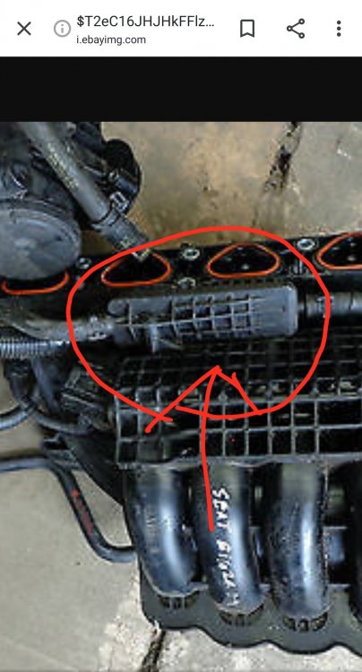

In my engine there is another component at the place of item 13 of your link: the diagram is not for the erlier bxw version probably, the component is a rectangular plastic preheater for the basement.
The component i mean is this under the inlet holes with orange gaskets:
http://i.ebayimg.com/00/s/MTIwMFgxNjAw/z/nLQAAOxyzfNRrhLl/$T2eC16JHJHkFFlzdSDRoBRrhLlLFg!~~60_1.JPG
I had to replace it a few months ago due to a leaking problem!
This preheater is present on both piping scheme versions of Elsawin: with the electric oil separator or "liquid coolant oil separator".
