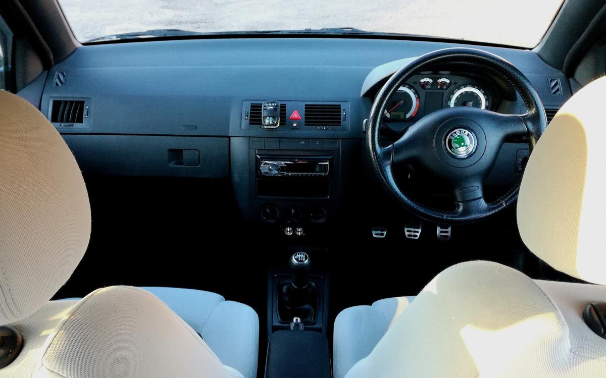

Does anyone know if the 2014 skoda Octavia vrs gearstick and gator fits the mk1 Fabia ? My gearstick is ripped from previous owner wearing rings etc, but cannot for the life of me find any new or nearly new Fabia vrs sticks. Looking at other avenues such as the Octavia one etc.

This isn't what you are after, but I fitted a VW Golf stick in mine
Just tested the cheapy eBay (£7.99) one first and its a great fit, think the genuine ones are £20ish

No not at all, just take your vRS one off (cut the metal clip), put the golf one on, and maybe tighten it up with a jubilee clip
It's literally like for like swap

So its a MK4 at a guess? Just need to knob and swap them over
Indeed

Hey thanks mate, only now seeing the responses. That actually fits in quite nicely. I will certaintly be looking into this then!
