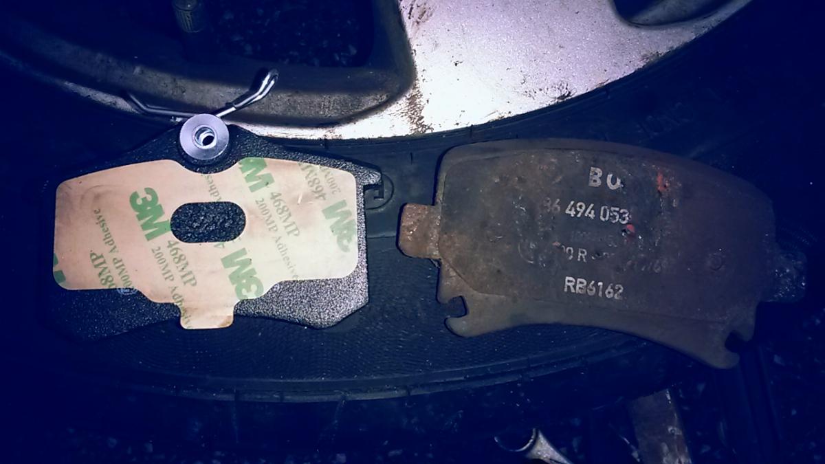

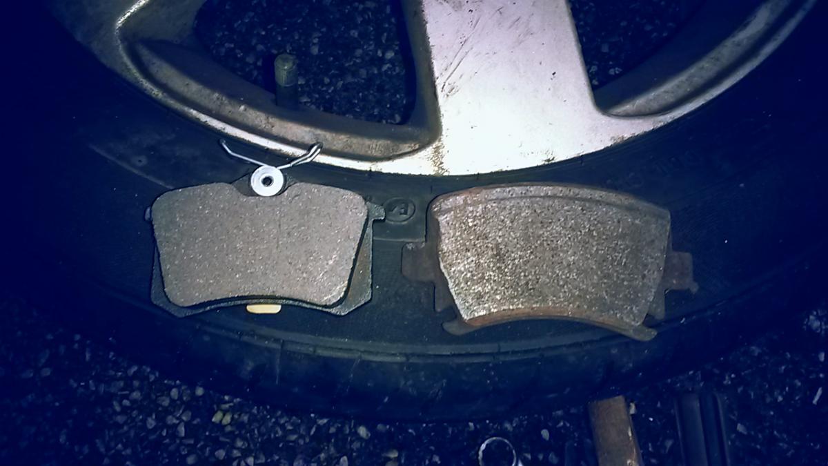

Bought brake pads as specified for 2006 2.0Tdi, but on taking the old ones off, it's clear that the pads, (and calliper) are totally different from that which have been sent through. Any thoughts on part no. I need to go for?
To be fair to Euro car parts, they've sent the ones that my reg suggests should be on the car.
Should have said that I've tried the numbers that are on the back of the orpost-22618-0-29028000-1484504179_thumb.jpgiginals, but nothing is coming up

Thanks, will look this up. Just wondered if it's common to have different parts on than the euro car parts would point you too?
Had a Capri many many years ago, and I think that was made from many part bins as it went along the line. Always had to take the old part in to get a match!
Yes it is quite common for ecp to bring up multi parts from your reg, best to match the pad from the pictures.
ECP have two computer systems, the main one (which includes the website search) is a bit vague and often gives a choice of parts, or just the wrong one. If you ring them they can check the other system which cross checks against VAG.
I have been burned so many times by ECP. I always use places that are local now so I can go swap them once I have a car in bits if they end up being wrong.
Some car manufacturers have an insane amount of different pads for the same car and engine depending on year etc. They don't make it easy for places that sell parts at all.
Checked and 101441178 are exactly the right pads.
