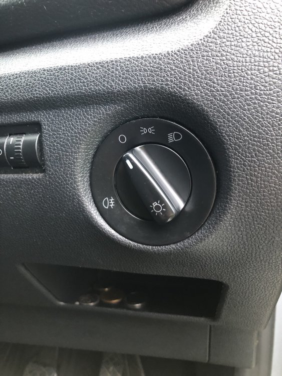

The light switch for some reason doesn't always light up.
Is there an easy way of removing so I can see if there is something loose or are they a sealed unit?

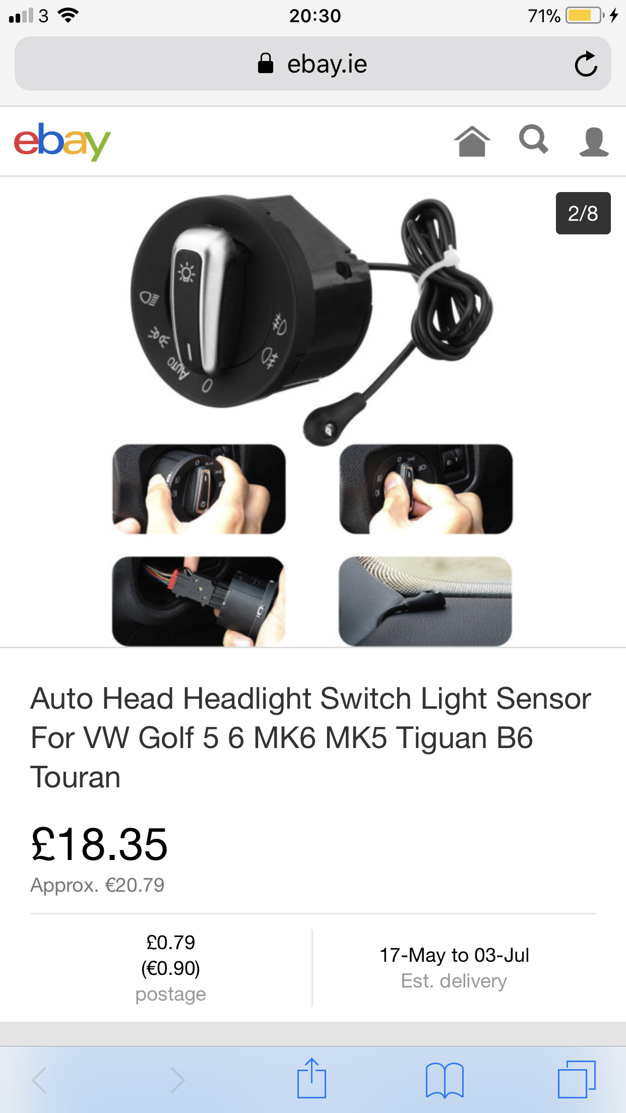

Assuming this is the same

put the switch to 0 and then push into the dash and turn clockwise so the lever is inbetween 0 and sidelights. That should release the switch.
Had a check of it today.
Sealed unit. Luckily I'm getting the auto lights on switch etc so at least it should work ok then

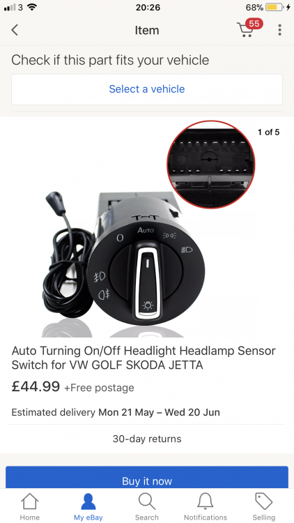

Does autolight switch work plug in and work ok? I got fabia 2014 August one 1.6tdi cr105 also want to fit fog lights too, gratefull of any help as new to skoda

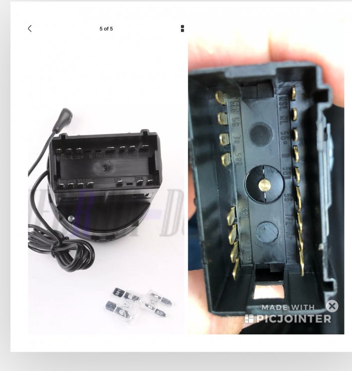

You need a switch and module if you are upgrading... The switch is just that, the module is the thing that does the auto stuff, along with its sensor, to detect ambient light. The switch you show also only has provision for rear fogs... Unless you are capable of adding fronts and wiring it, you will need a matching switch otherwise it will show the function but won't do the function.
So I bet the module is the box that clips onto this? Or is this all I need? Its all new to me, front fogs I will fit later as want montecarlo tinted ones cheers
Actually, yeah. This is a later generation version which has the sensor etc incorporated into it. Make sure your switch has this larger connection too. Some have larger ones, some have smaller ones. This switch will almost certainly light up red, too as opposed to Skoda green as it is actually made for VW's that have red illumination. It is also set for front and rear foggies!
Cheers
Sorted easy to remove as said and new upgrade ordered for larger rear connector on 14 estate
Same as older version. I thought they started to fit smaller ones but it may be a slow change over. VW do seem to like getting their money's worth. I am surprised McDonalds has not cited them on their saver menu adverts!
