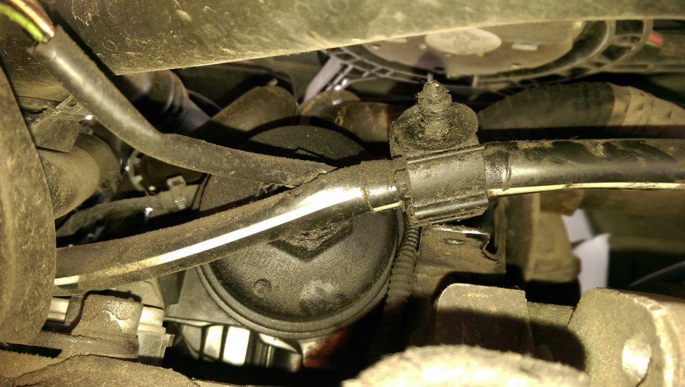

 Hi James,  Please see pics. So we are back to the days of "Flat-on-your-Back " again. ( if you don't have access to a lift :crying: )  I guess that this is the oil filter on the MK3?  It's the 32mm socket size, so it fit's the bill. I am using a tommy bar to loosen the nut, and for sure it's a tight 'un !!!  What's the total qty of oil needed? ( inc. filter) ?  Will 4.5 Ltrs be enough?. I'm using Castrol Edge Titanium FST 5w-30 Fully Synthetic.
Thanks again for your help, it's much appreciated.
Jim
BTW: The Sump stud is a 19mm.
Edited by Jim Reire
More details
