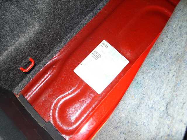

Engine code will be AUB or BBZ if it's a 101. The code will be in either a sticker in the owners manual/ service book or look under the boot carpet. There will be a sticker there with the engine and gearbox code. If the code is APE, AUA, BBY or BKY that is for the 74hp engine (BUD if a 2006-2007 model)

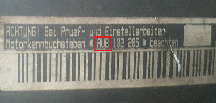

The barcode sticker on the cambelt cover?
As said above AUB or BBZ are what you're looking for.
