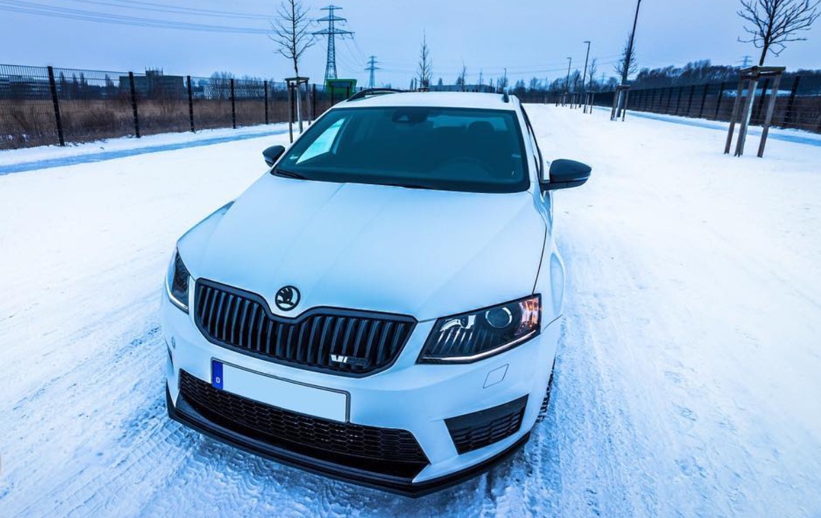

Has anyone wrapped the front lower bumper valance ?
As titled has anyone wrapped the lower valance on the front bumper (as I the pic )
looking to do this on mine and wanted some tips.
Thanks
There were some threads about this on the Leon Mk3 at seatcupra.net
You have a couple of options. Wrap to the lower grille (bumper stays on), or remove the lower grille and wrap the whole bumper section, fore and aft of the grille (bumper off) - depends on your level of OCD!
The picture also looks like the car has a separate splitter fitted too.
