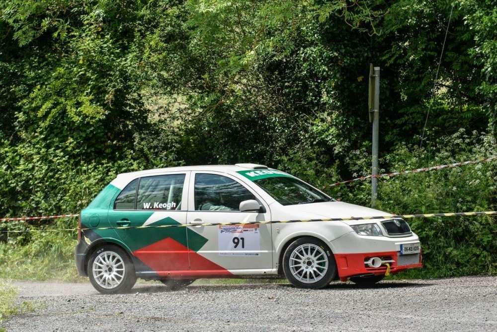

Fabia 1.4 16v 100bhp rally car
Hi lads, have a 2006 1.4 16v 100bhp Fabia rally car which I have built from ground up. Basically I'm looking for as much help possible, I need to upgrade my power in this engine, currently running standard ecu and fuel system etc only mods is induction filter, Škoda Motorsport exhaust manifold and custom 2.5 inch straight back exhaust.
