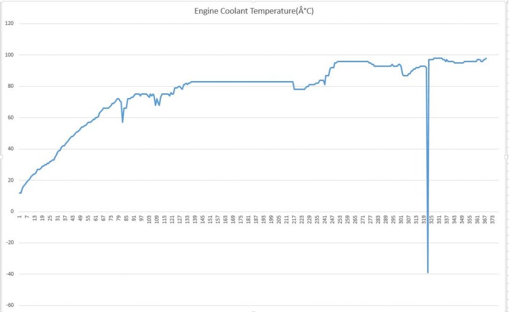

Hmmm, ran torque on the way home monitoring sensor temp, all appeared OK. Warmed up gradually, settled between 85/90 deg, fluctuating slightly as i would expect. Have got a new sensor, so will fit that anyway now, will also run another log file tomorrow morning on the way to work.
Think the sensor may well be the culprit - erroneous reading this morning on the log from Torque of -39 deg C
Get an original sensor. :)
Already got one, fitting it this weekend :)
