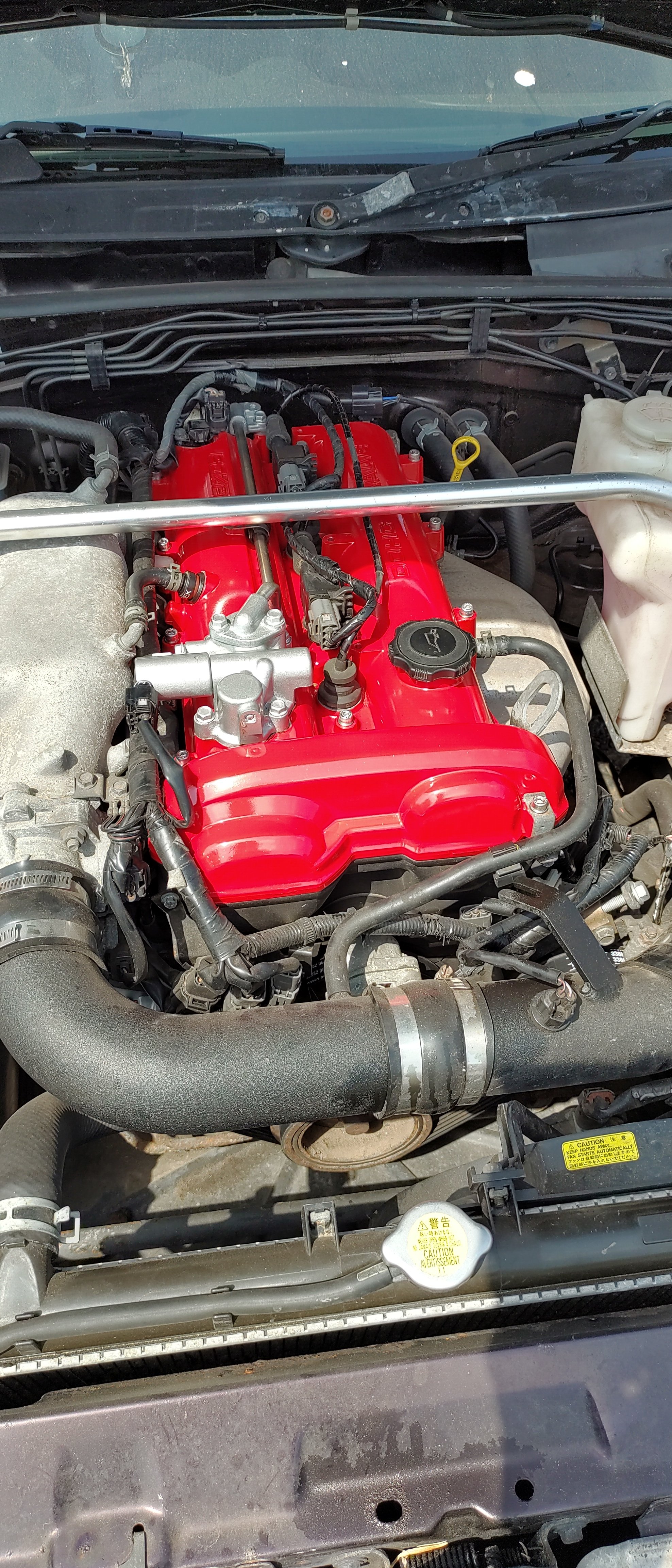

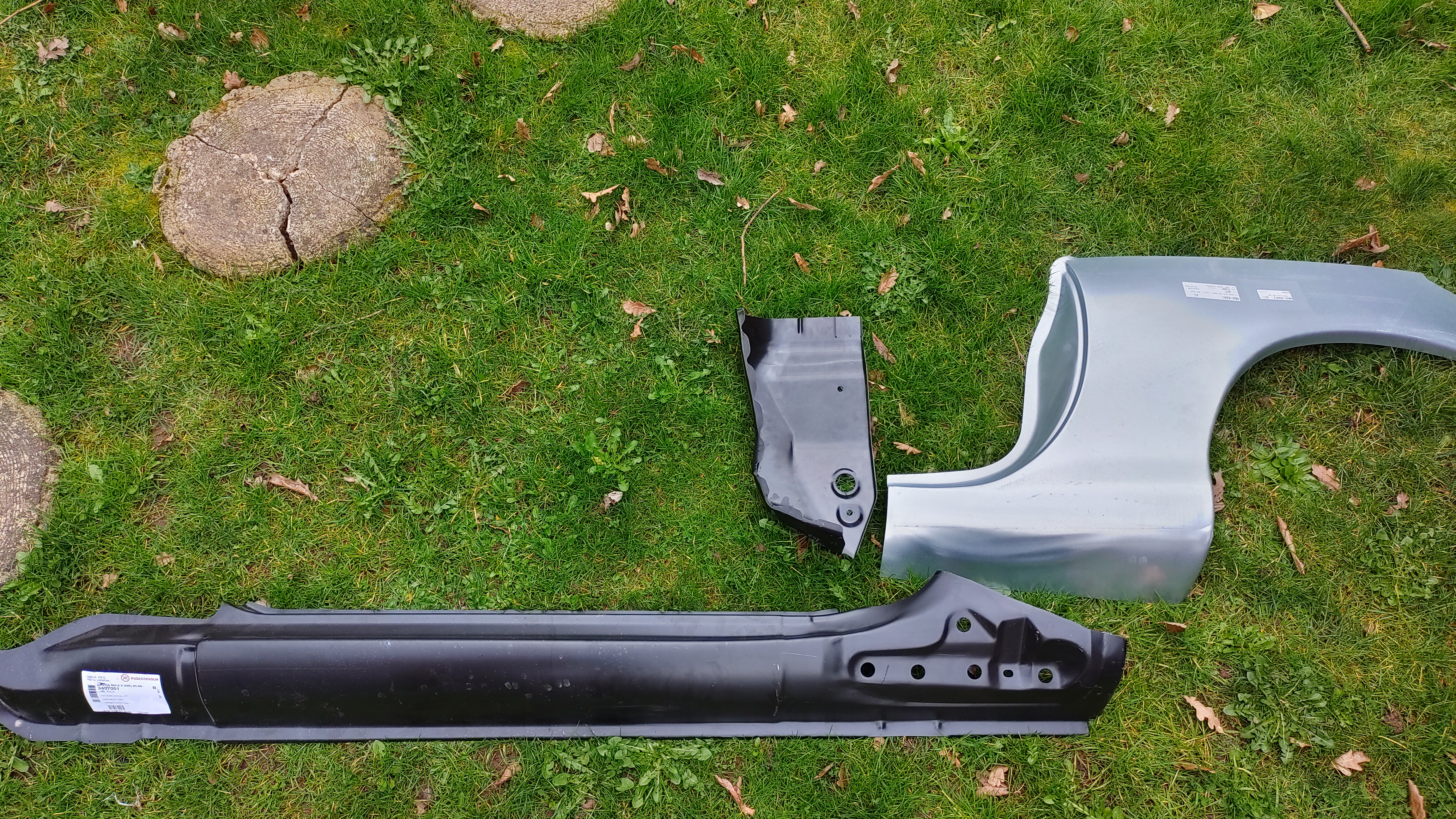

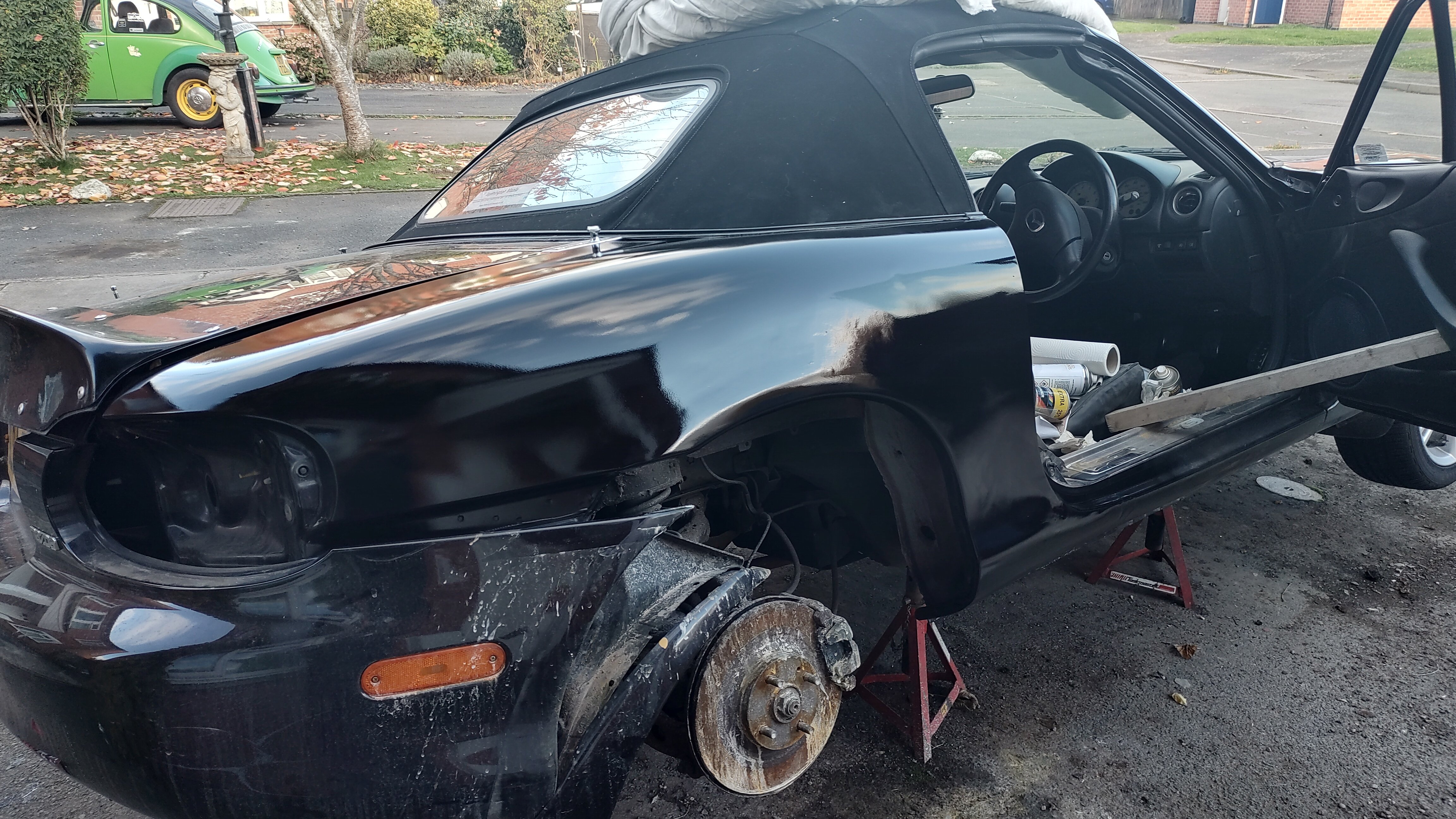

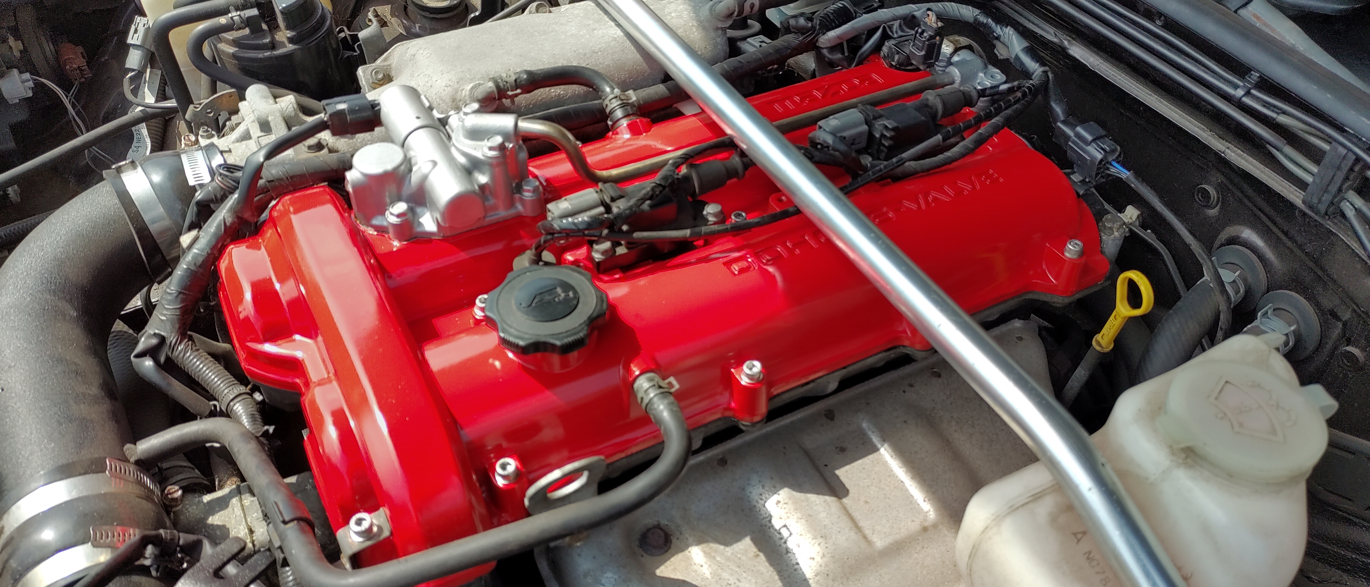

Just over 12 months on - and another MOT pass in the bag - after having to replace the catalytic converter for the correct Post 2001 compliant unit. A previous owner had replaced the original one with a non type approved (pre 2001) cat for a 1.6, so the emissions were way off. Not much been going on really, i have managed to source a complete new sill, rear arch and inner sill/arch panel for the LH side, so will be getting on with that before too long now that a few other jobs are sorted and out of the way. I have managed to paint the rocker cover though 😁other than that, just enjoying driving it (averaging between 40-45 mpg as well on v power)

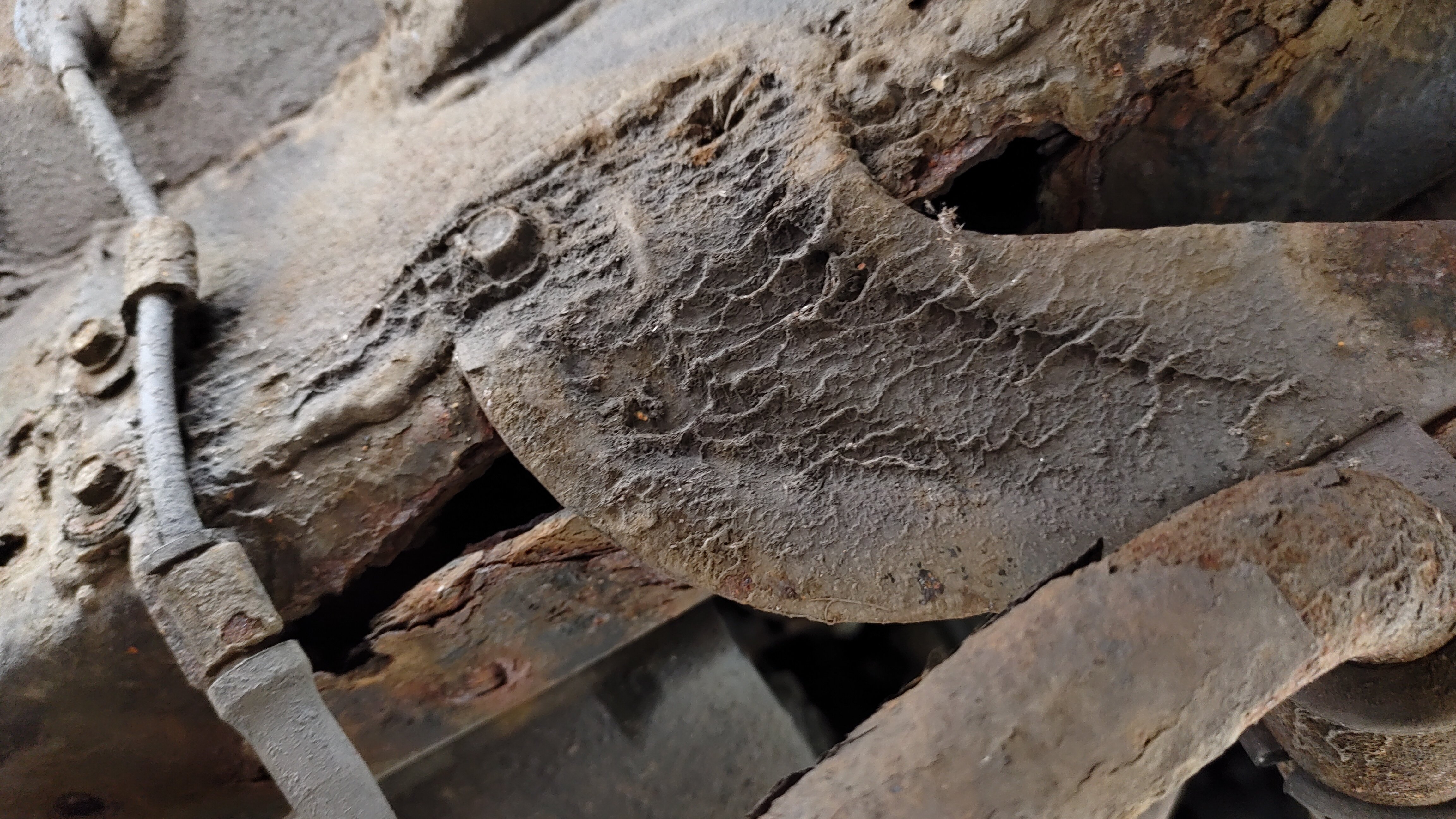

and after all the hard work - MOT passed 😀 couple of advisories to deal with, o/s/f brake binding slightly, n/s/r spring corroded, "corrosion to underbody components" and repairs covered in underseal (understandably) - time to enjoy some top down fun, then onto sorting the external bodywork out (lots of small dents and stonechips plus a new n/s/r outer arch)

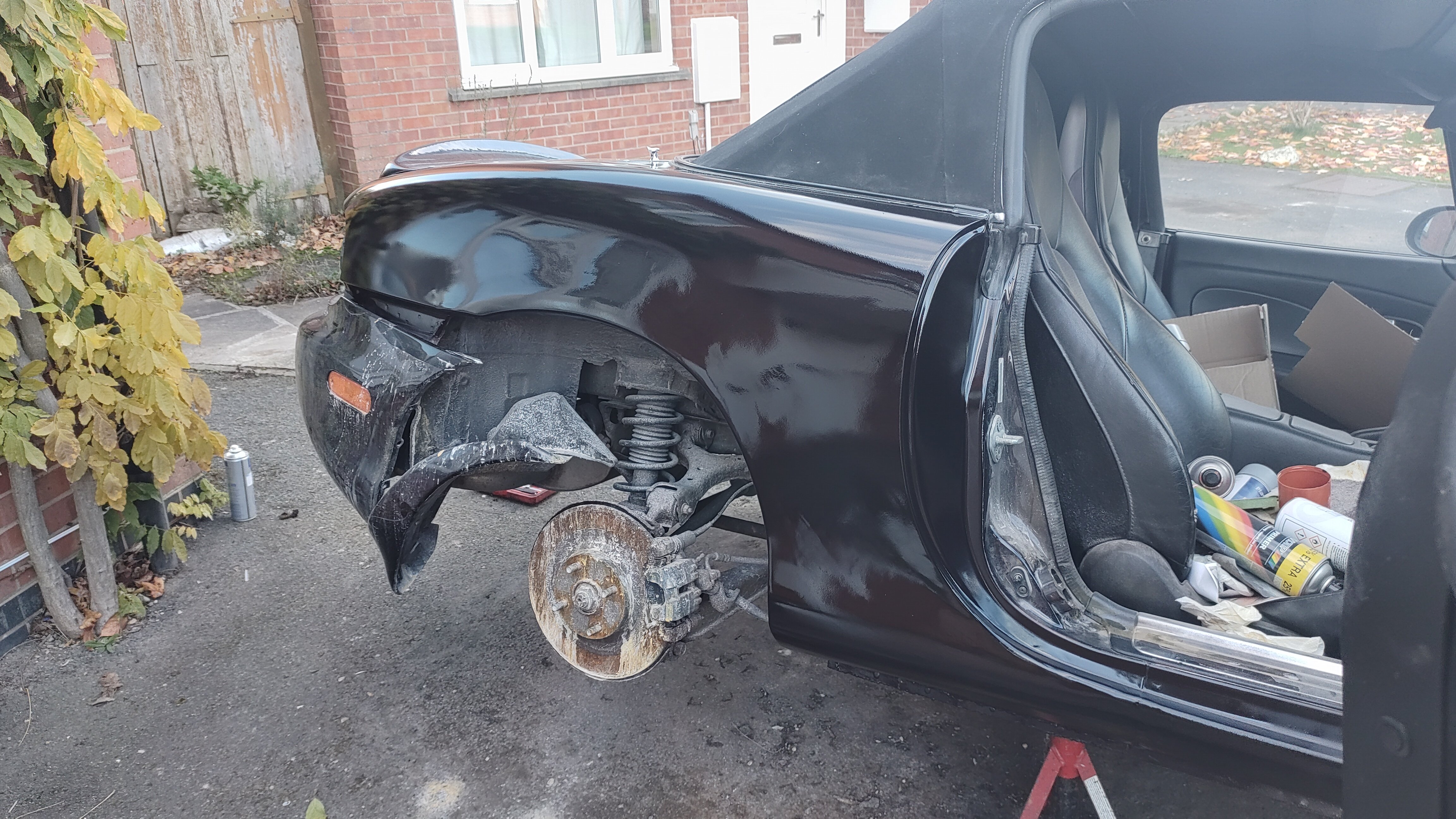

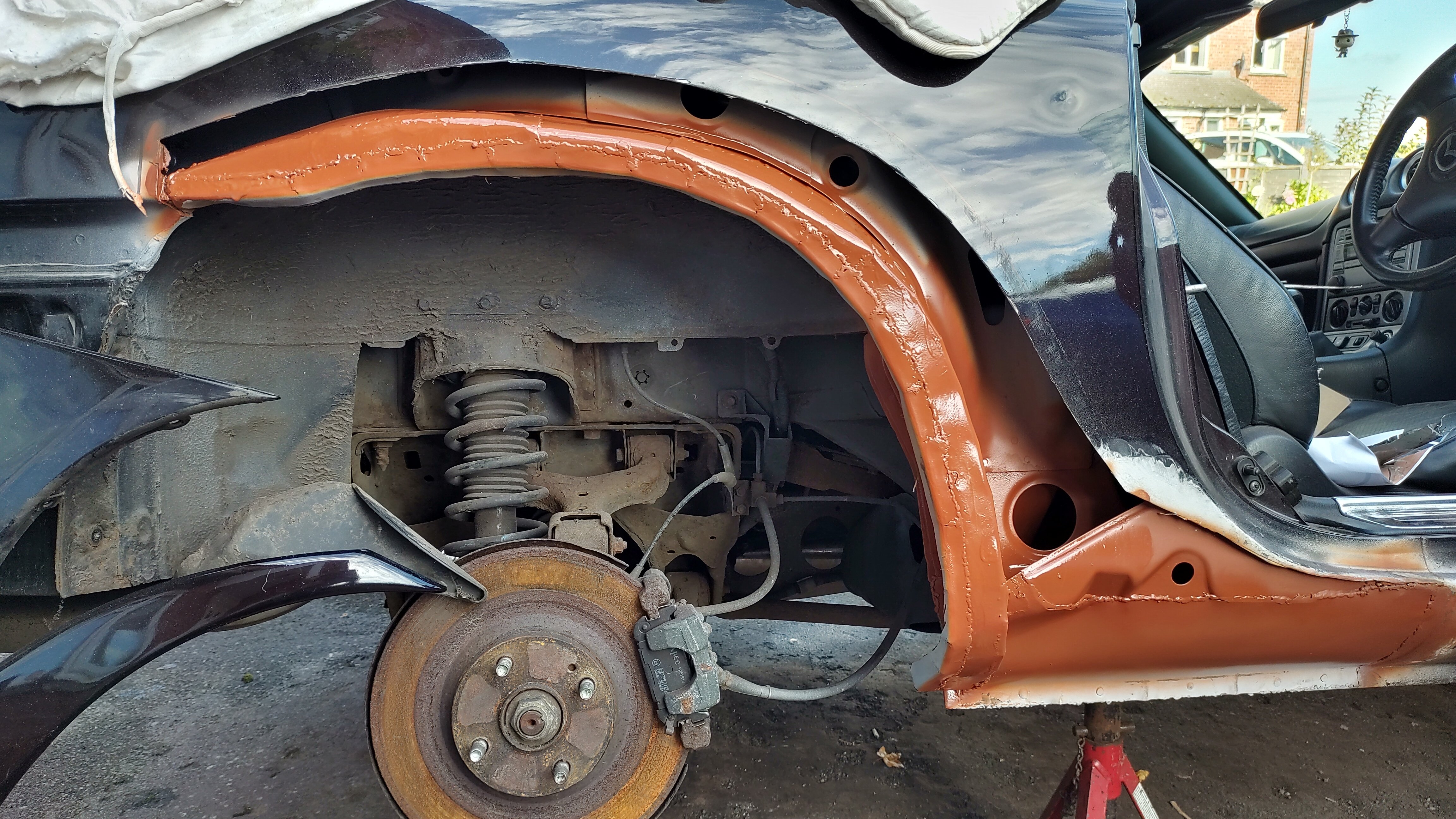

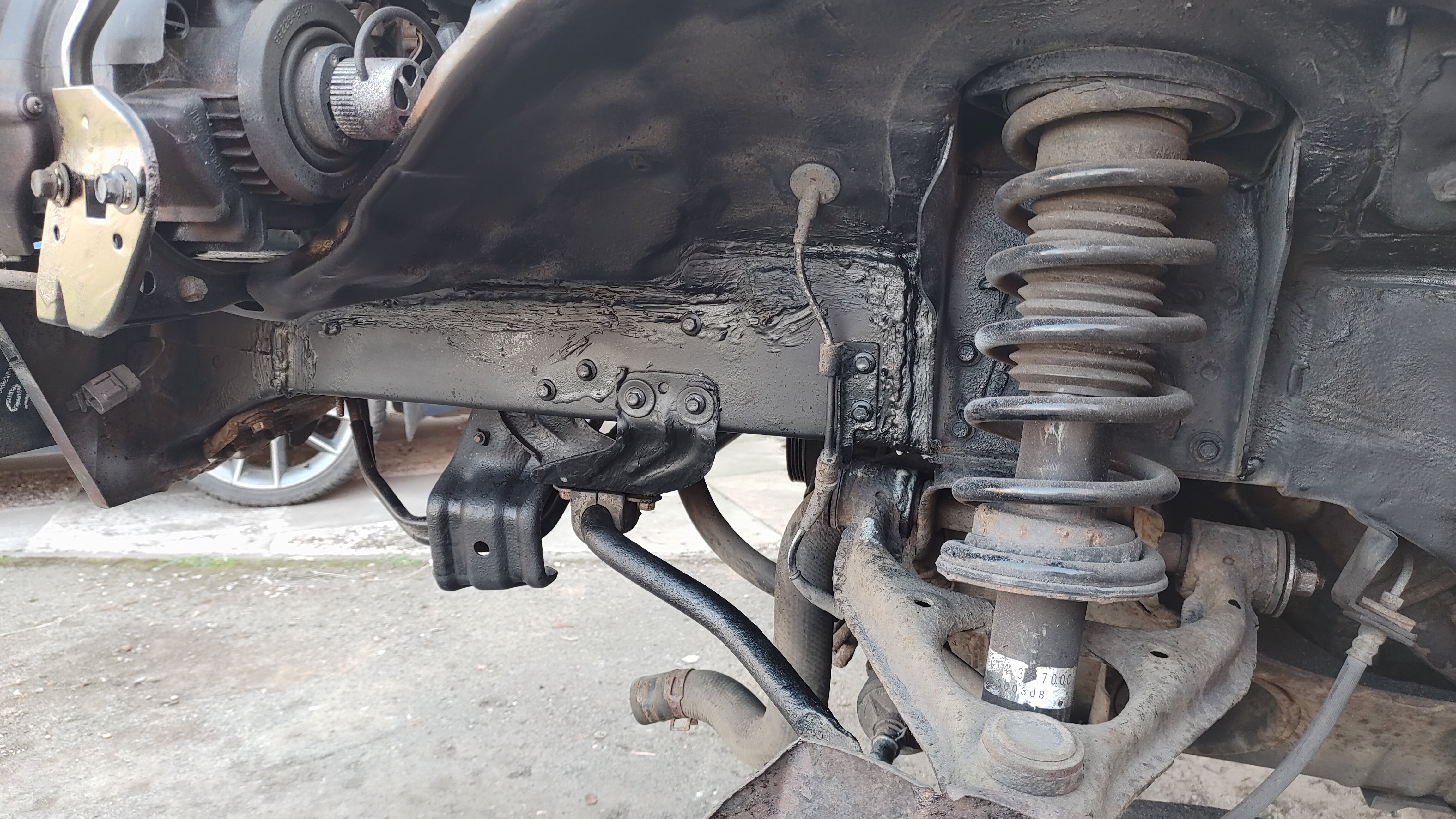

LH side all done now as well. All seam sealed, under sealed and cavity waxed to within an inch of its life 🤣

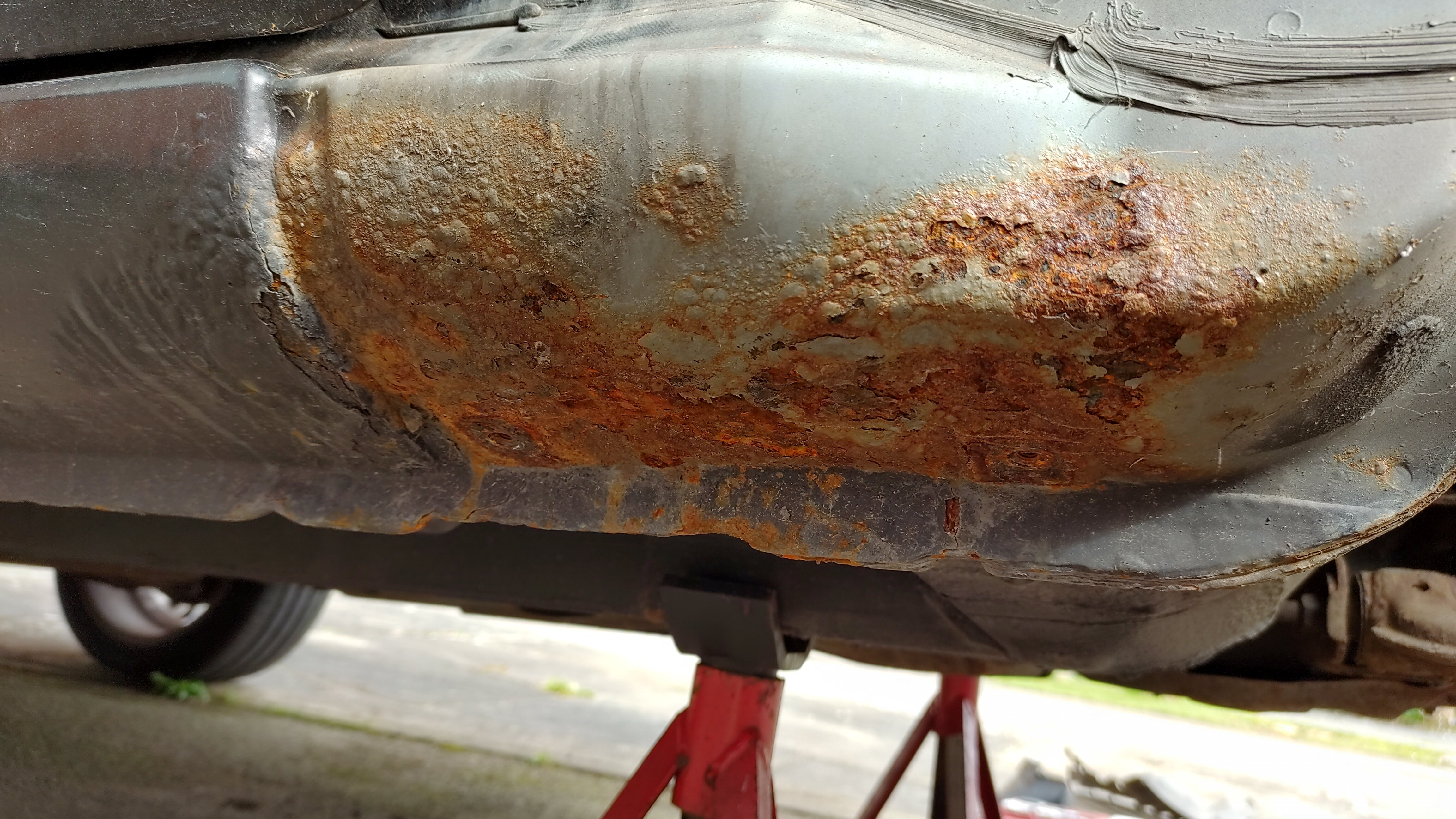

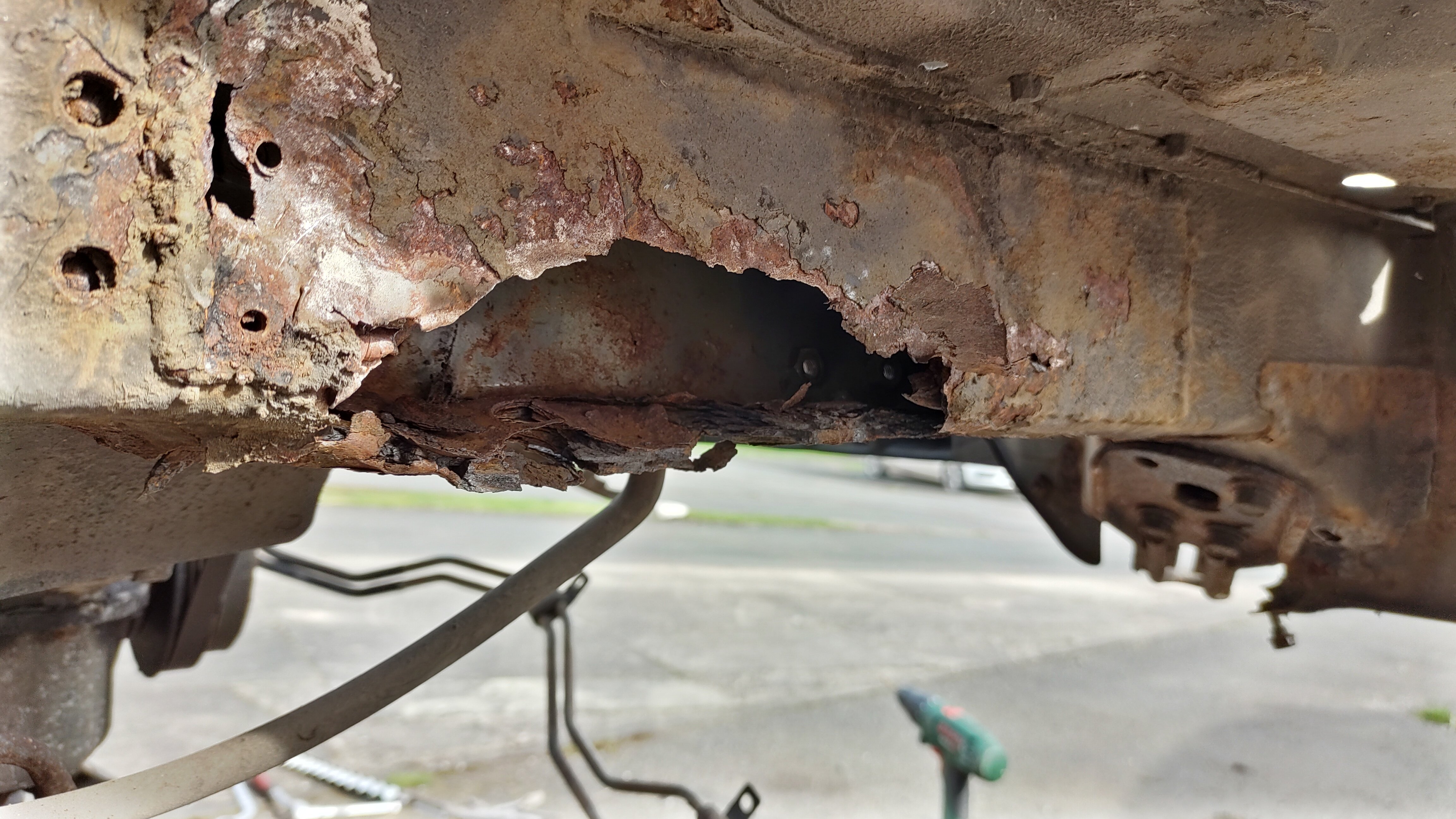

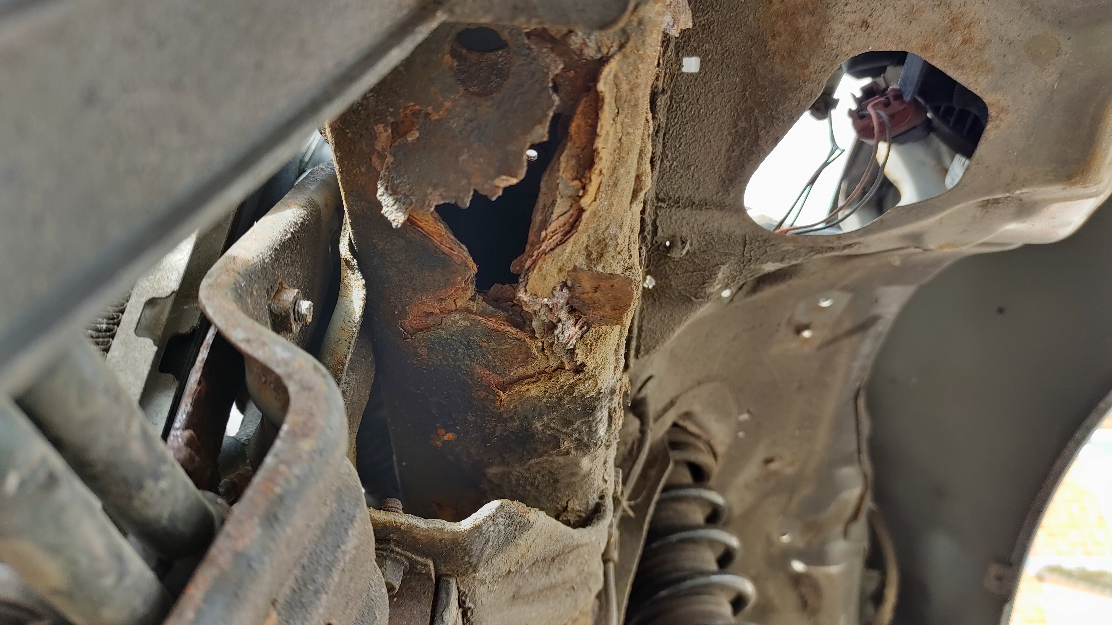

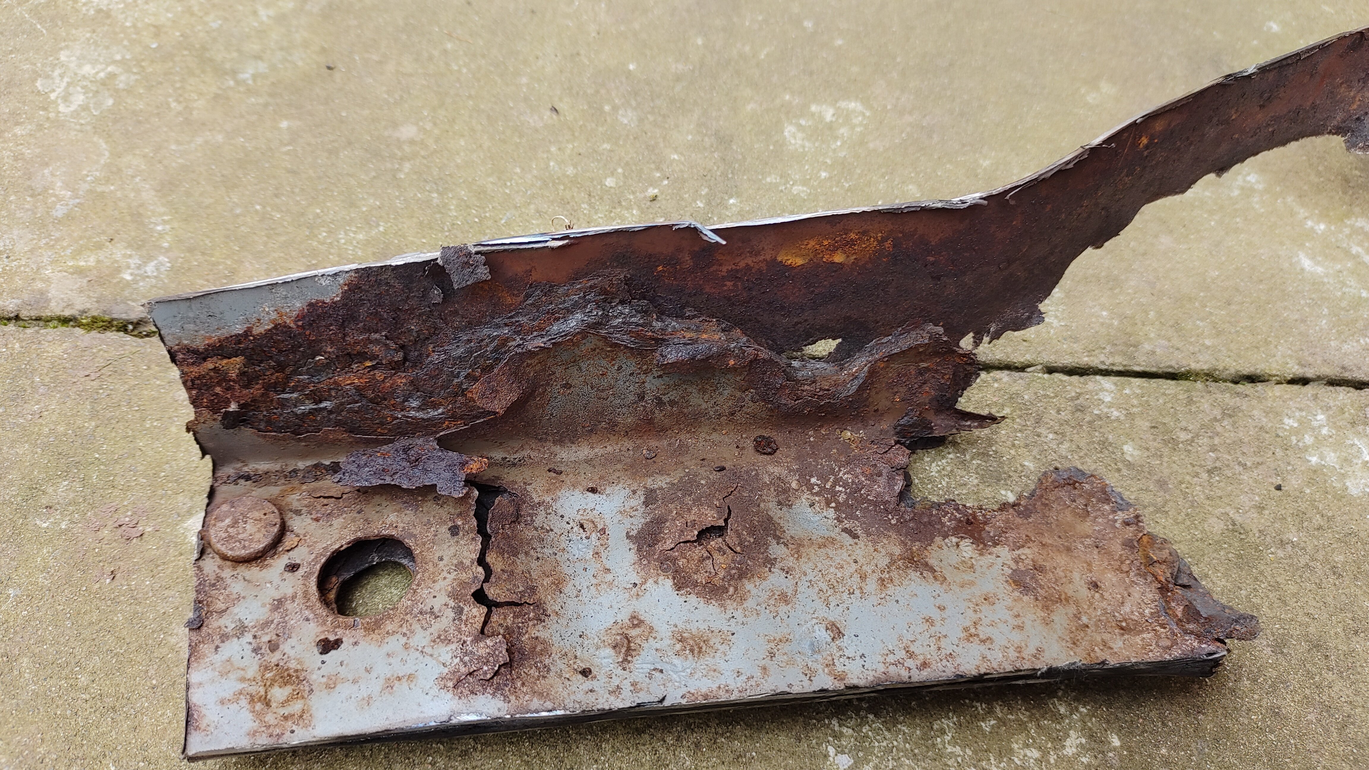

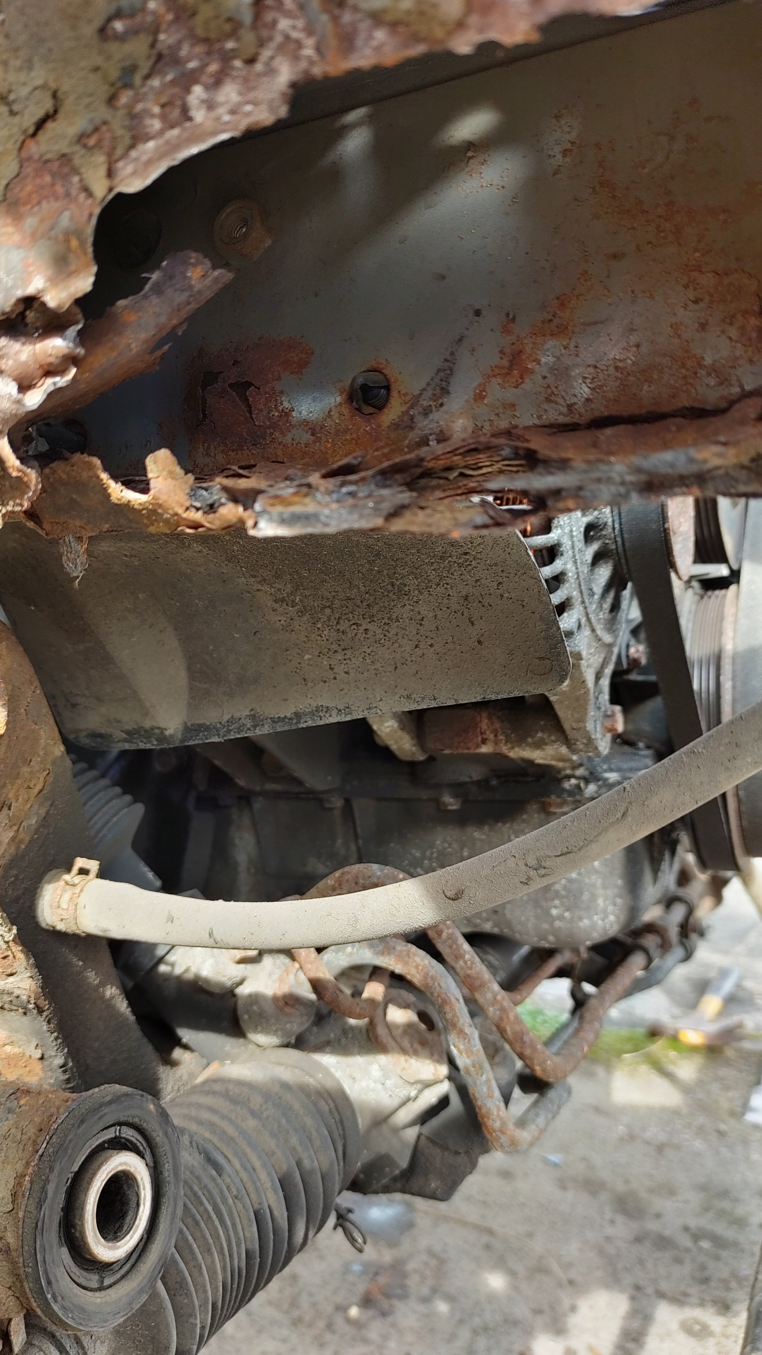

Cheap repair job in the past by a previous owner. The rot had been badly plated over so it carried on rusting from the inside out. Thankfully i got to it before it has spread too far to make it repairable. The Mk 2 came with a built in rust trap where they double skinned the chassis legs for crash protection.

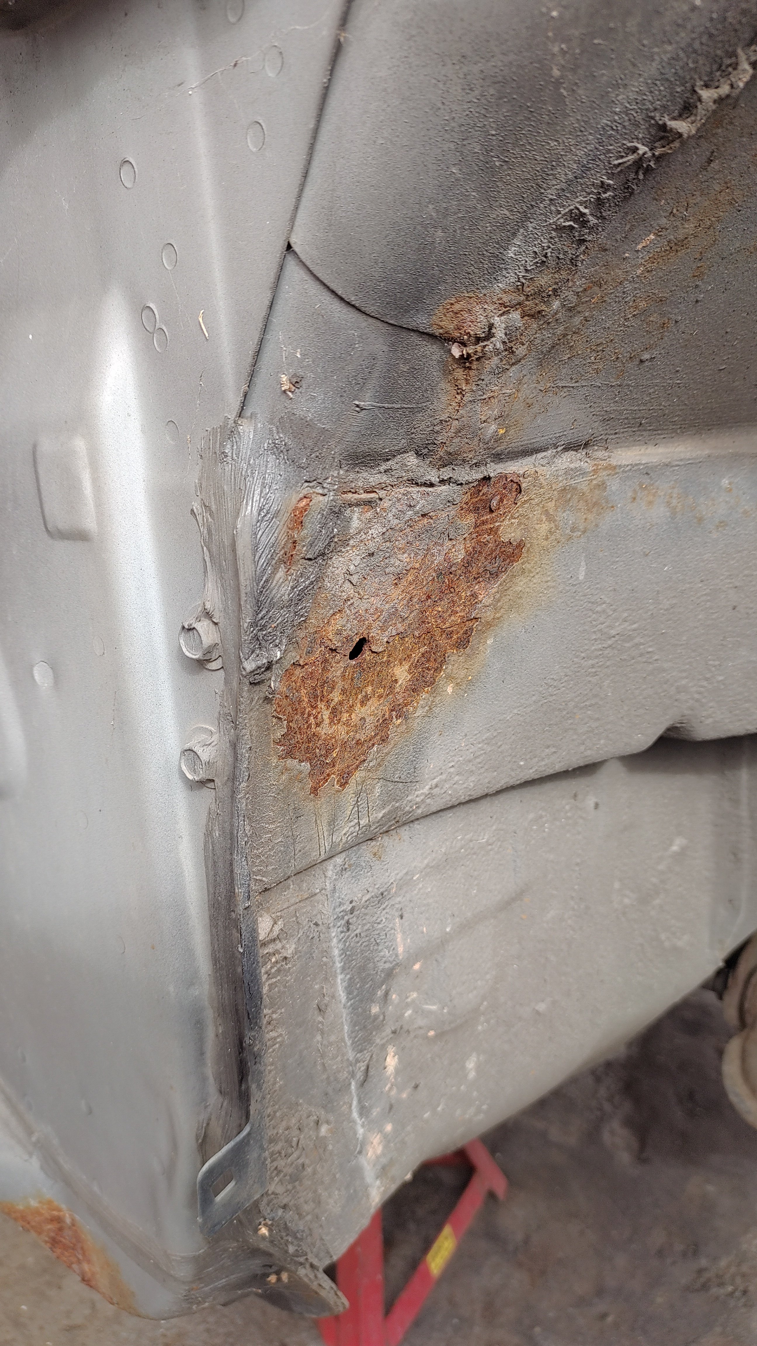

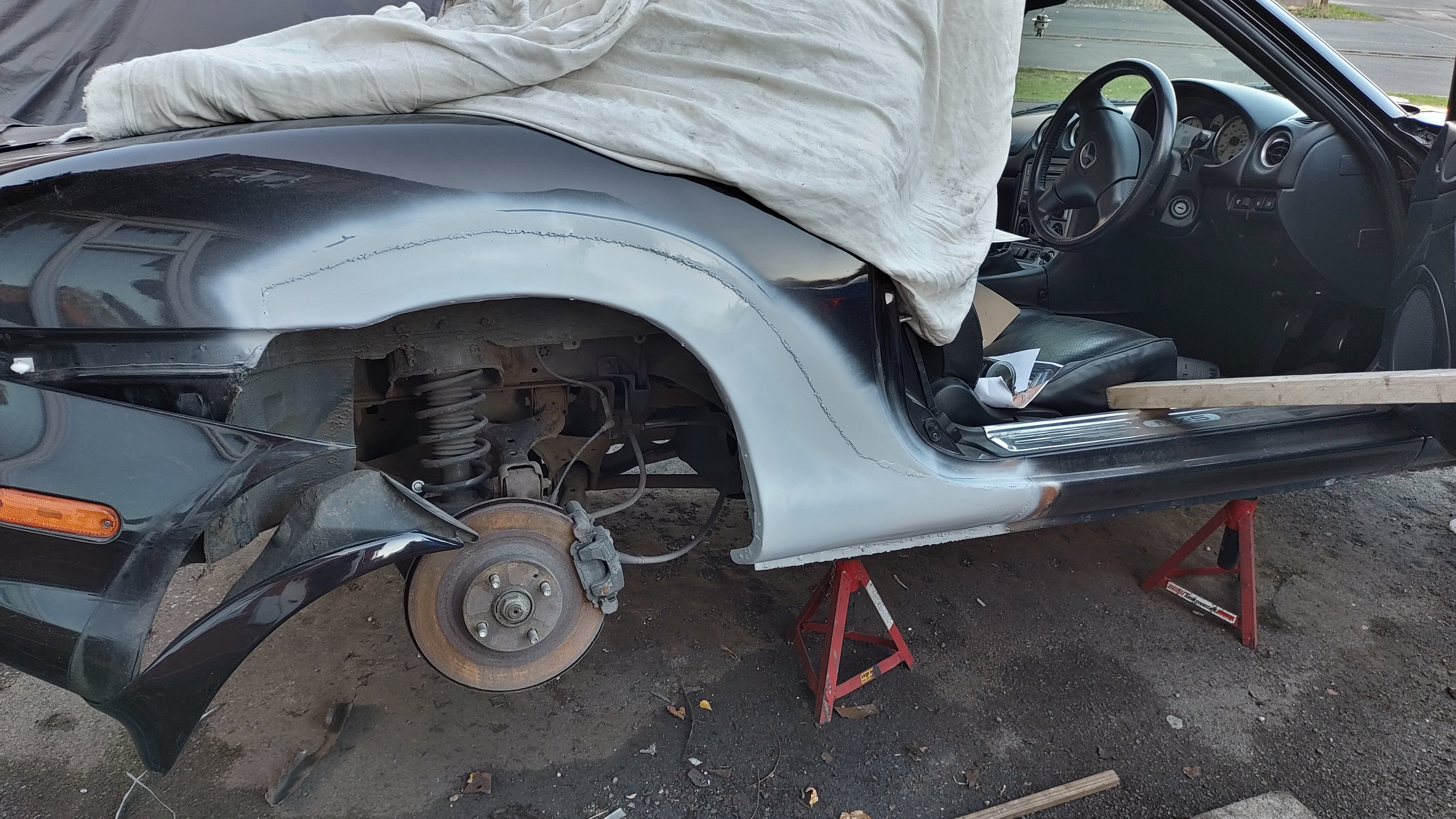

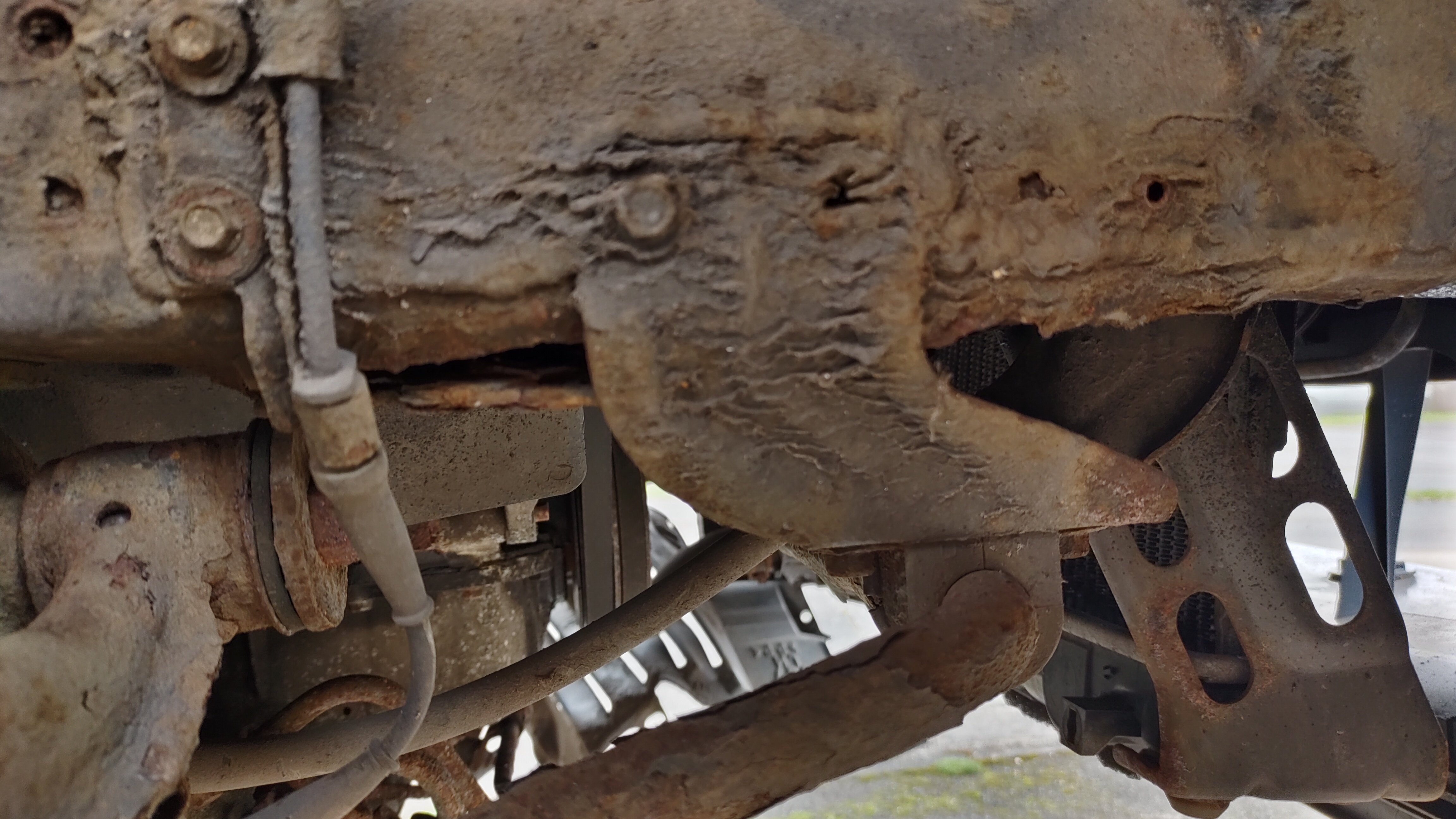

One side done, and the front panel treated where there were a few rust spots. Just need to inject some cavity wax inside when i have finished the other side. Next is onto the LHR arch and then MOT time next month (hopefully)

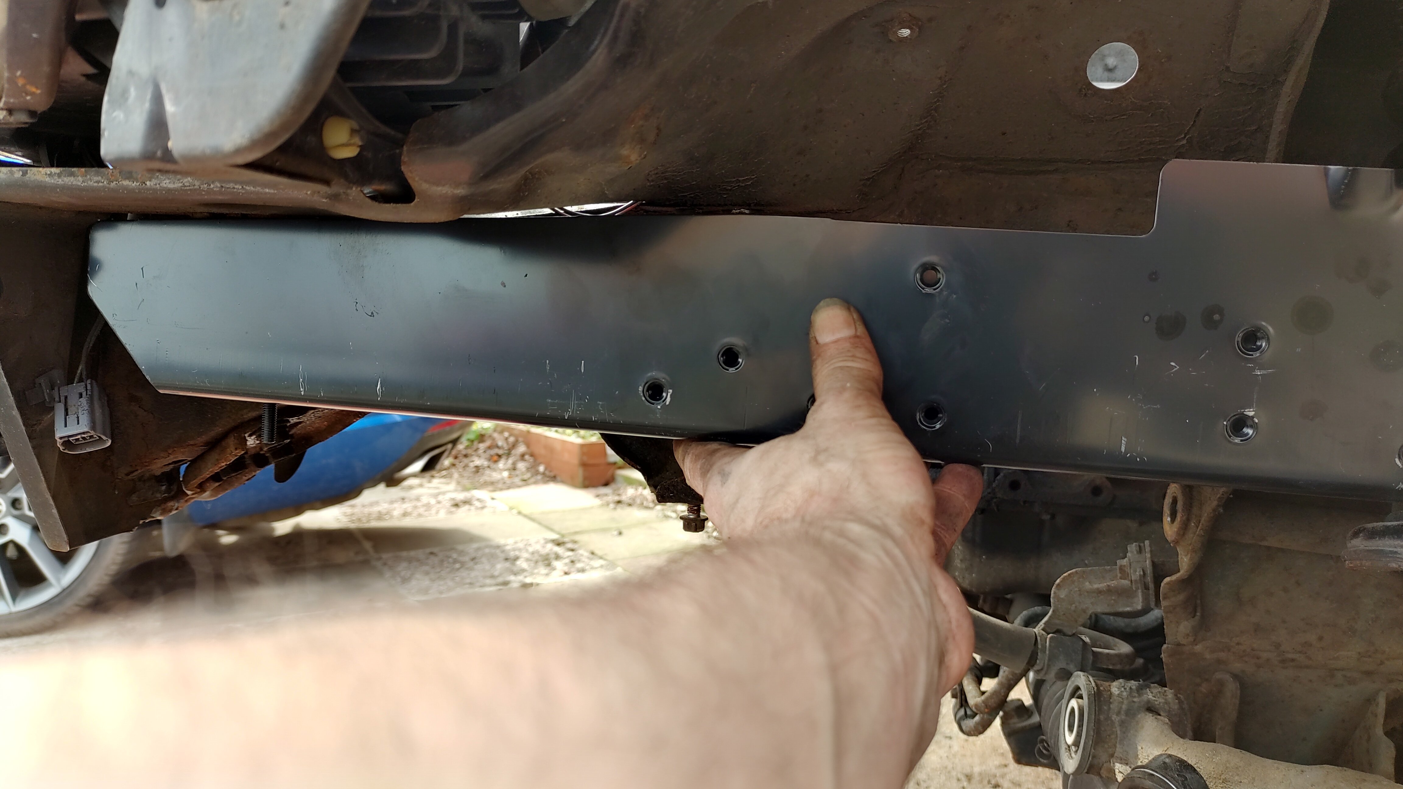

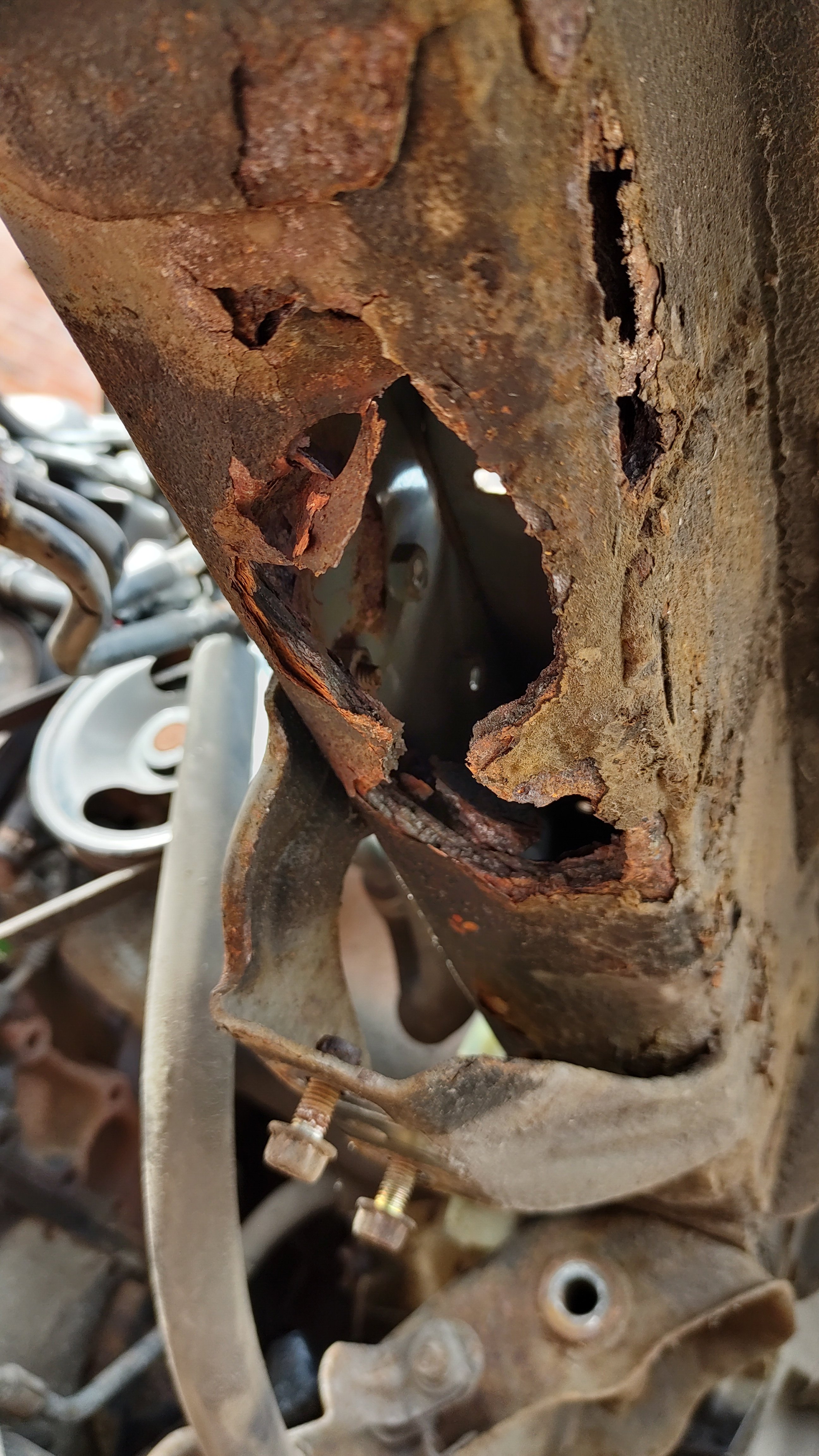

Genuine replacement legs sourced from Germany for less than the ebay ones (even with postage) this is why rot should always be cut out and replaced

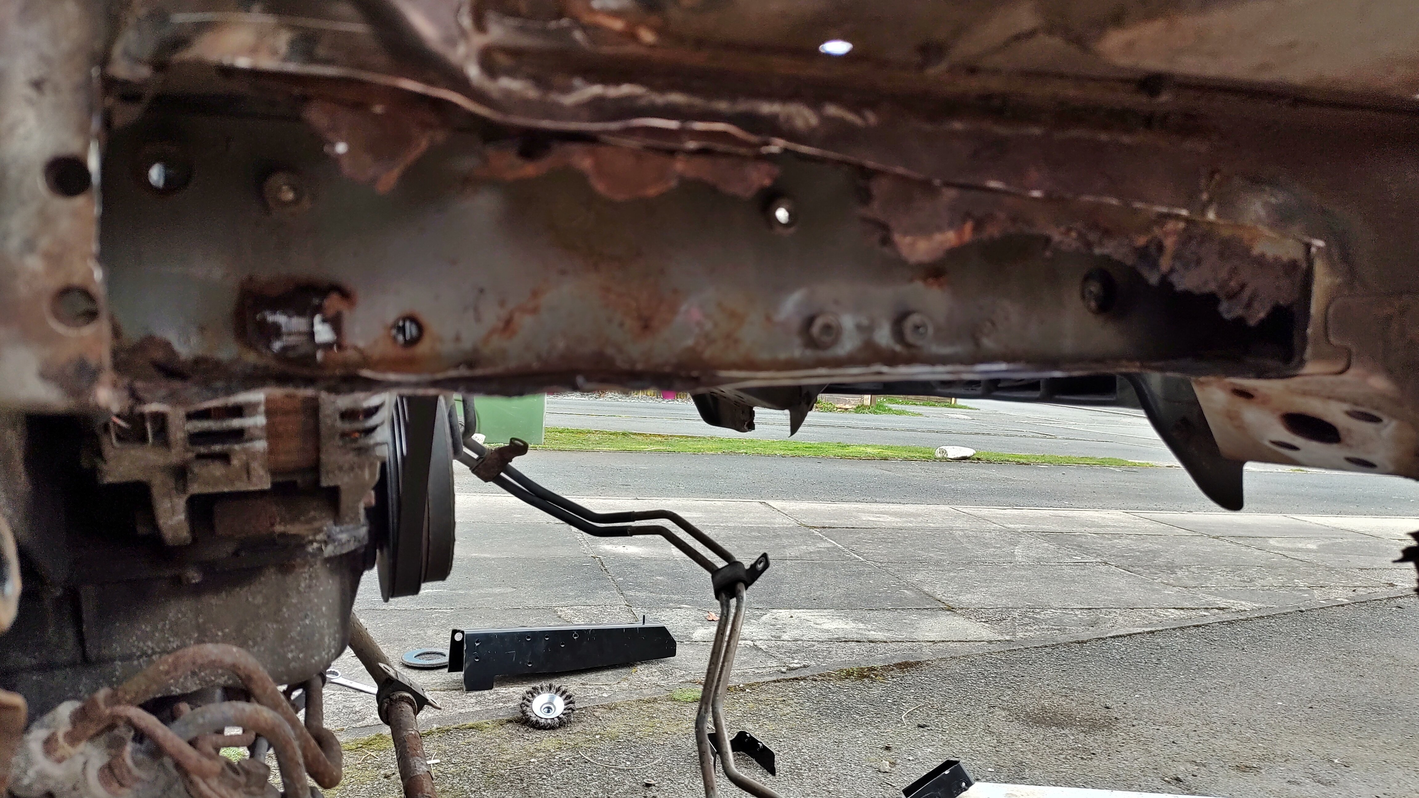

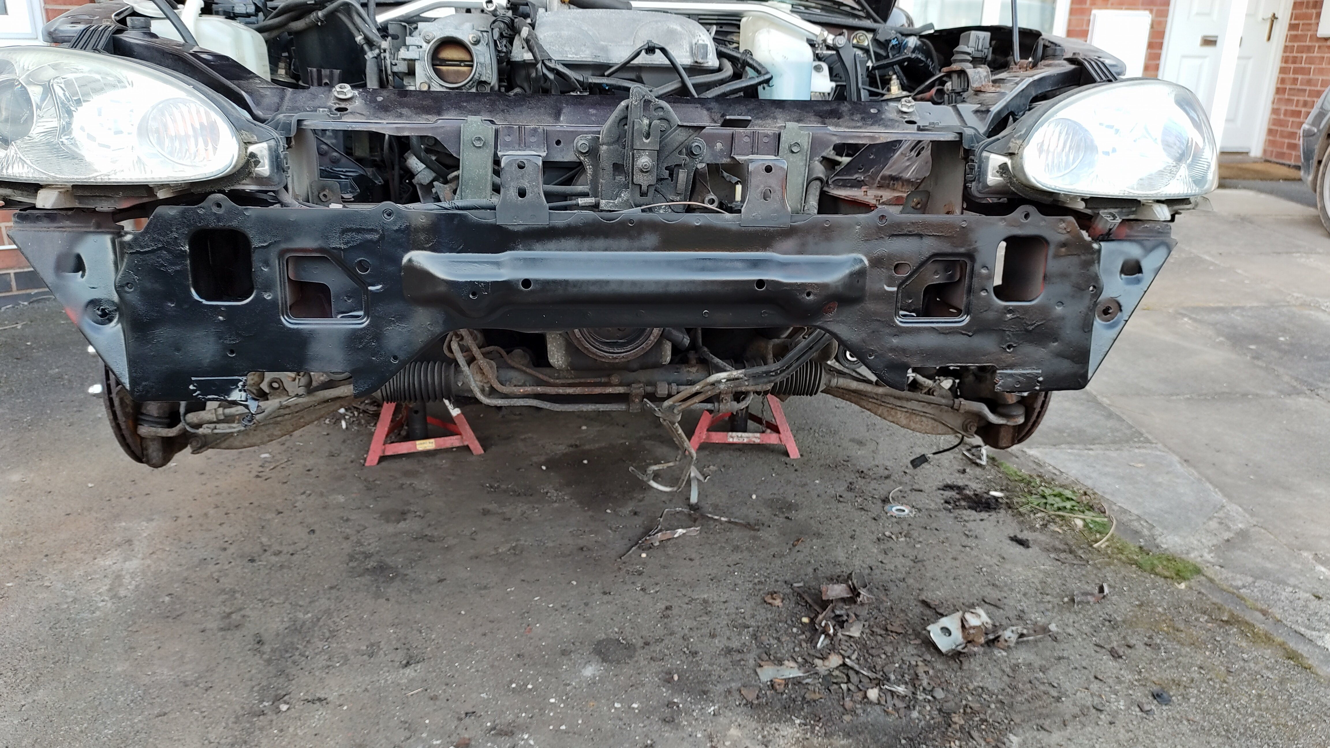

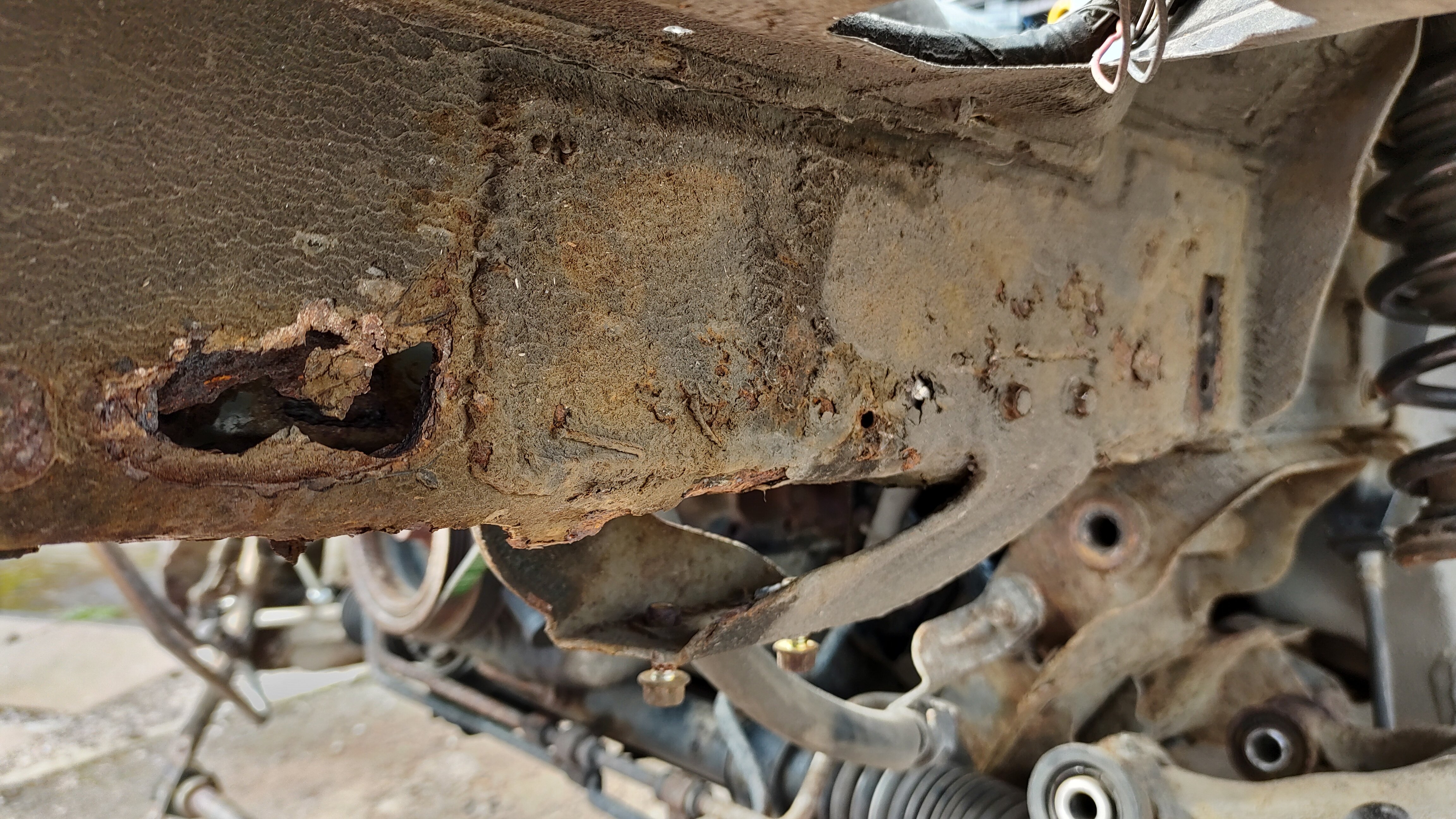

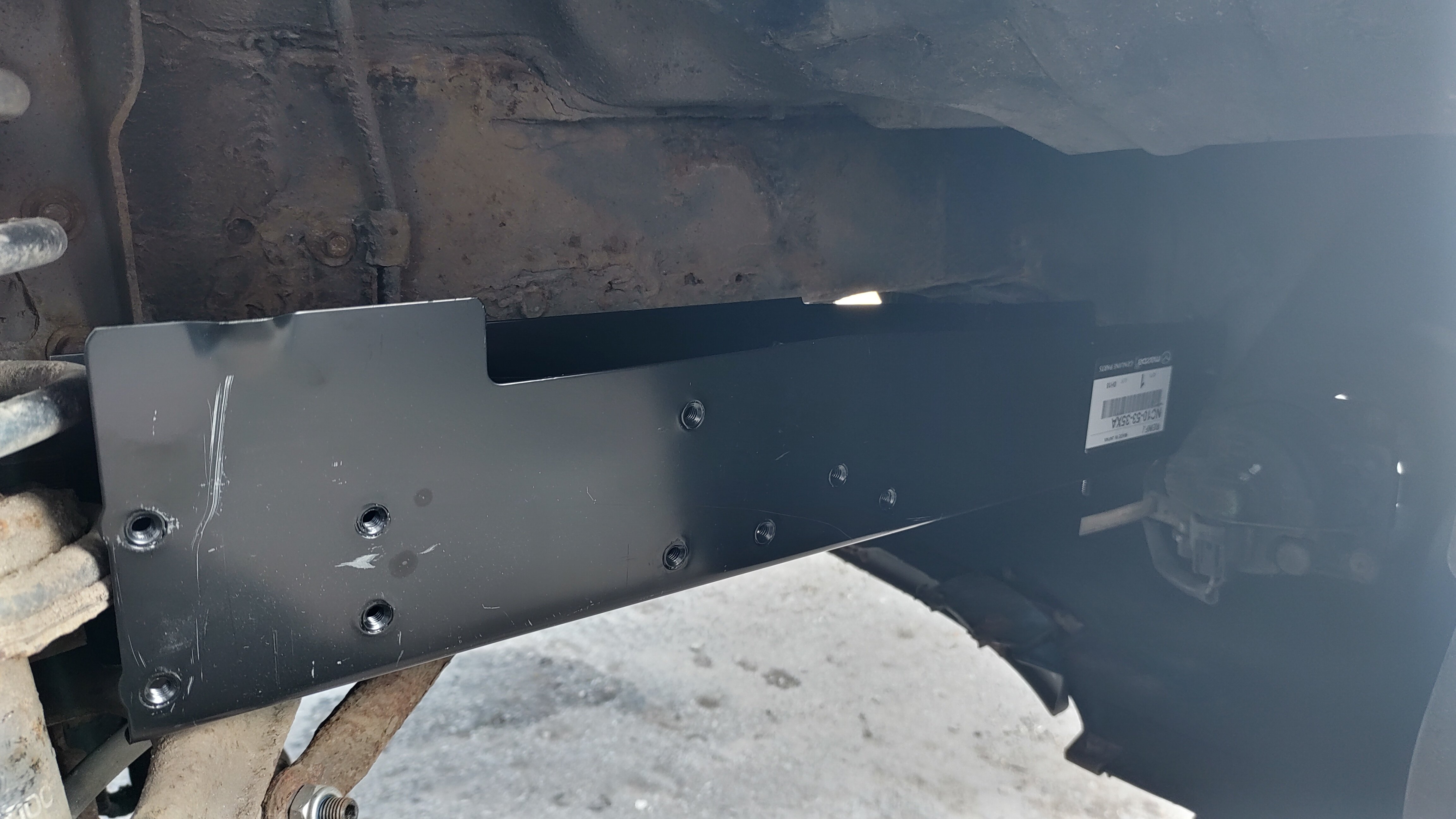

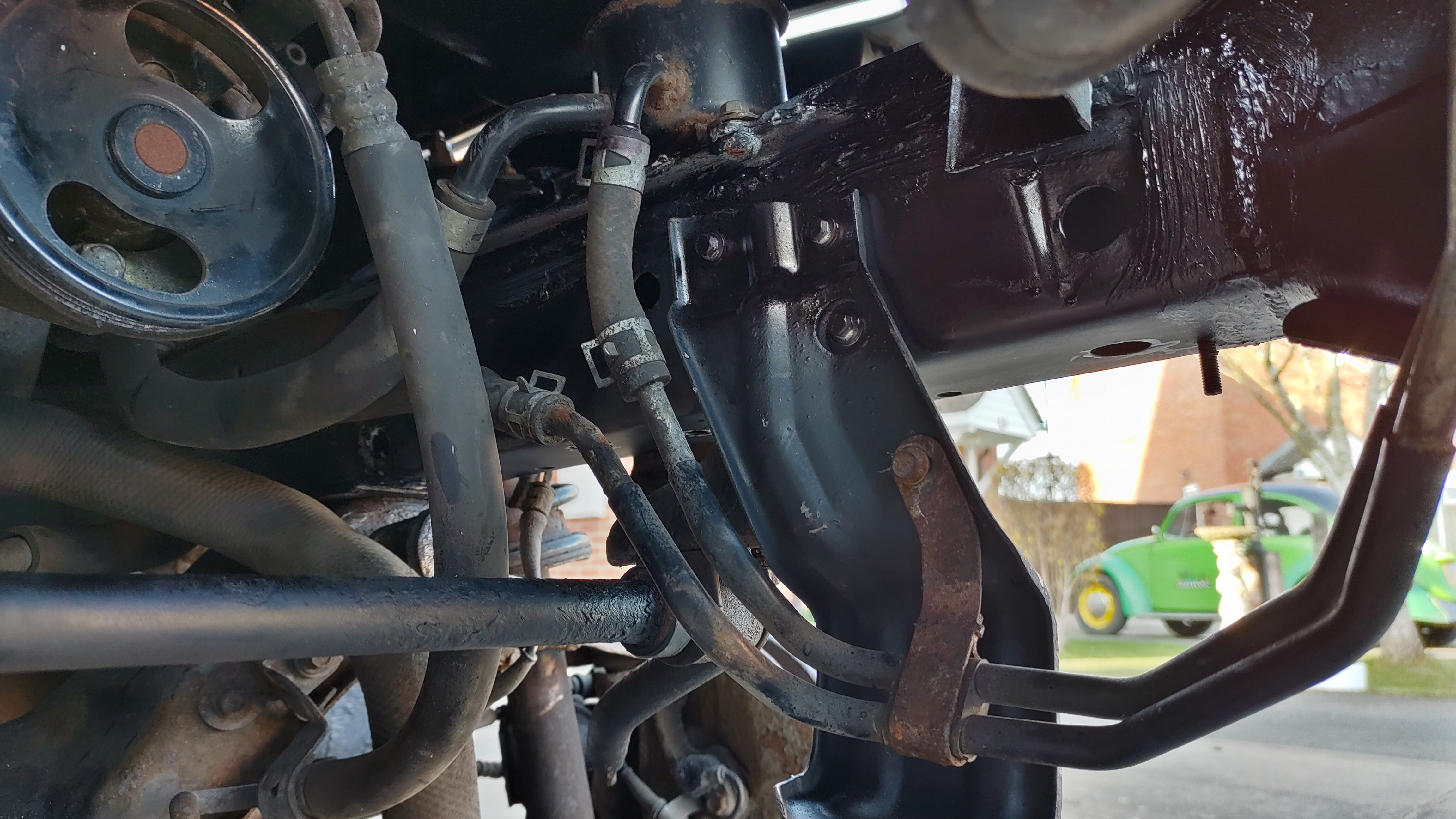

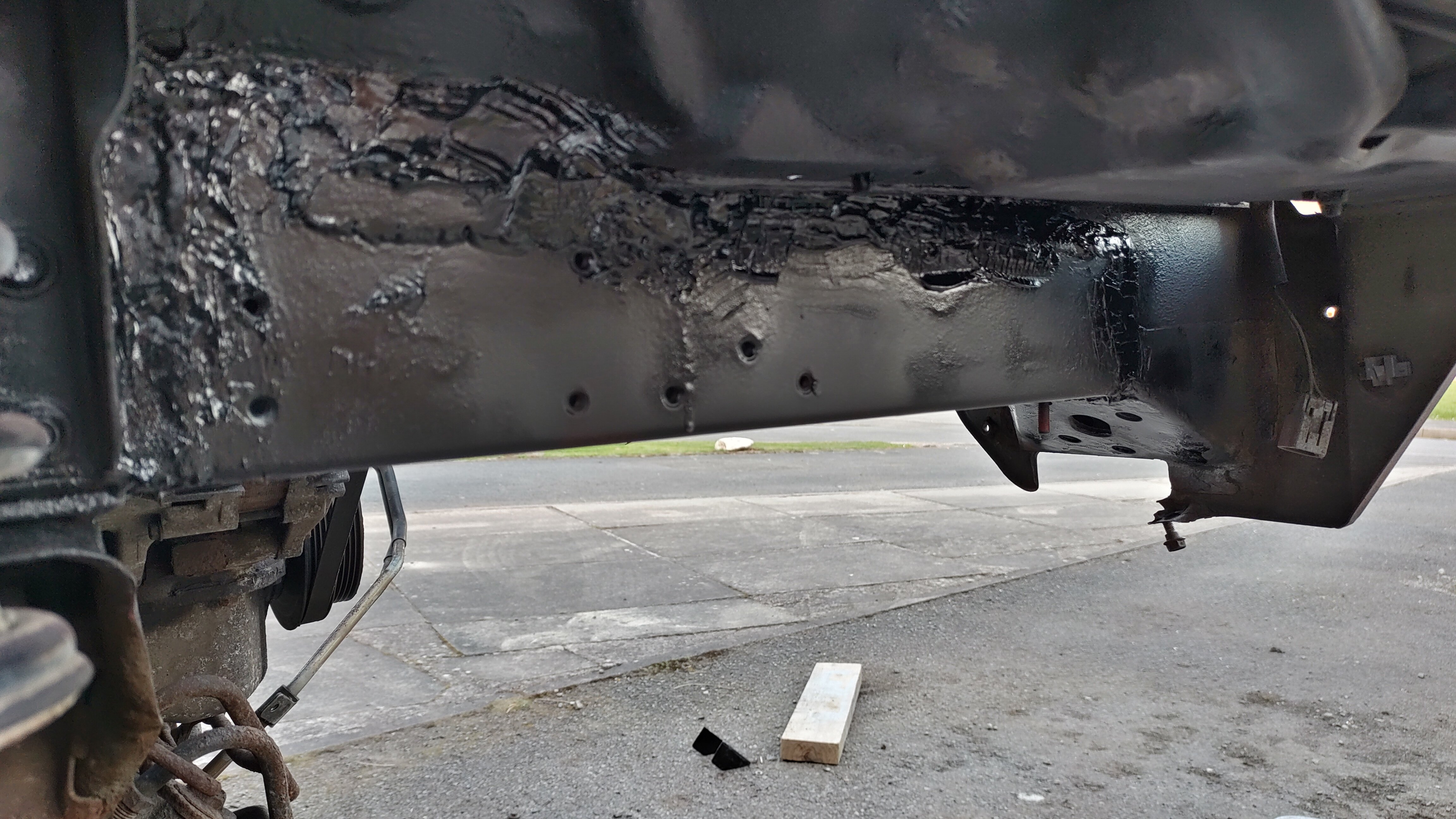

Have now got back into it with the weather being more favourable to work in so have started on the crusty chassis rails. Wings removed for extra space and also so i can treat the rust trap where they meet the front of the sill, thankfully it looks worse than it was, still solid so ground back, rust killer, zinc primer and then red oxide followed by stone guard over the top. Wings will be getting the same treatment and then some cavity wax sprayed into the gap once refitted. Will be coating the whole of the inside of the wing with stone guard etc as well.

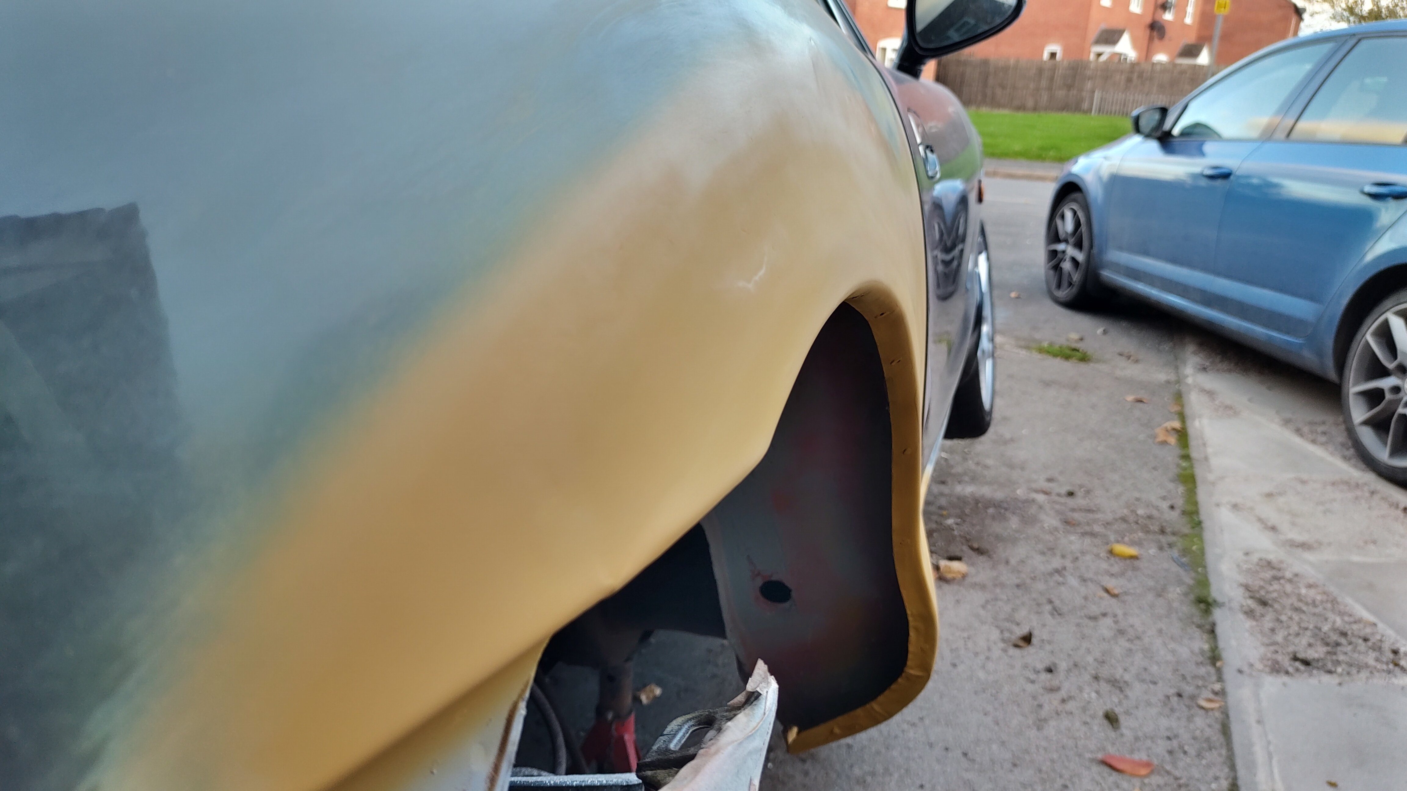

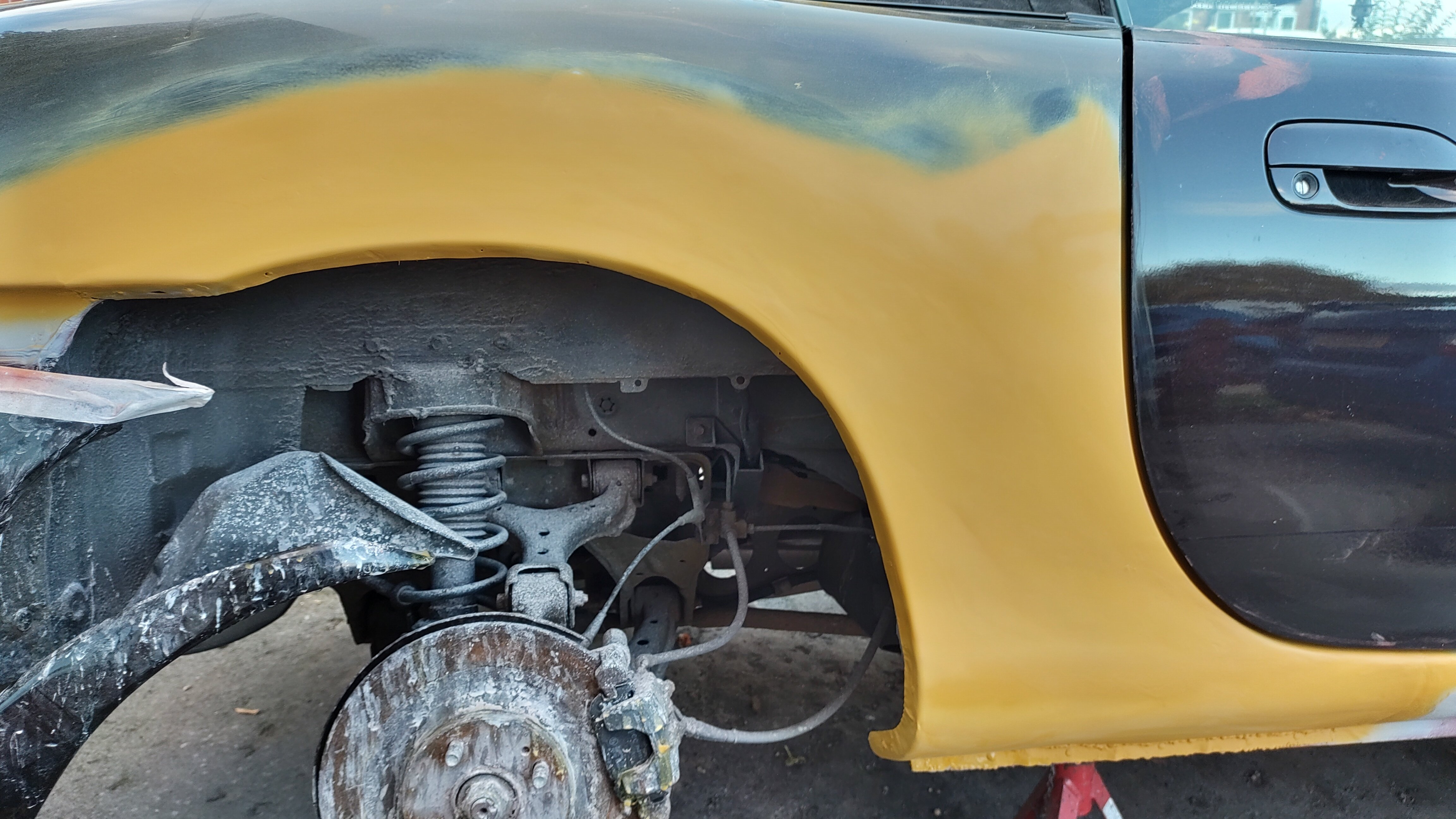

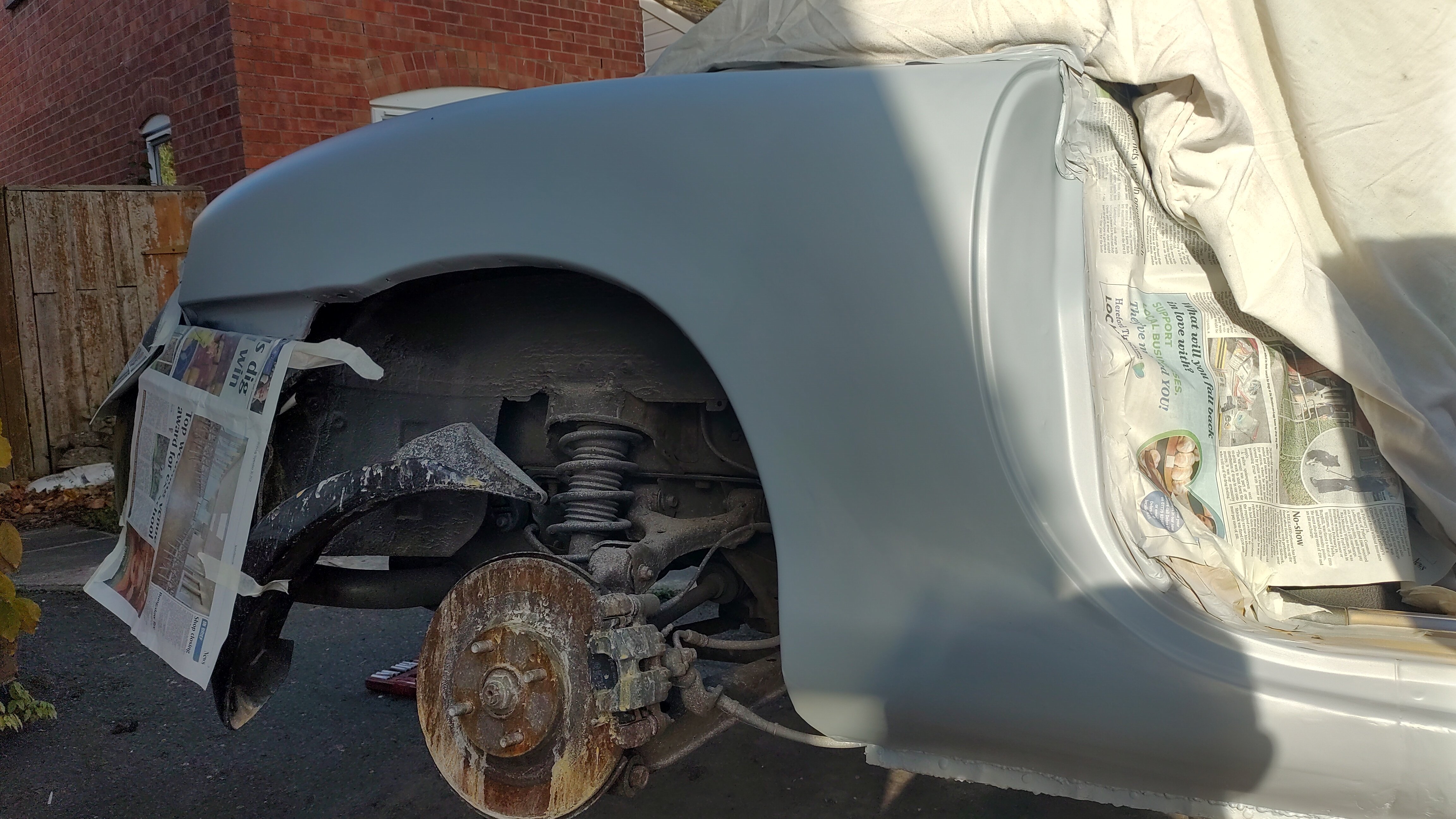

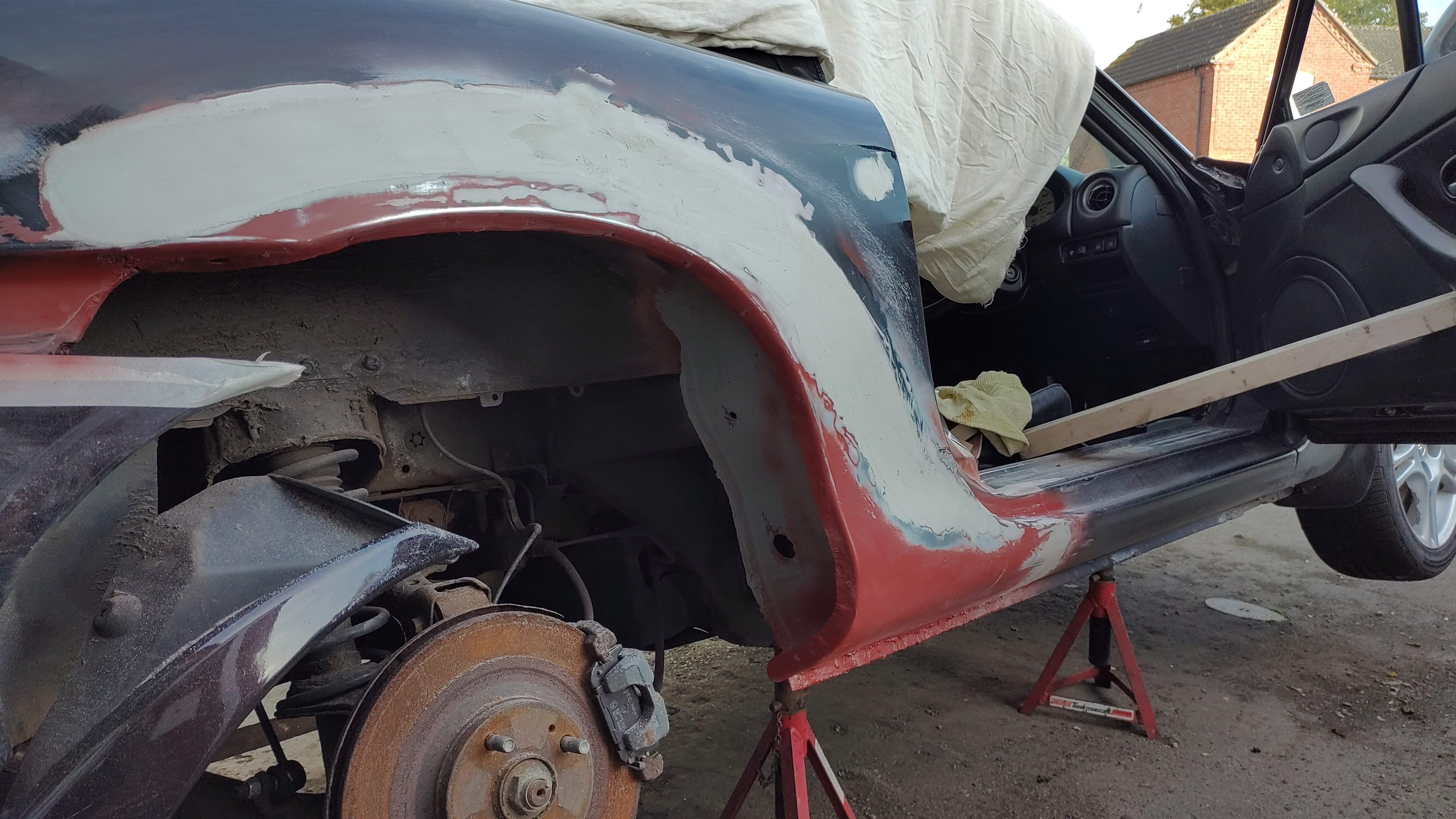

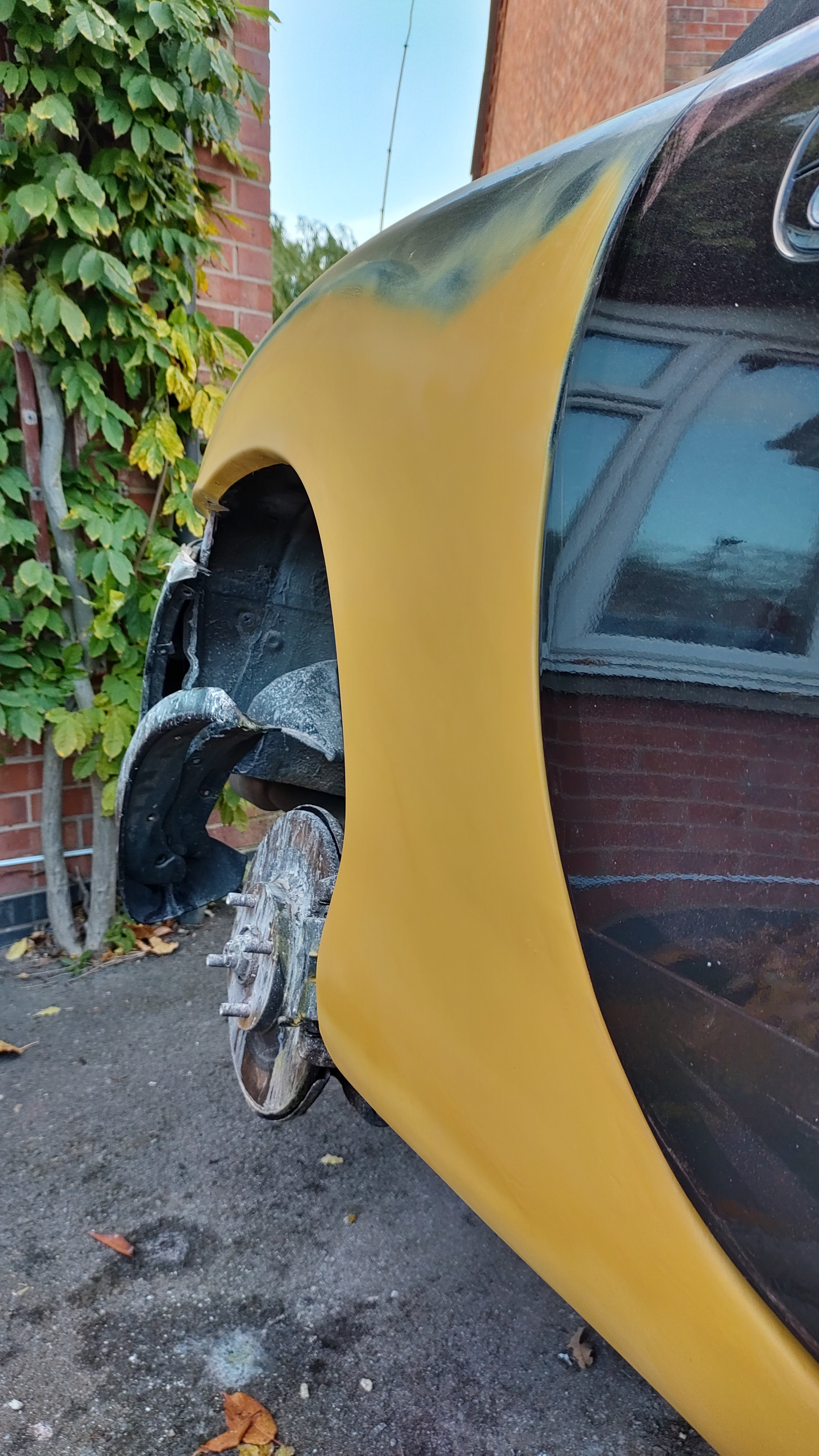

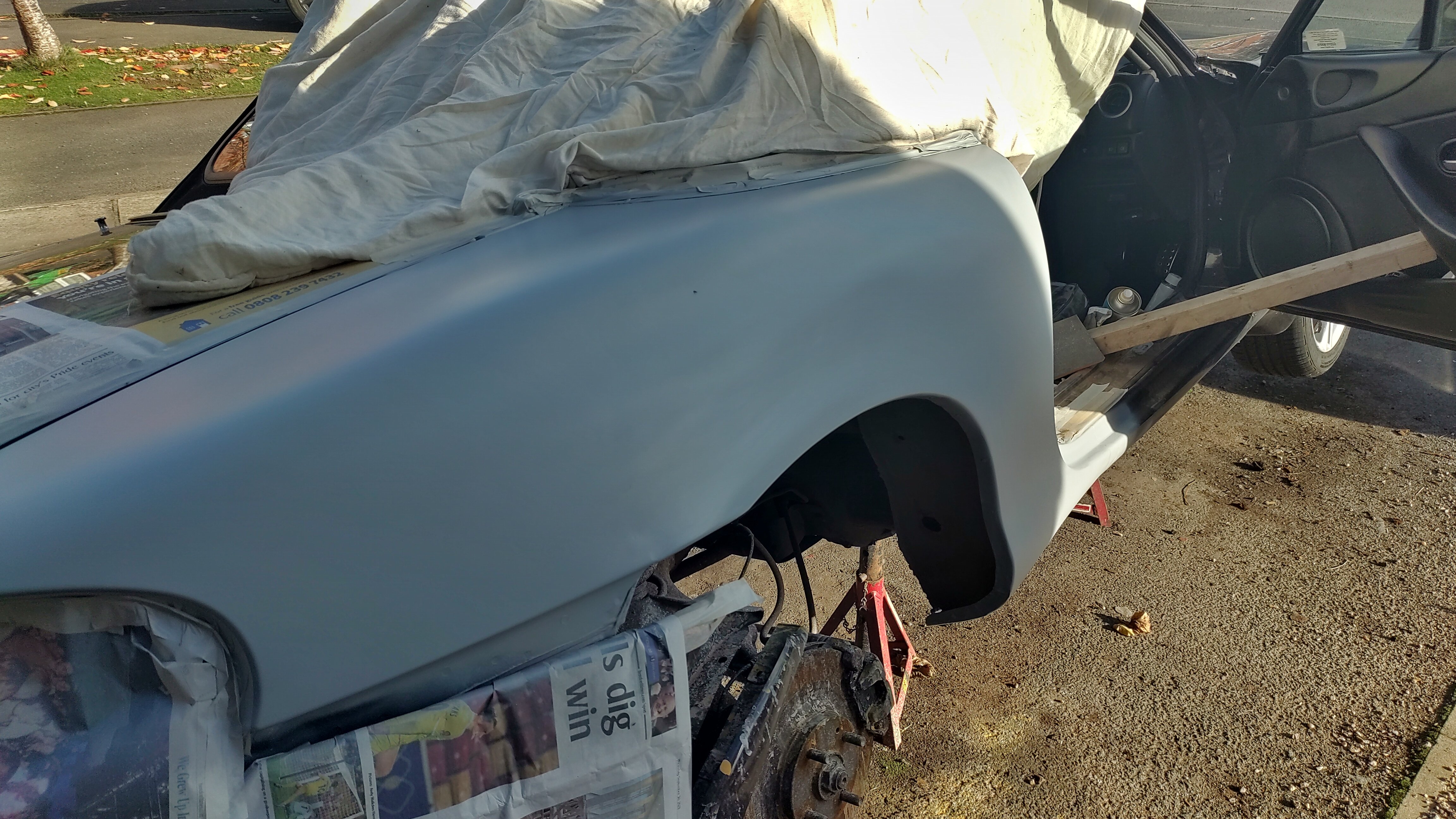

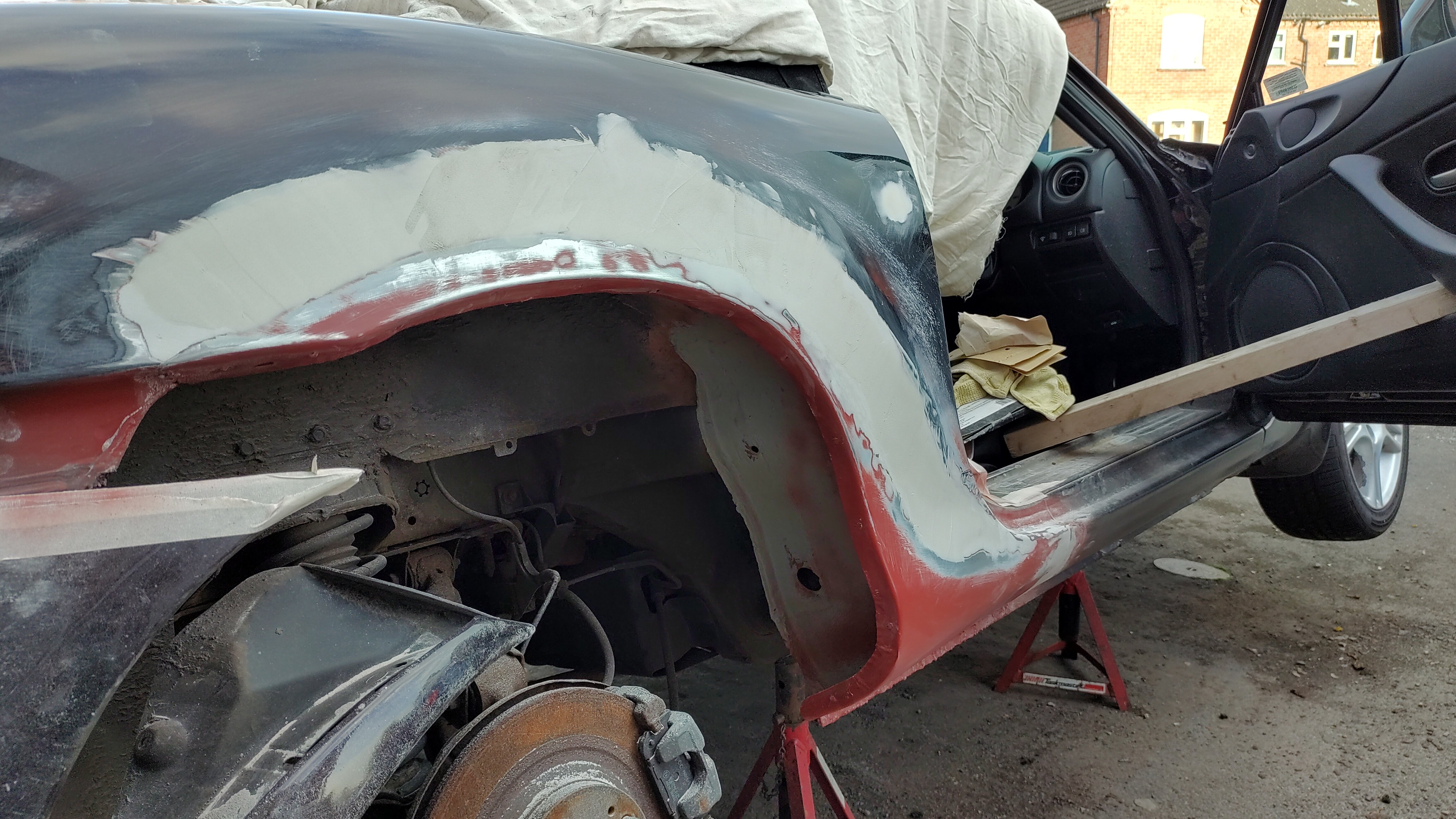

More progress made. Skim of filler, plenty of flatting and a coat of high build primer/filler. Still a few areas that need some flatting and a smidge of filler as they only show up once the primer is on and flatted. Picked up the top coat from a local autopaints specialist yesterday, hopefully get the top coat and lacquer on this weekend as the forecast is looking dry and mild.

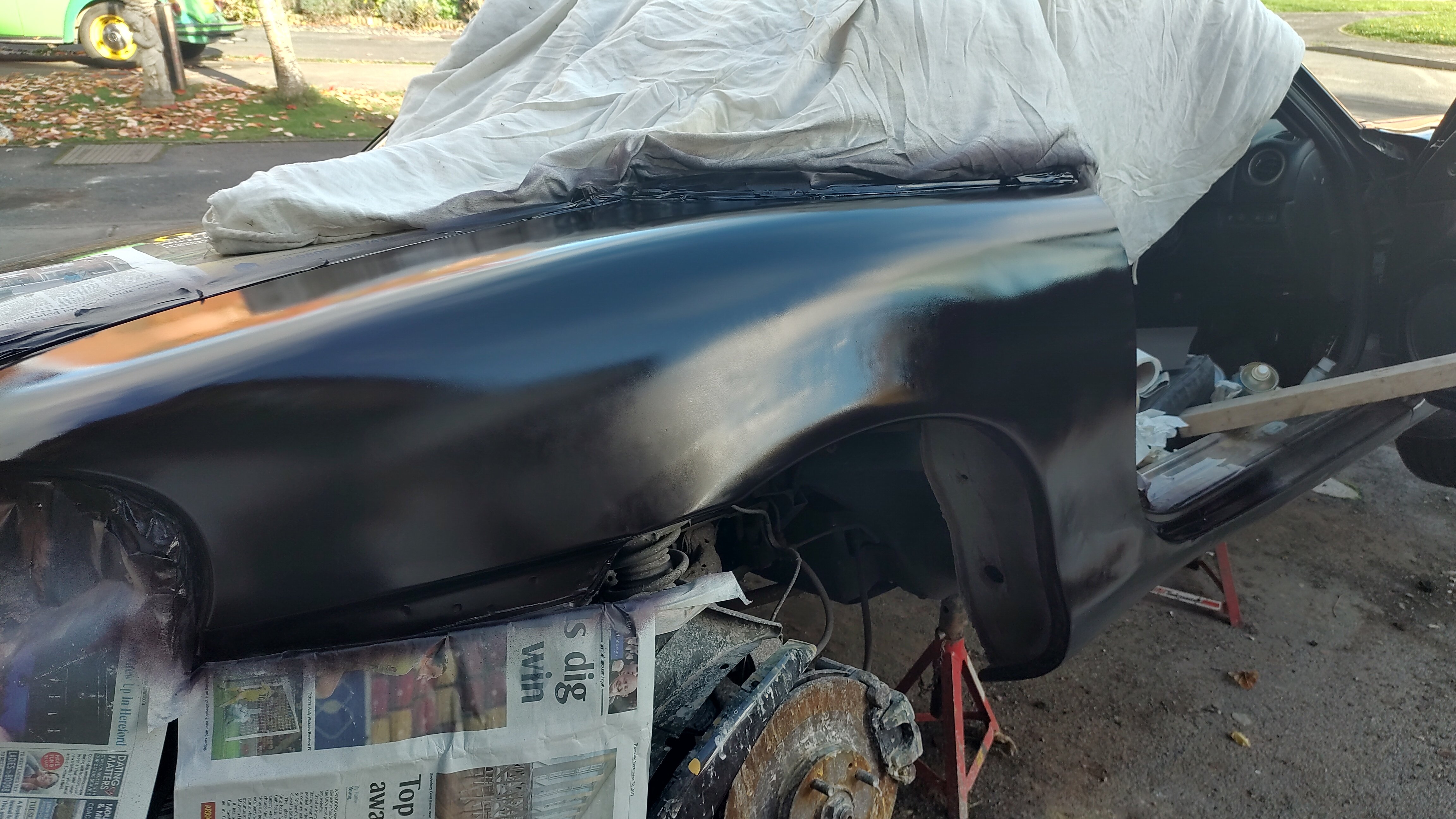

Coated with buzzweld rust encapsulator and a quick outer coat of zinc rich primer to keep the worst of the weather off for now. Fingers crossed for some more dry weather to get some filler work done.
