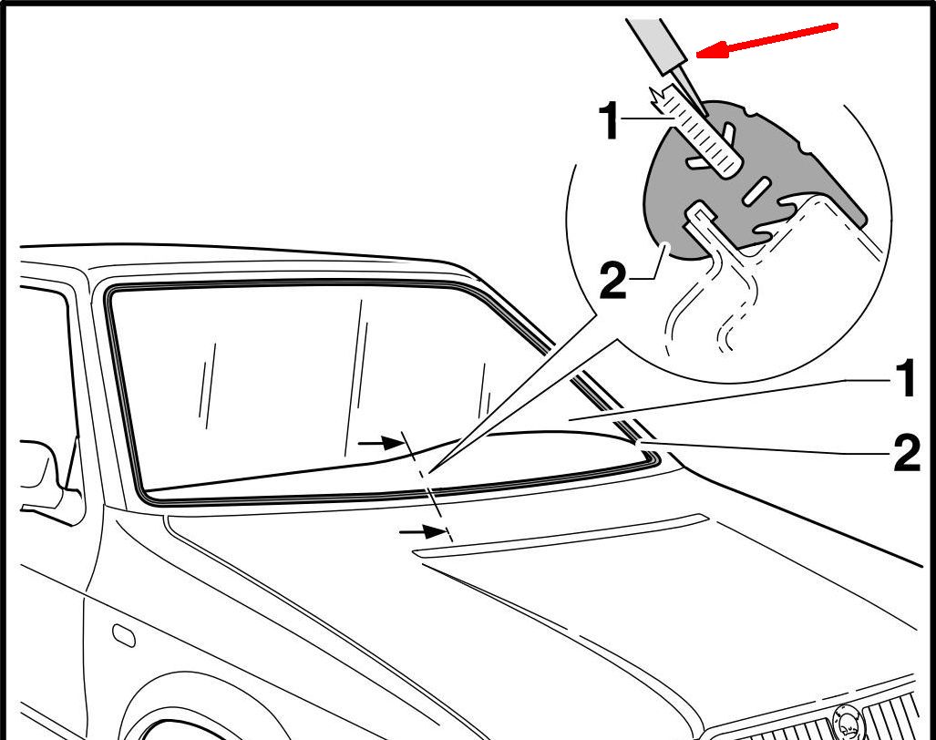

The screen should be removable without smashing it. Skoda didn't use any kind of sealant at the factory. The rubber seal should technically be reusable but you would be easier to cut it and buy a new one. Should be about £20 from a dealer (if they have any). Use plenty of soapy water if you choose not to cut it.
The age of the seal is the core of the problem. The rust behind it is an effect. Reusing the seal doesn't make sense. Smashing the windscreen is equally absurd, unless you plan to buy a new one on purpose.

Yes that's why I said; "technically reusable." Although its not a good idea, if you were stuck, you could. A nice new replacement is obviously the best choice. And if fitted well (and all the rust is dealt with appropriately) you shouldn't need to use anything else (sealant etc).

Skoda put sealant from factory.
I stand corrected. Thanks Ricardo. It must deteriorate over time as well.
