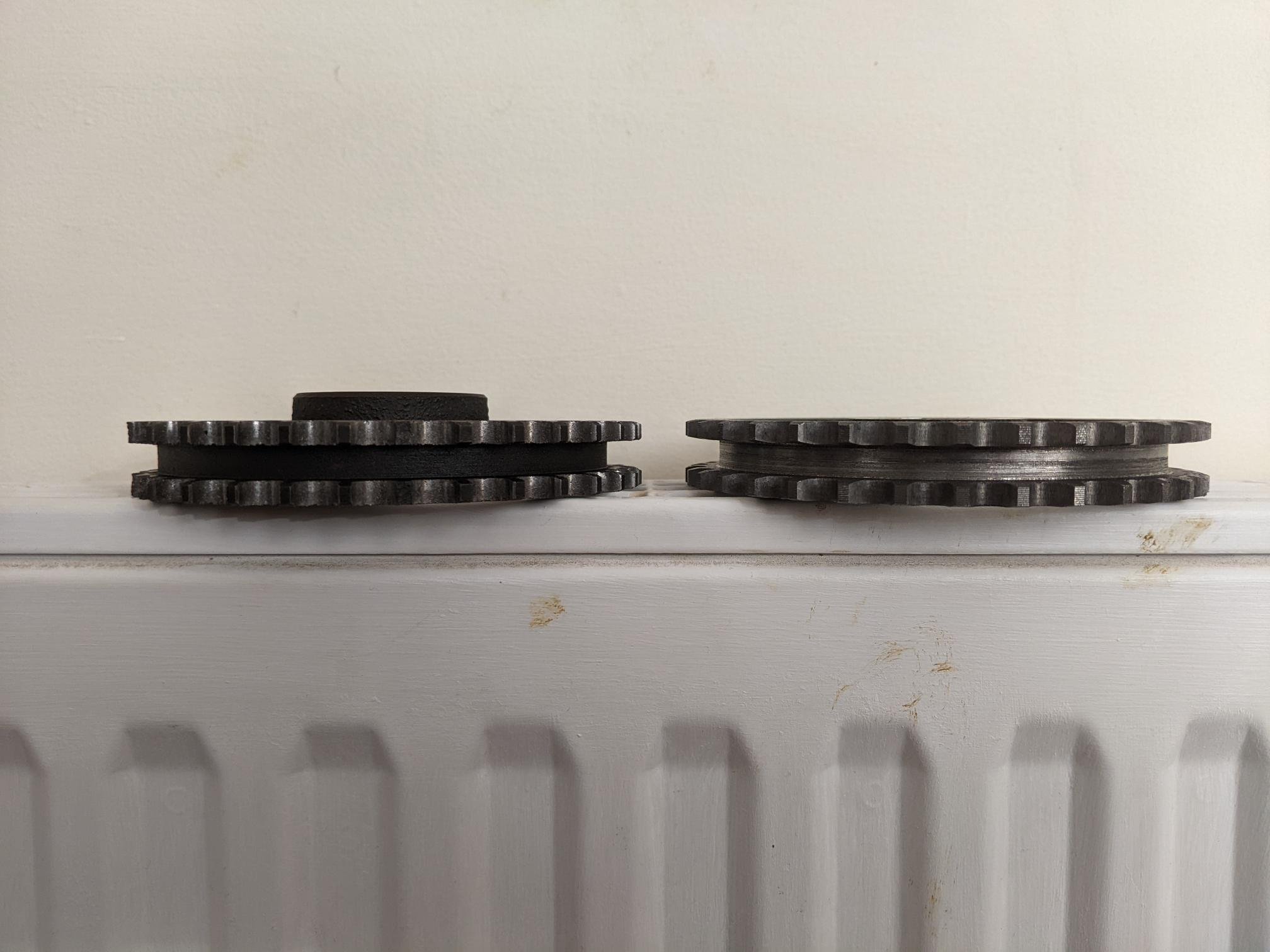

  2. To anyone reading this in future, FAI kit TCK289 does fit the 1999 Felicia 1.3 50 kW engine and matches part number 6U0198026A as recommended above. And my engine does indeed seem to be running OK despite all the metal shavings, fingers crossed it stays that way!

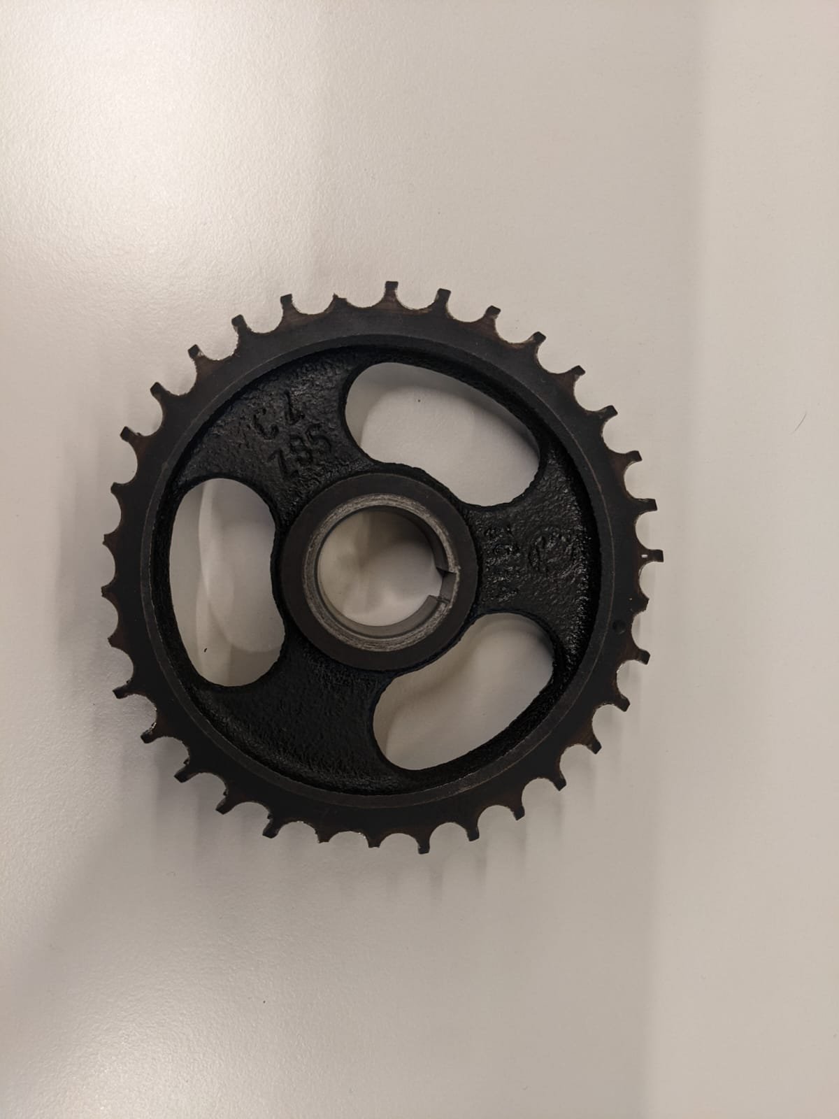

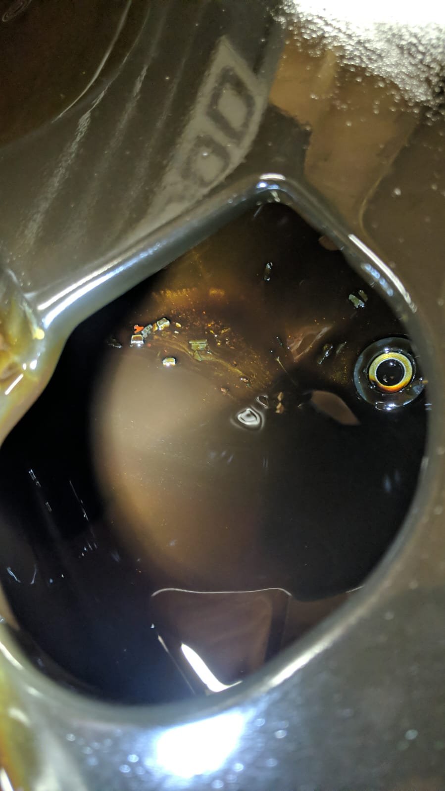

  3. For what it's worth, at 195,000 miles my timing chain looked like this: timing_chain_play.mp4 The large sprocket has lost ~14 teeth, probably not far away from catastrophic failure... And the oil pan is full of teeth and metal shavings: Shockingly, the car was still running fine before I took it off the road to start this maintenance. Hopefully the metal shavings haven't caused further damage to the engine, we'll have to wait and see. In conclusion, the replacement interval is probably less than 195,000 miles 😂

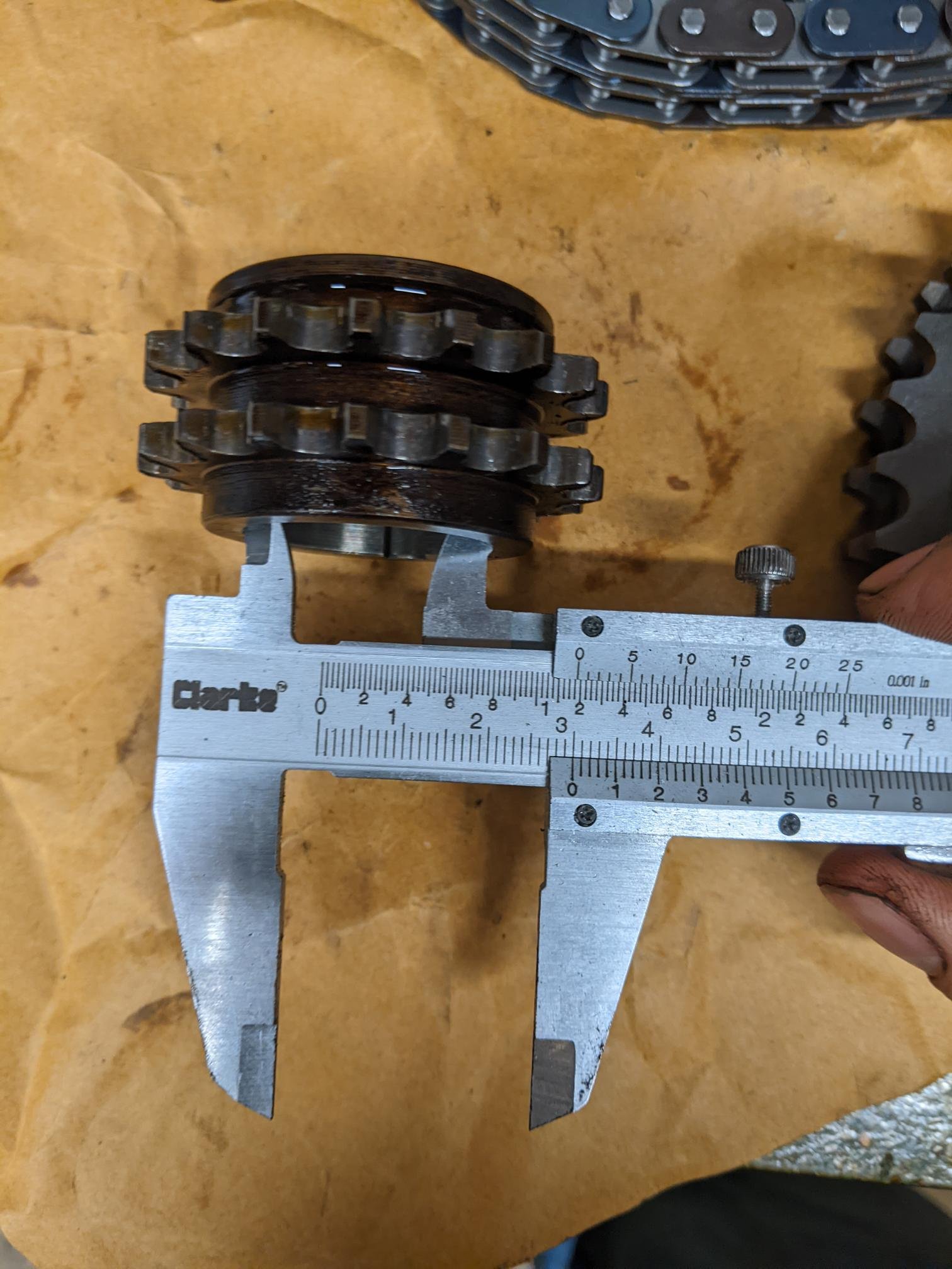

  4. Thanks for the reply. Do you know if a kit matching 6U0198026A will also have the boss on the large sprocket? The FAI kit I have at the moment does have the 30mm sprocket, but still doesn't fit because the large sprocket is wrong. Water pump was done ~5 years ago when the old one started leaking, fortunately seems to still be going strong at the moment.
  5. Hi all, I am in the process of changing the timing chain on my 1.3l 1999 Felicia. The first kit I bought (BGA TC0560FK), the small sprocket had an inner diameter of 32 mm when the original was 30 mm: I therefore returned the kit and ordered a replacement from a different brand (FAI TCK64). The small sprocket from this kit appears to be correct, however the large sprocket is missing a boss on one side and so will not sit in line with the small sprocket (original on left, replacement right): Both of these kits were sold as compatible with the 1.3 Felicia but clearly aren't. Before I waste any more time and money, can anyone recommend a brand of timing kit that they know fits this engine?
