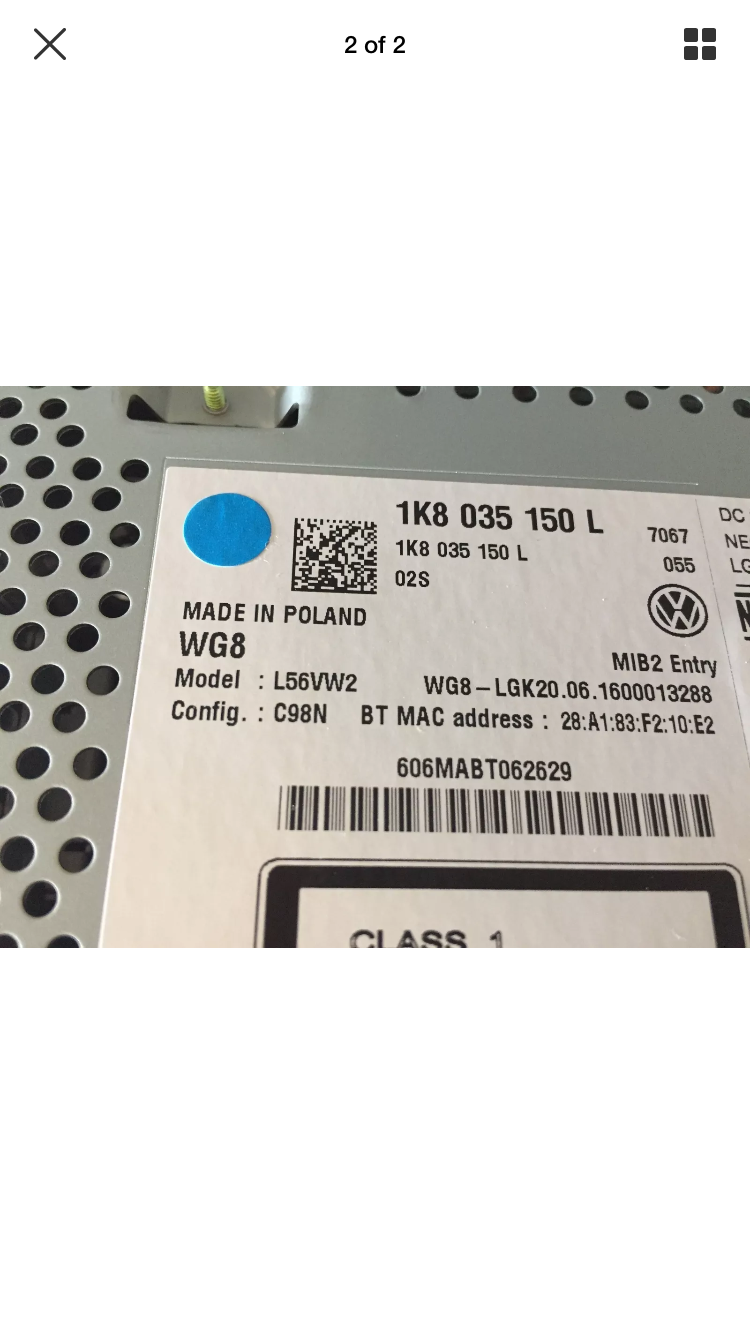

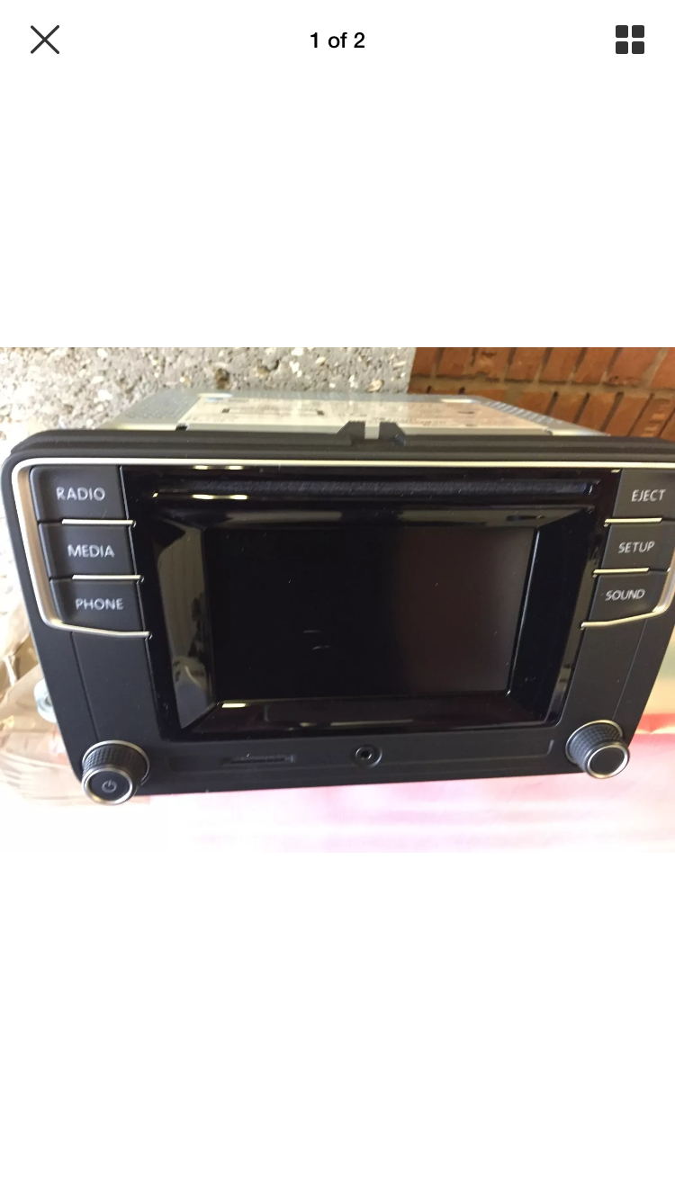

Hi can anybody tell me if this radio wil fit a Octavia 16tdi green line 2011 thanks
It should physically fit.
However, it will need a different quadlock adaptor and being a MIB2 unit you may have issues with component protection which is something the MK2 Octavia doesn't support.
