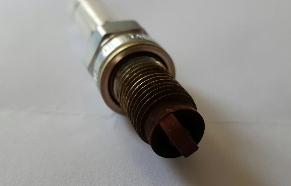

Problem sorted .... I think. Took the car to a good local garage and described the symptoms. The owner spoke of a number of 'performance' cars coming to him with a misfire and all consumers of the local Super Unleaded fuel from our one Super Unleaded pump. In every case, the spark plugs were faulty. Turns out the local filling station is taking in 95 RON Unleaded then adding it's own 'Octane Booster' additive on site and selling it as 97 RON Super Unleaded. When my spark plugs were removed, the tips had a red hue to match the colour of the additive (see pic). New plugs and back to 95 RON fuel and the problem seems to be sorted.
