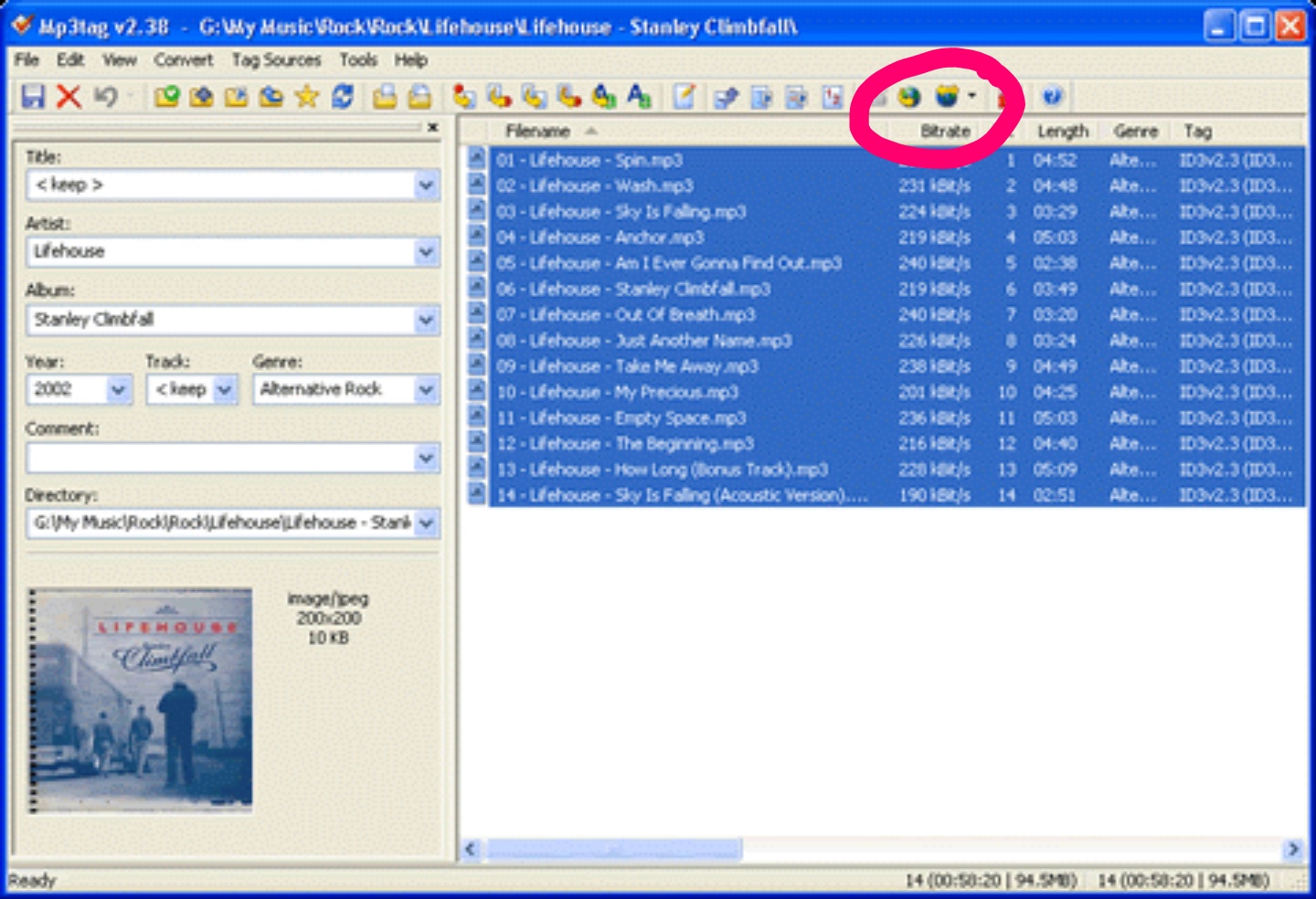

Here's a pic of the net I badly edited on my phone so sorry about that
OK so highlight the track that has no artwork
And first of click the right of these to buttons and make sure it's set to Amazon .Com
If you already have the album name etc it should populate the text box and if you don't you can manually add it here
The next box pops up with Amazon's search results
Click on the album in question and a new window opens
If it's the entire album you have the arrange the tracks from the left box to the right box and click save
I am probably making it sound more complicated than it is but it's very easy.
I'll link you a quick start guide
