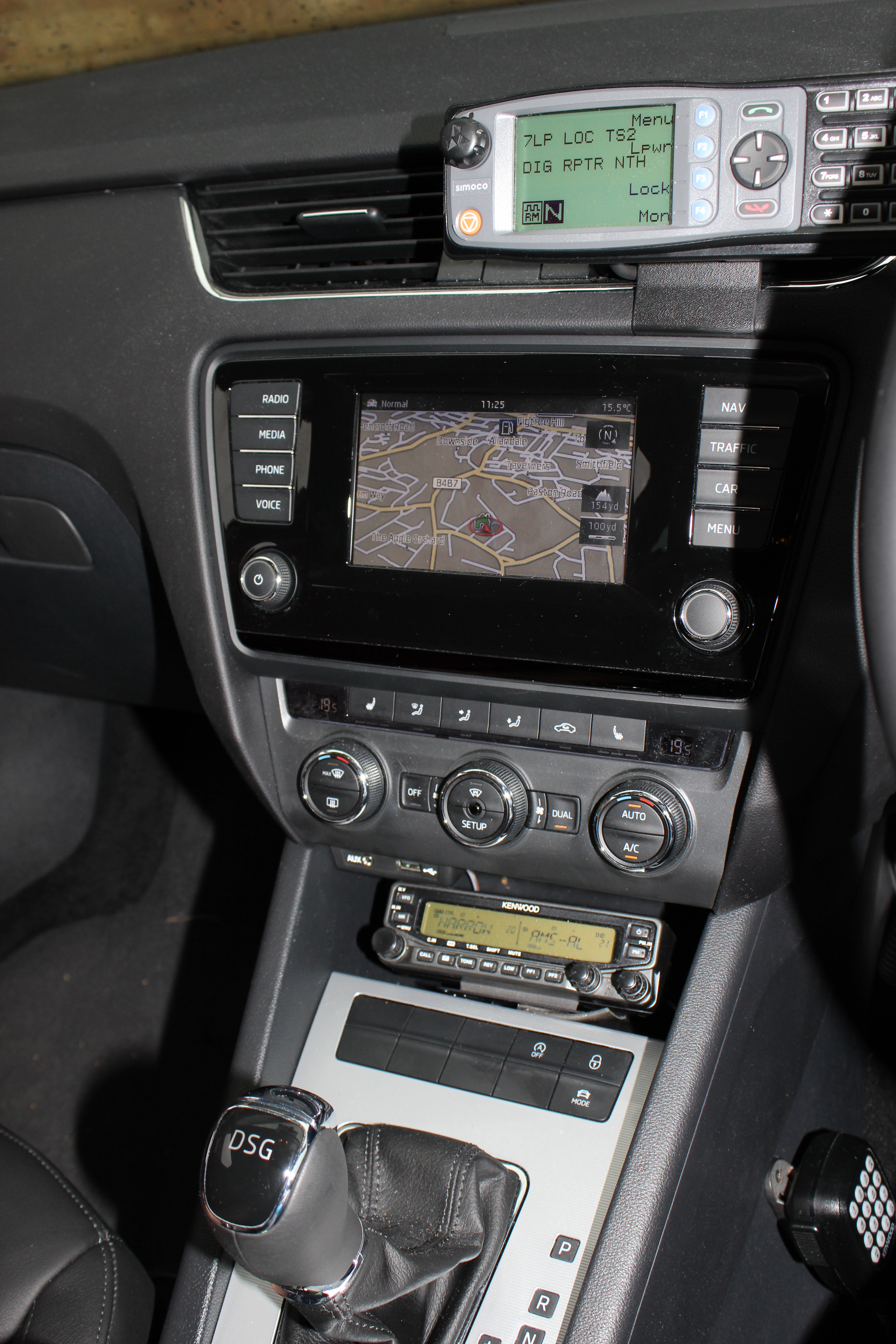

Yes - it's quite easy, I have done it on mine as I have a 2 way radio control head mounted in the shtray location.
Just have to remember how -  So, totally from memory (as I did this over 2 years ago!)
Start with removing trim round the gear lever - just unclips. If auto, there is a connection unde rpanel for gear indicator light.
That uncovers 2 screws in front of gear lever that releases the ash tray assembly that can be slid backl and lifted out - there's probably a light that you have to unclip?
Side panels are 2 part - the lower unclips after releasing a screw at the front - unclip carefully!
Hope that helps.
John.

You have to remove the complete panel that has the gear gaiter in the middle and the drive mode switch etc. at the front. The 2 screw are located under the front of that panel.
If you can't see how to do that, I will check on my car at lunchtime.

you pull the whole lot out together - the section with the switches in it has 4 retaining clips to the centre of each area.  it just lifts up with a gentle persuasion
