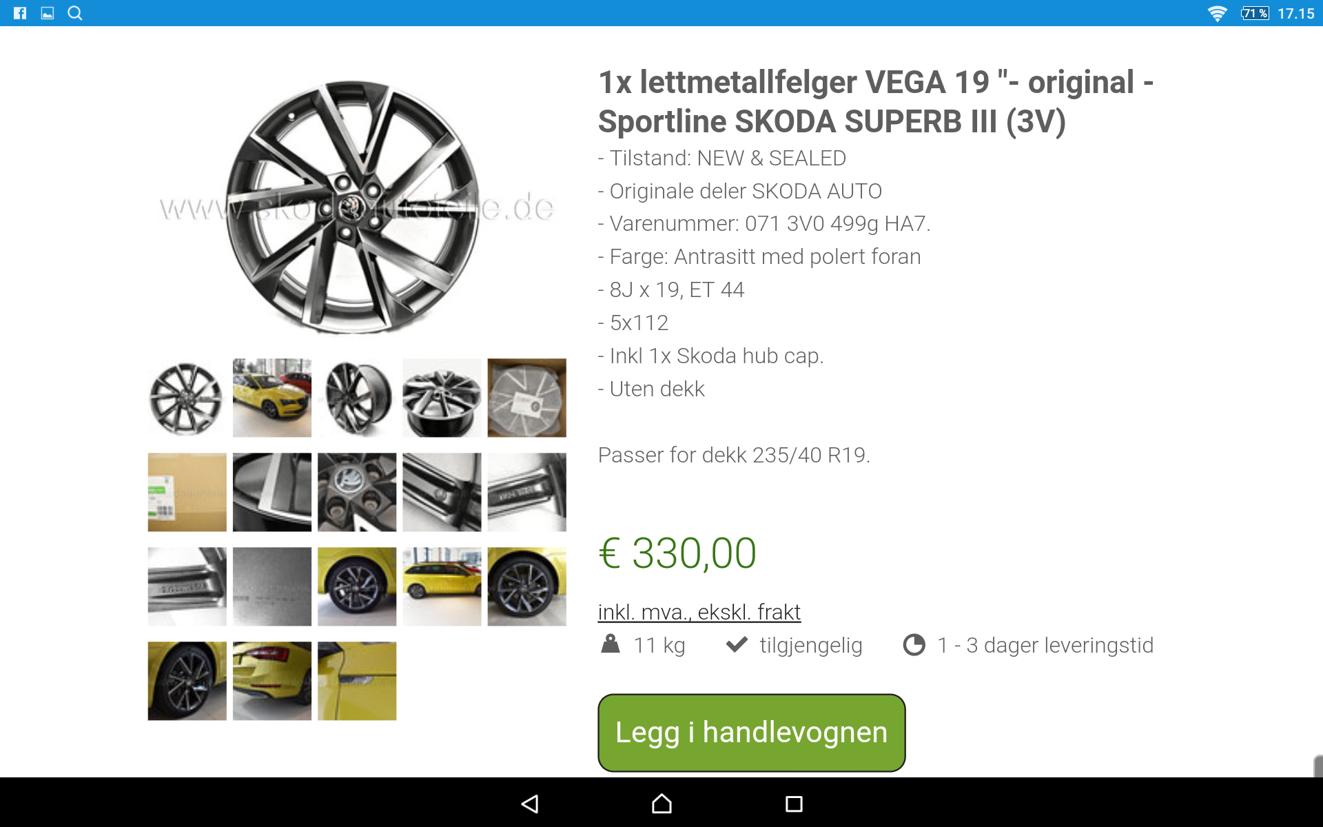

The Vega dimension is 8j x 19, ET 44. They are 5x112, center bore is 57.1 mm.

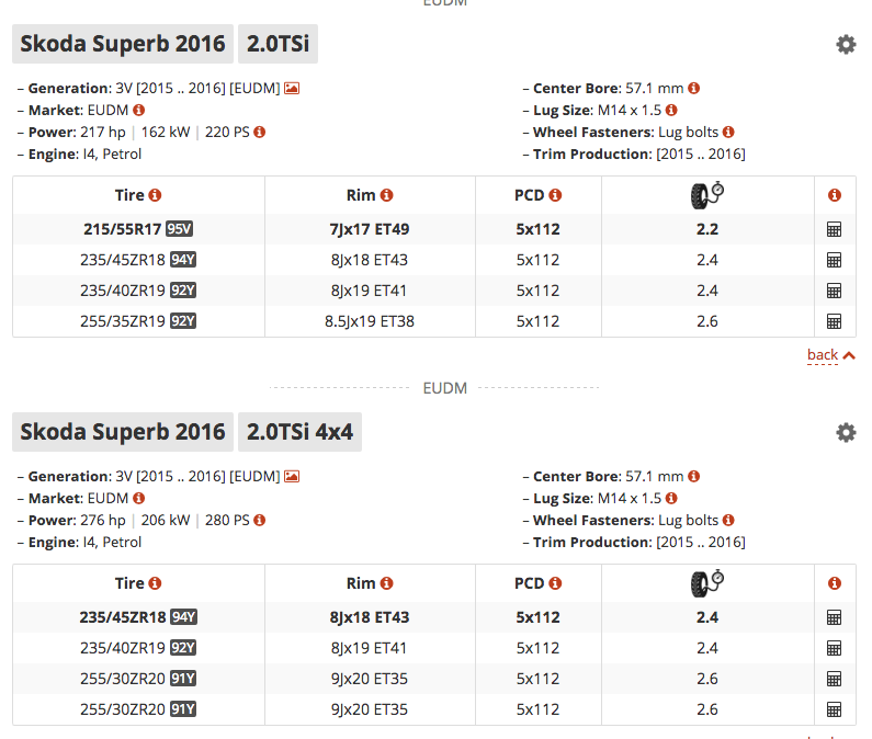

I found this chart on wheel-size.com : It has all the sizes I need, as long as it's accurate! (And already fatzy says different!) It tells me:
My Vega's are 8Jx19 ET41 with 235/40ZR19 tyres. So, I could go with:
7Jx17 ET49 with 215/55R17 winter tyres or
9Jx20 ET35 with 255/30ZR20 summer tyres, for instance.
Your Vega alloys are as I said. Information you find at a retailer is not the alloy specification your car has been delivered with, they are variants.
Edited by fatzy
That's what I was afraid of. Thanks!
It is nothing to worry about, variants occures all the time. You just have to know what to look for, which ones are acceptable and the limits
^^^ This
