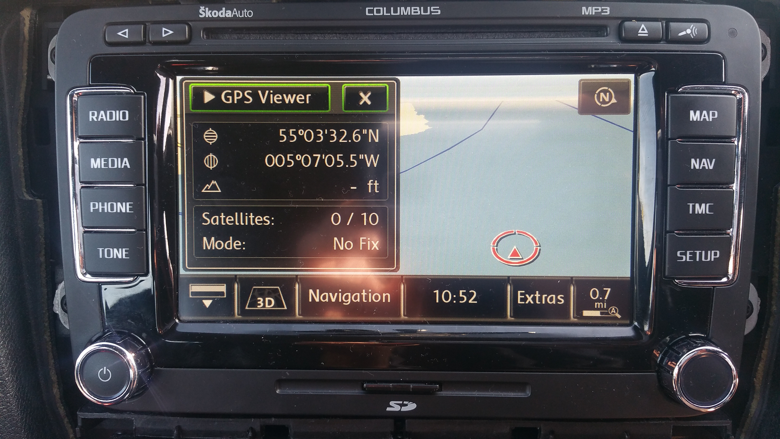

Press the "Nav" button, and then touch "Current position" and see how many satellites it can see and has locked onto. It'll be something like 7/11 or 0/11 or 0/0 maybe.
When I changed the gps receiver it went to 3 but never moved my location. Siting at 0/11 this morning.

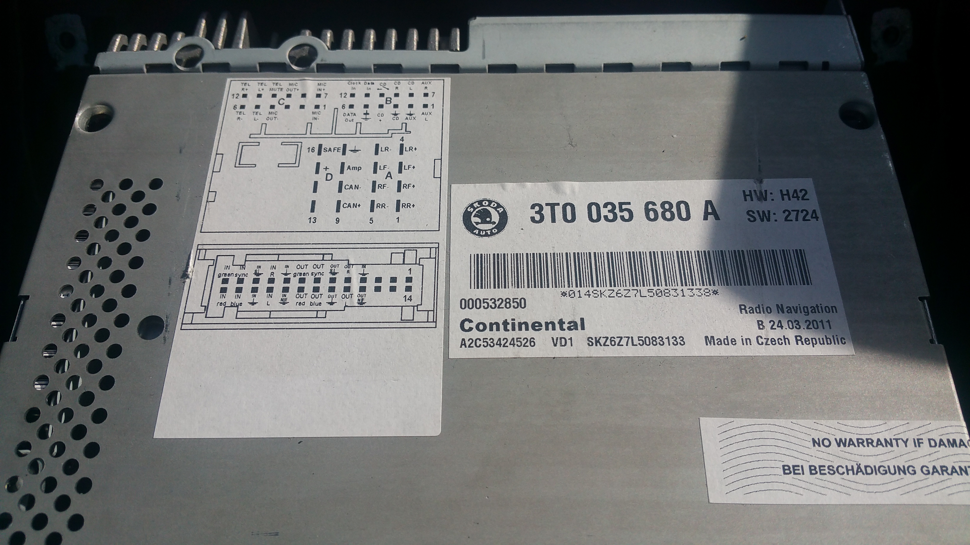

Sounds like a faulty gps, that's the usual one. But as you've changed it then it can only be the radio board inside. Take a pic of the front of the unit (or better still the data label on the top of the unit) and post it up here.
I will do shortly. Is it totally goosed or repairable. Whyis only the gps bit broke the rest of the unit is fine
It's possibly repairable, depending on the pic of the data label (and if I have spares for it).
