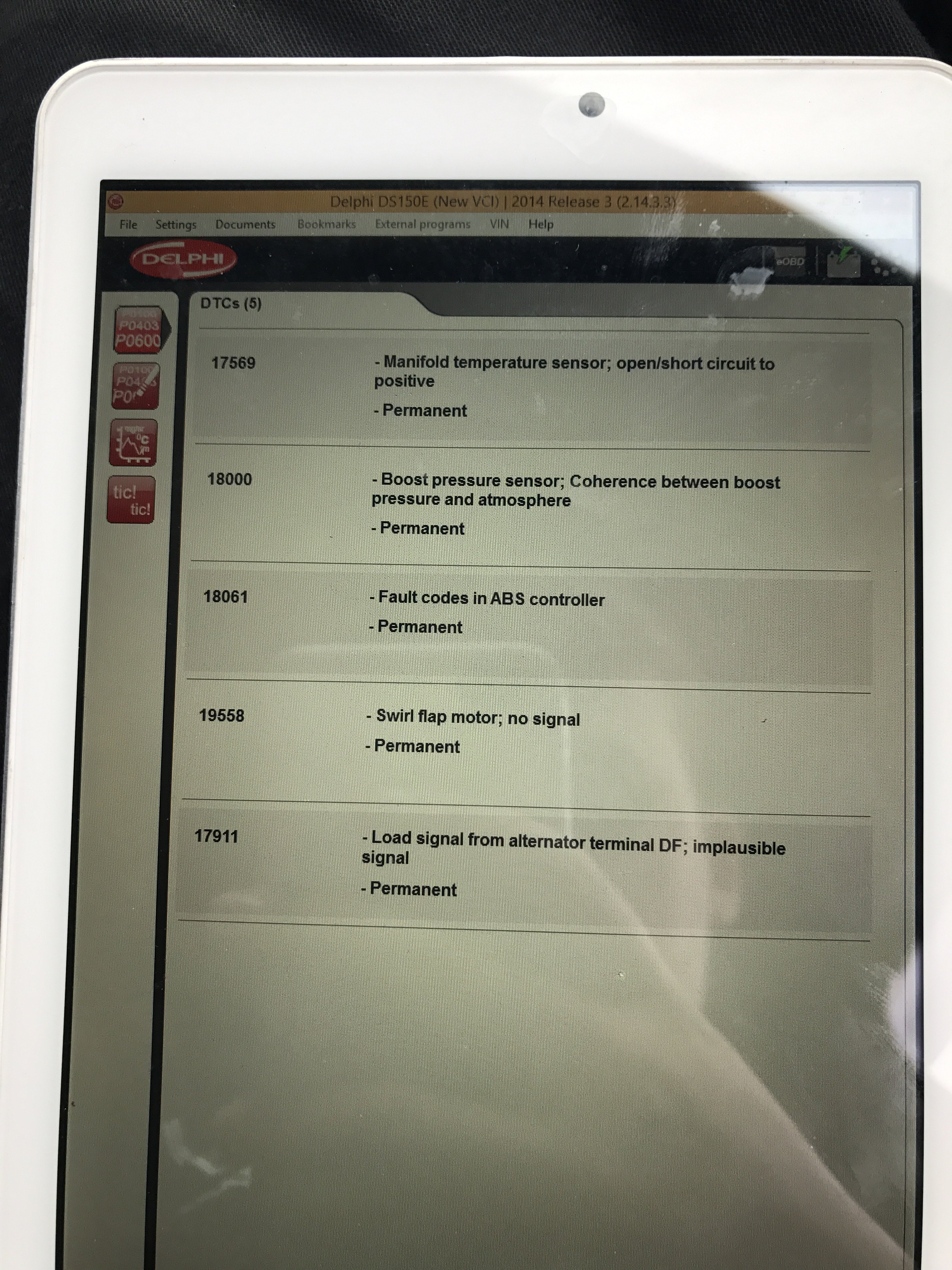

its got potential, just has its issues which need sorting, here are the fault codes and was wondering if anyone could help out,

Here is a attached photo of the fault codes and was wondering if anyone could help me out?
I think you need a better code reader! It should give you which corner the ABS fault is at for one thing.
For the others, does the battery warning light come on when you switch the ignition on? If not, then there are 2 normal weight wires coming out the alternator that you should continuity check. Correcting a break there will probably clear the #17911 fault and might also clear one or more of the others.
