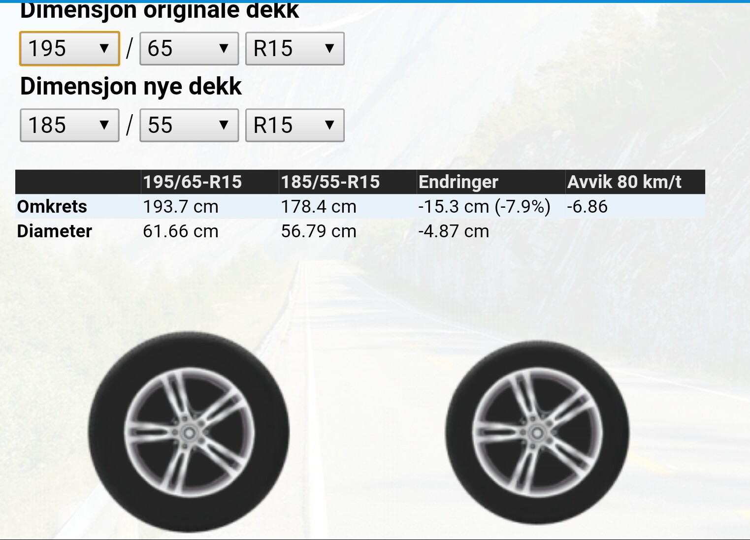

The 185/55 R15 will be too small, the other circumference are 6.7% less than the current wheels. You will get a misreading on the speedo, the wheels will spin faster in the same actual speed and the mileometer will tick faster. Related to the original 195/65 R15 the difference will be 7.9%. So that is a significant difference, I would not go for it.
