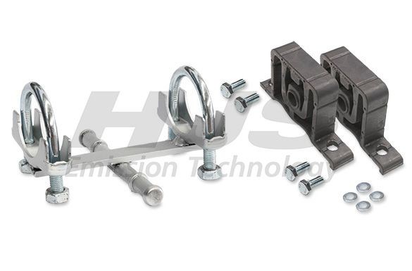

anyone having the same issue as me just done some digging a found these
thumb?id=7643604&lng=en
https://www.bestpartstore.co.uk/7643604
i could upgrade but there is nothing actually wrong with my exhaust so this will fix the issue until I decide if i'm going to upgrade.
