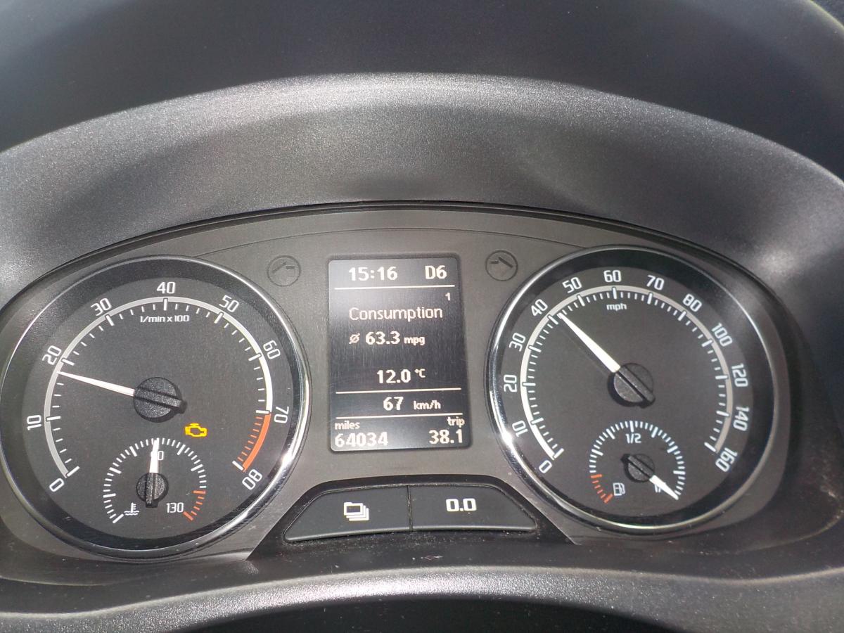

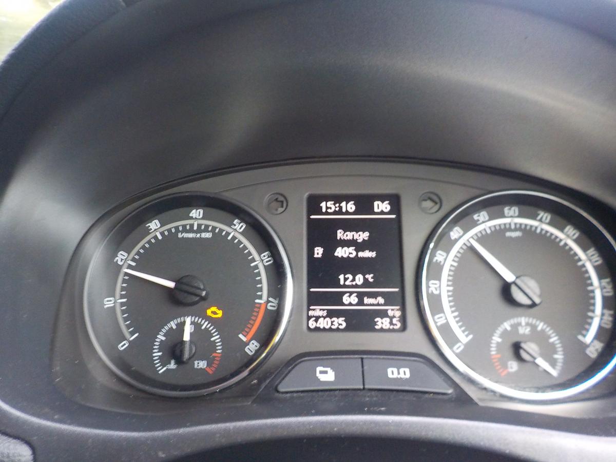

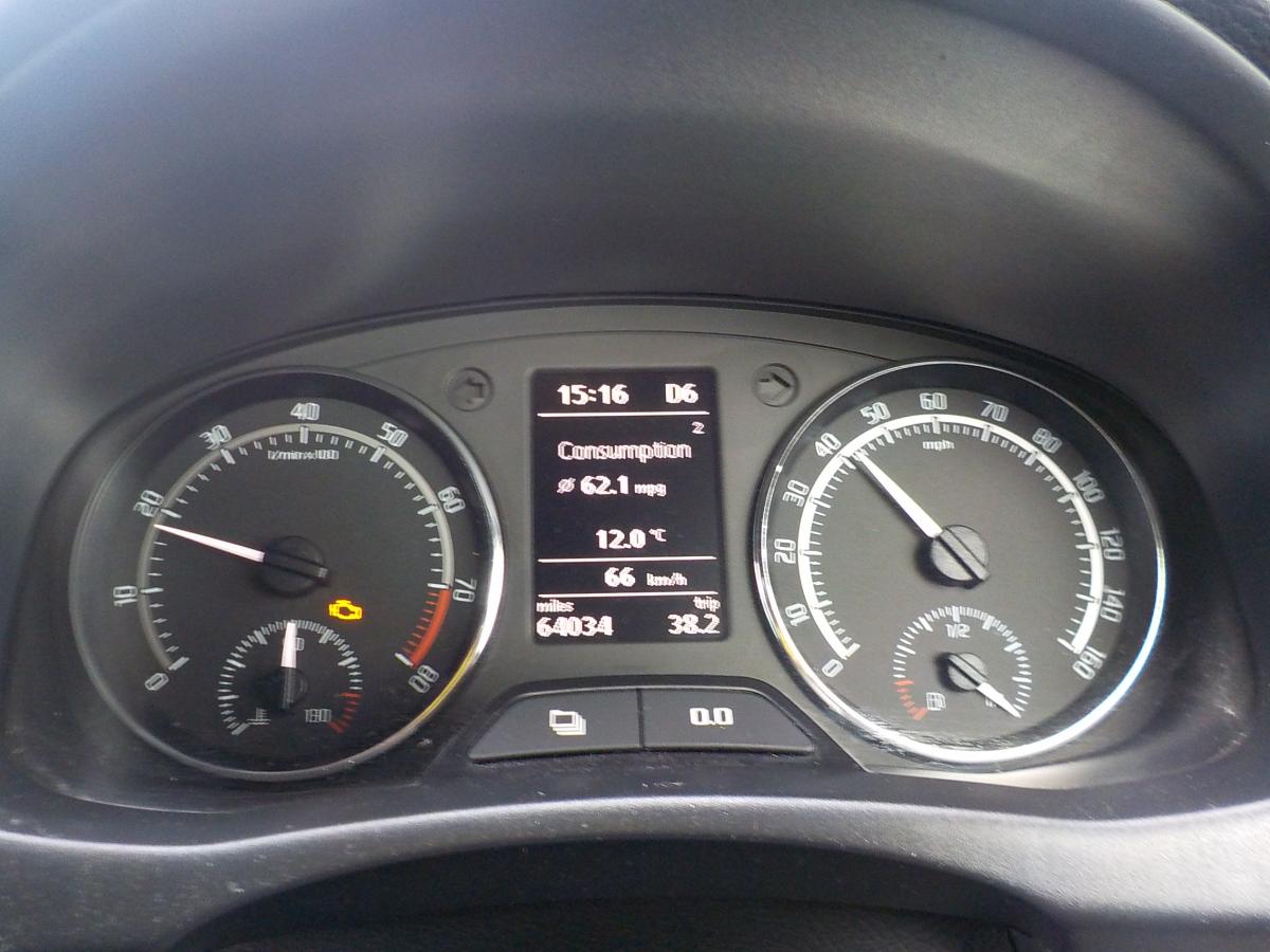

I drove one with the Super Charger not functioning because it needed the Water Pump / Supercharger Magnetic Clutch changed,
and drove easy but still at 60 mph and got the best MPG it had ever done.
Did the North Coast 500 plus another 300+ miles....

So you're driving at 40mph and taking a picture of your dash, sounds safe.
Edited by aubrey
grammer
Yes actually i was driving and took pictures, but i have a fixed camera so not holding and clicking, just clicking,
and can take pictures at 3 times that speed and have full control of a vehicle.
Is that safe enough for you?
Edited by Headinawayoffski

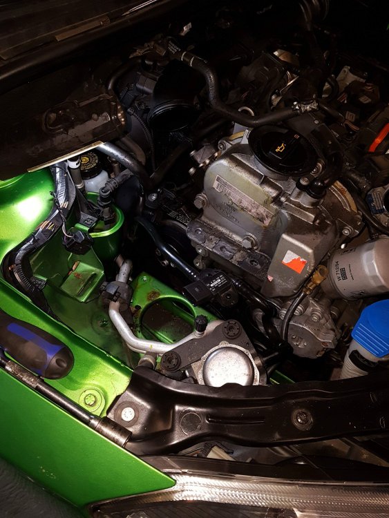

Got it sorted.
Got all the genuine bits via a friend who works at TPS, and another tech friend has fitted them.
All in all, £325 fitted including the cost of the parts.
Sounds sweet as a nut now.
Still considering selling it mind....
2 hours ago, S27VEJ said:
Got it sorted.
is there something visible on the old part that gives away the failure, ie a crack or something... Just curious as to what causes these failures?
5 hours ago, S27VEJ said:
Got it sorted.
did they need to remove any engine mounts to gain access to the area? if not do you no how they got access
Nothing obvious that I can see on the old pump but I’ll admit I haven’t had a good look so il do that tomorrow and see if I can find anything.
As for how he did it.....no ramp and took 4hrs from opening the bonnet to closing it.
