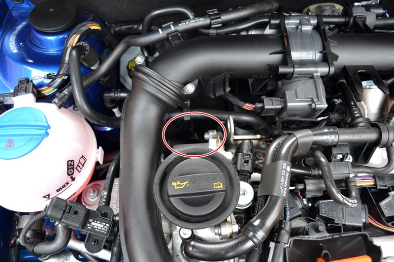

You could take the engine cover off and look at the small breather pipe next to the furthest left plug drivers side,
that can be left off or not refitted correctly, as can the Big Hard Turbo pipe not sealed when put back on,
& that was missed.
Was this a main Dealership that did it.
They might say you tampered which is an issue obviously, but if you are confident just have a look see at the pipes.
Ignore this RED Circle in this picture, i just took the picture from google images from another Briskoda thread.

I'll get a picture this morning when I can be arsed getting out of bed (it is Sunday after all) but if you remove the engine cover and cast your eye over the spark plugs, right near the spark plugs there's a torx bolt that holds the vacuum pipes down (I can't think of any other way to explain it) just to the right of that there's a pipe that goes under the air intake that may not of sealed proper, you will have to unscrew the one at the other end just under the oil cap too if you plan on doing it yourself.  That's known for not resealing.
Thanks LGM, I hope you had a nice lie in lol, it is only nutters like me are up stupid early on a Sunday morning. It was the pipe underneath the air intake!! It wasn't even attached! I did find it very difficult to put back on as the pipe didn't seem long enough to get any further on but I done it the best I could, now going out for a test drive to see if its done the job.
& that was missed.

My apologies i got side tracked, the easiest way is to remove the rubber seal and put it OVER the pipe it seals onto, then you slide the pipe over the seal and lock everything up.
The other way is to remove the first lot of the air intake, filter and pipe. You can then see everything then, it obviously takes more time but you can see and be sure it all seals proper.
