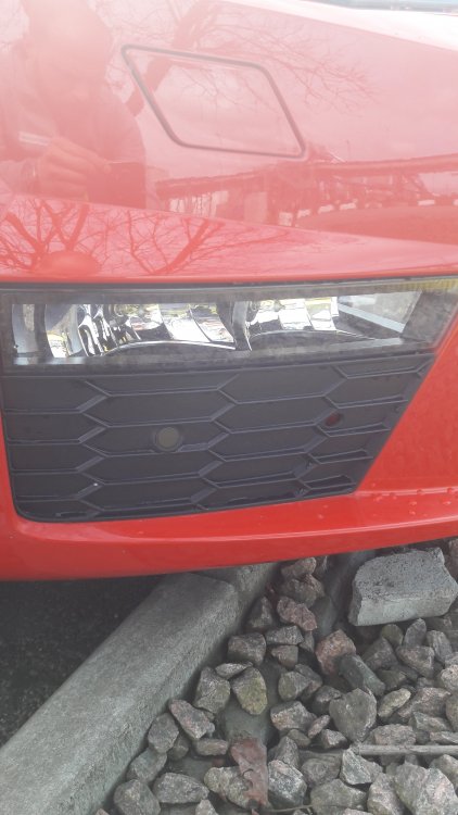

Hi all,
I want to change my foglight and curvelights to LED. I just want to know the best way to change them.
I have a Octavia vrs tsi 2014. Please se foto.

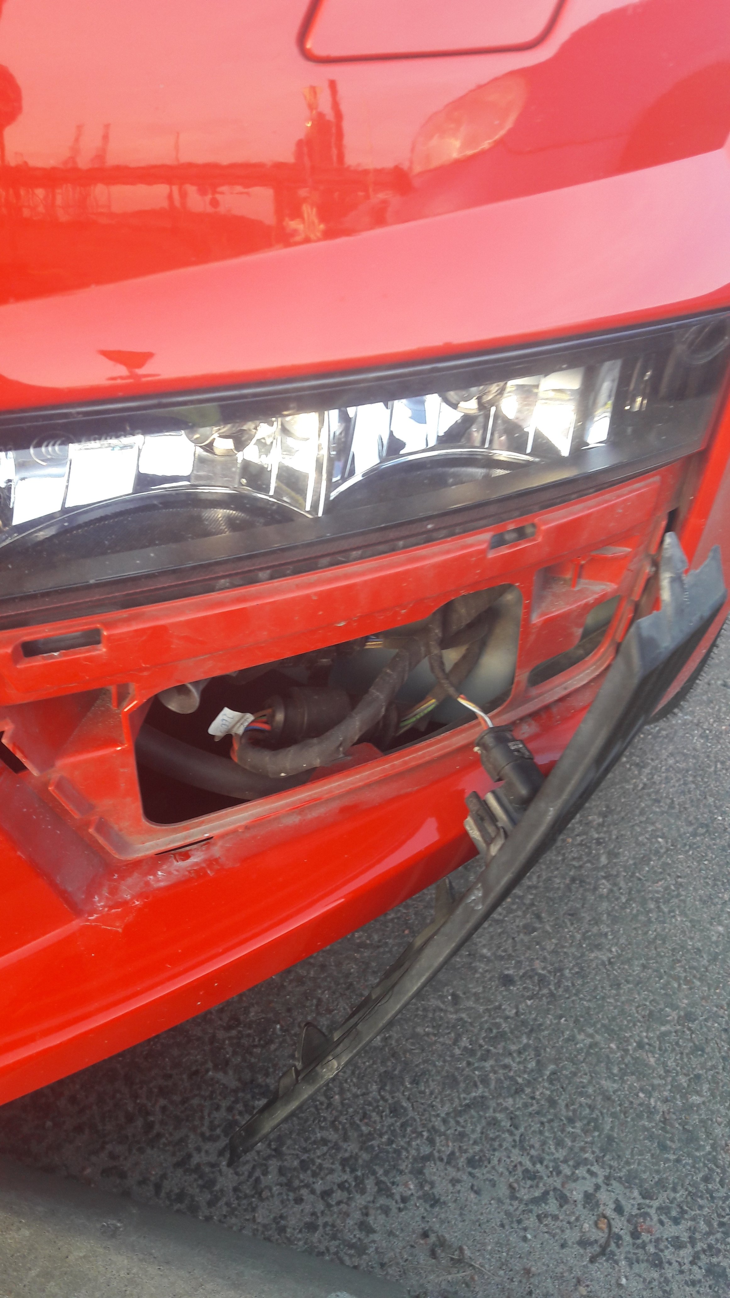

Hi,
This is how it looks on driverside. It looks like I have to go from under or upper? Or do I have till remove the front?
Put your hand through the hole and feel upwards. You should be able to feel the clips holding the bulbs in. Pop those off with a screwdriver and then you can change the bulbs.
Hi,
Thx will try! And again thanks for your time
Took me a little while to do the first side, but once I had it worked out the second side was a lot quicker.
I think th best way is to go in through the wheel arch cover or up on a ramp and remove the under tray
Loads of room and you'll leave the skin on your hands and fingers.......
Much easier with a car lift. :)
Lift it is:) Thx everyone for time and effort.
