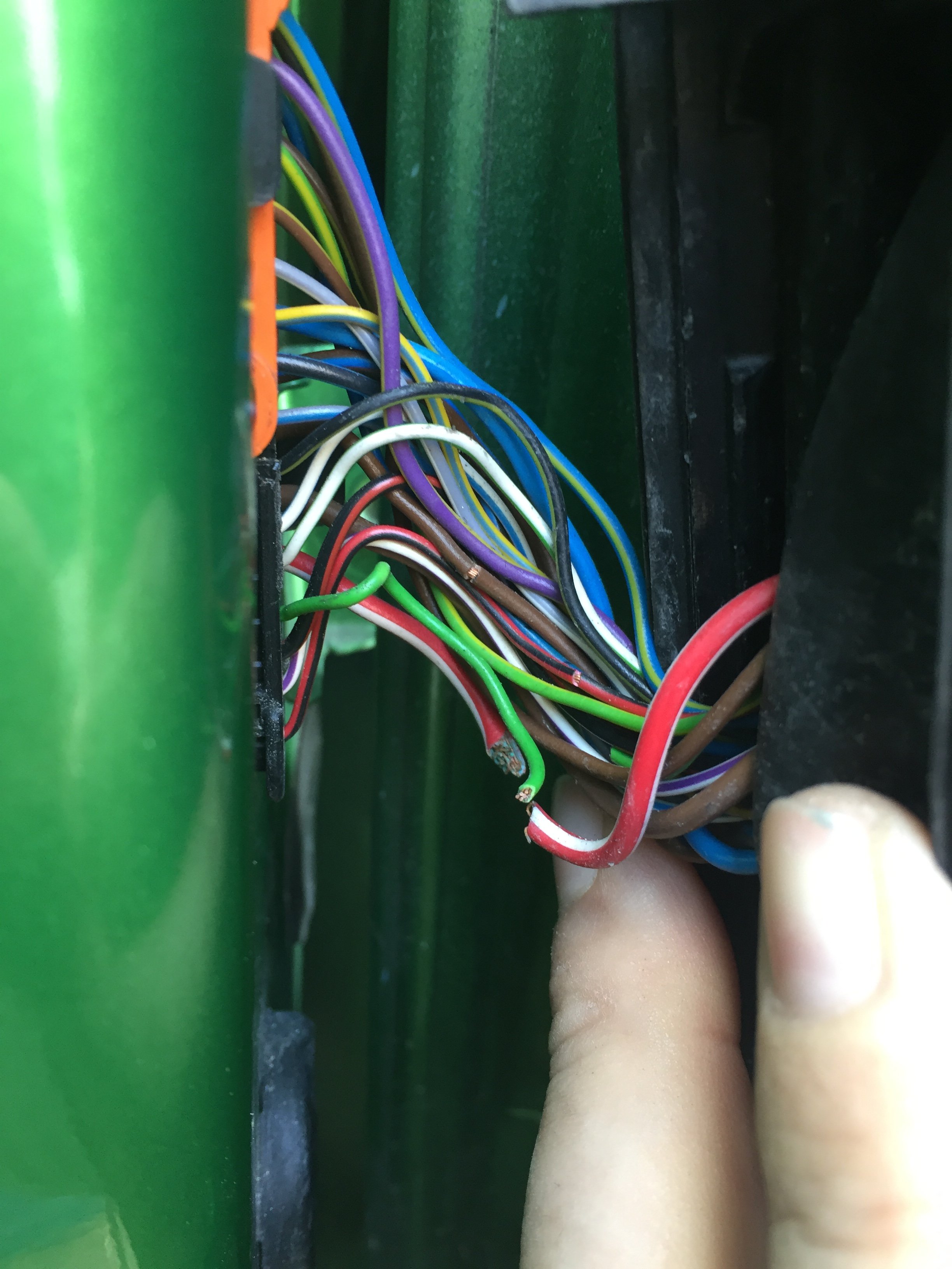

Could anyone pinpoint what the broken wires might be for?
My window switch has been acting up of late so I'm guessing that but it would be good to see if it's that before I start having a look elsewhere
They will be going to the door controller which controls the central locking, electric windows, mirror etc
Right... traced the wires back.
Window motor the red and white wire
Mirror switch for the green
The other two on there way out are for mirror switch and the alarm switch in the door.
