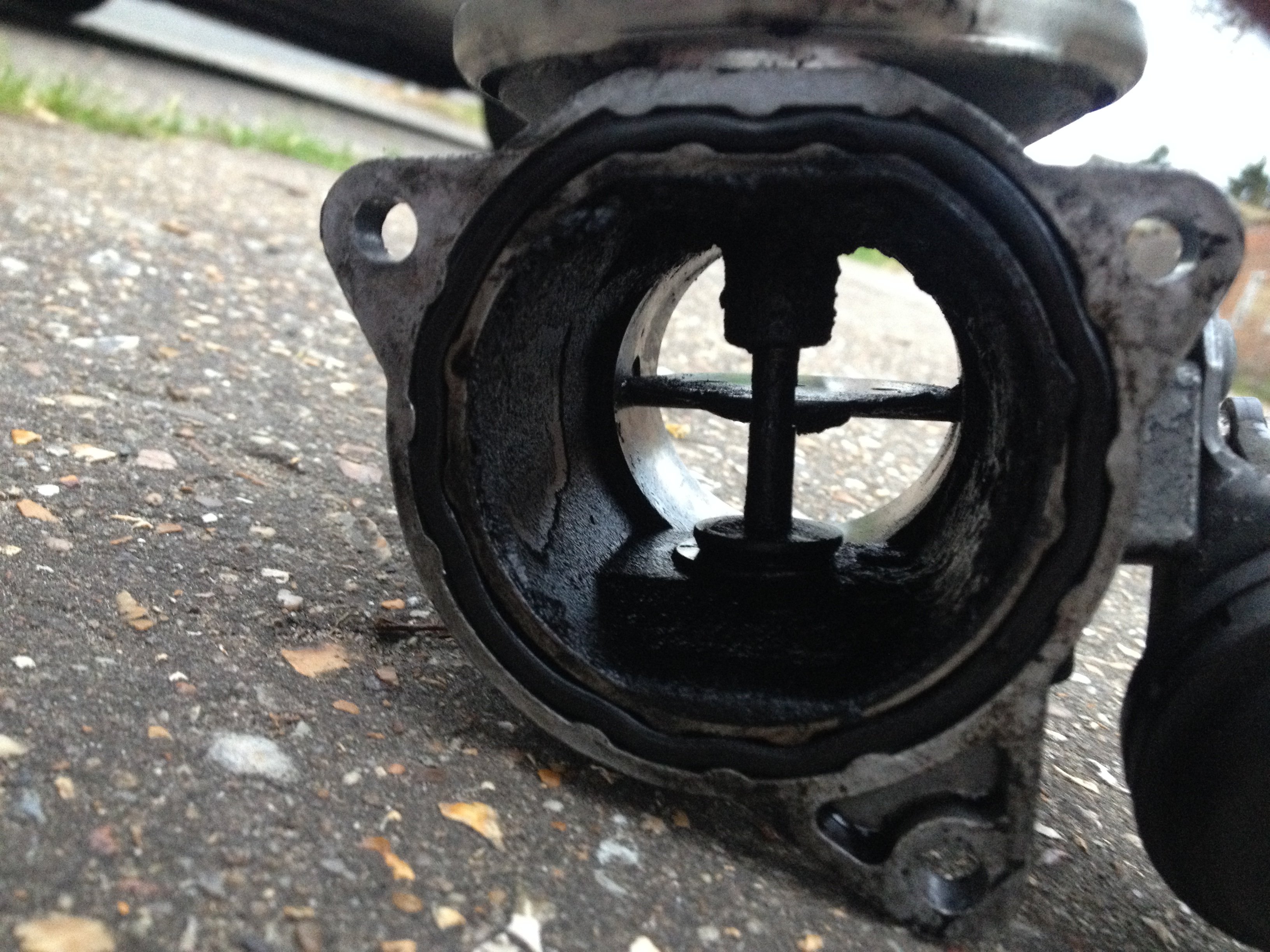

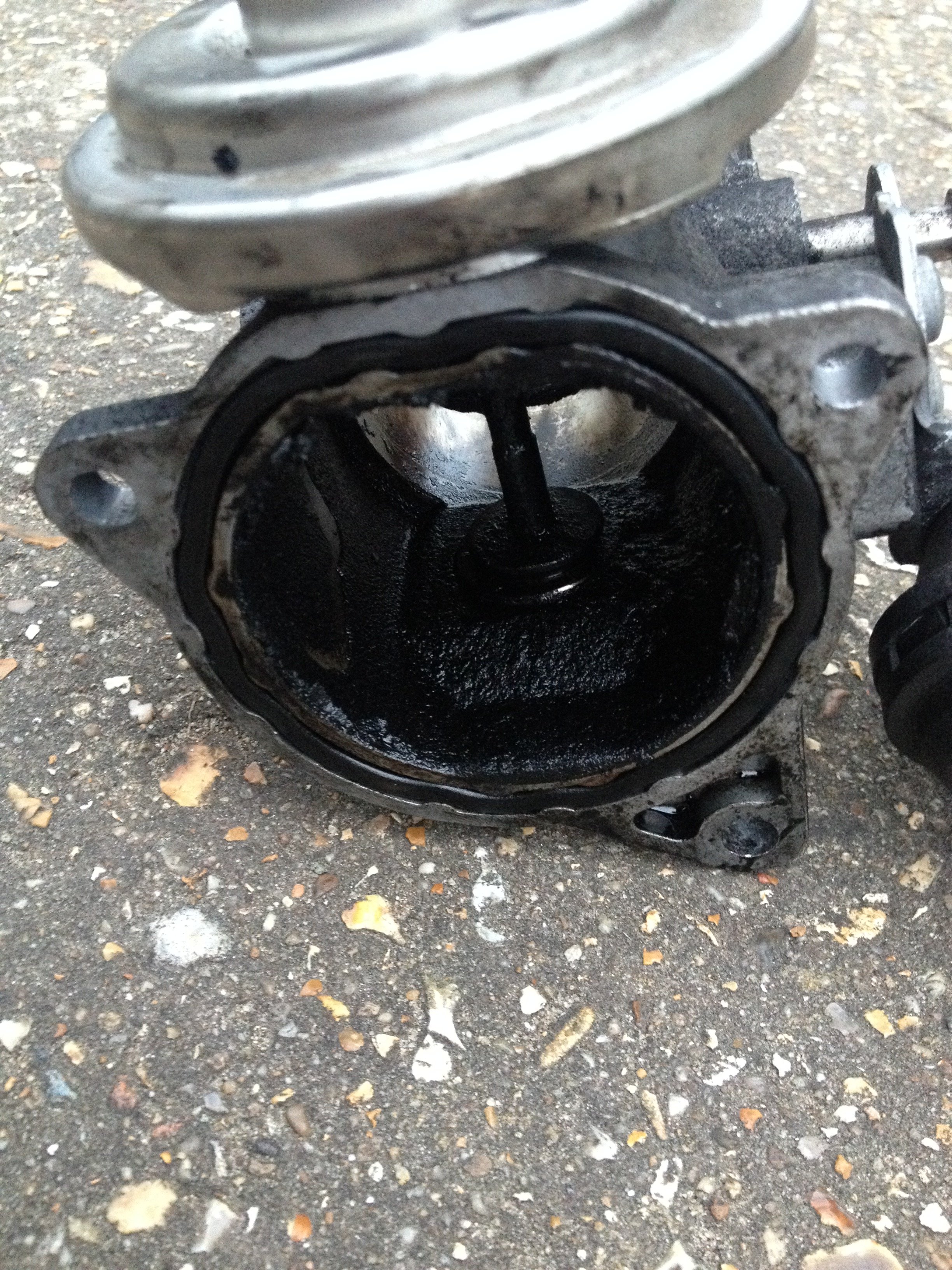

I agree. My EGR had done 179,000 miles and looked fine (see pic) A bit grubby obviously but nothing to worry about.

You think thats "fine"?
pmsl
Yep, looks fine to me.
It's fine as in it still operates as it should. The valve opens with vacuum applied and closes fully when it's released. It's not exactly like the photo you posted which show a serious amount of gunk near enough blocking it. When I consider it has done 179,000 miles I think it does look fine. It's not going to take much to clean it up and I think restriction to air flow is minimal.
Yep, totally fine.
I've seen ones with a lot more build up around the valve stem and still working perfectly.
The beauty of these valves were they were simple, had no motorised parts or electronics and a piece of cake to replace. Now they are a lot more complicated and made it a right ball ache to remove. That valve must have been an earlier type PD engine as the newer ones had a stepper motor controlled flap that would pull in to increase vacuum on the exhaust side to draw pull in more exhaust gas where as that one just has the vacuum powered anti-shudder flap.
Edited by SuperbTWM
12 minutes ago, SuperbTWM said:
Yep, totally fine.
You would be right. It's off my 1.9 PD BJB. I only removed it as part of my investigation into a fault (EGR insufficient flow). As I can't be without the car for long I had already bought a spare so replaced it anyway. I still have the fault so I'm quite sure the old valve was fully functional. I have kept it and will clean it up as a spare once I've actually solved the cause of the fault. I'm now looking at a 'new to me' vacuum solenoid or MAF sensor. I changed most of the vacuum lines, only one left to do as I mixed up my measurements and ran out of 3mm ID pipe.
