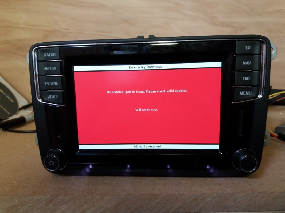

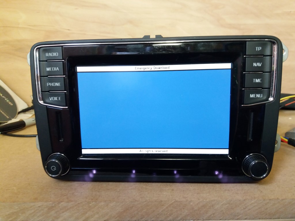

Emergency Download fault.  This fault manifests itself as either a sudden failure and shut down, a failure to read SD cards and switching randomly to the radio, or any other such means. This then causes the unit to boot up briefly with a blue screen and a message saying Emergency Download for a few seconds,
Then jumps to a red screen and a message saying "No Suitable Update Found. Please Insert Valid Update. Will Reset Now"
And then shuts down before restarting and repeating the same procedure.

The Amundsen unit in the picture above has no cd drive so it can't be updated via cd.
I've found people with this fault gone to VW / Skoda and had the unit replaced, so I'm not sure main dealers have the capability to recover them when they fail like this.
